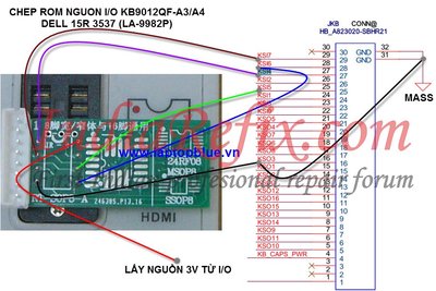

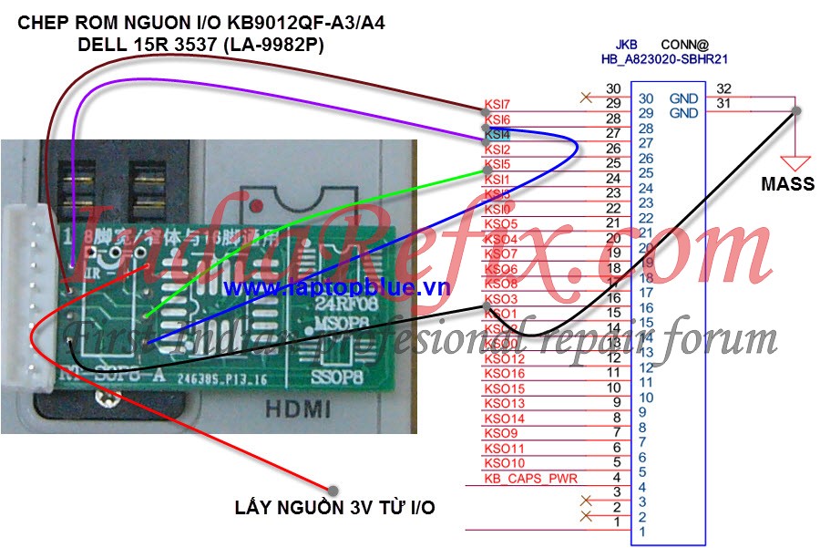

Dell 15R KB9012QF-A3orA4 ReProgram

manikodai wrote:k thanks jii
i must to try then where to buy this device
its a very usefull guide
its RT809F programmer
