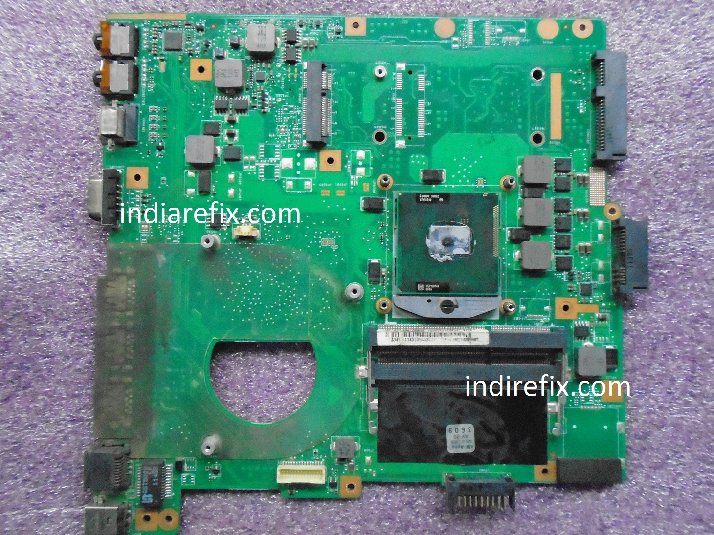

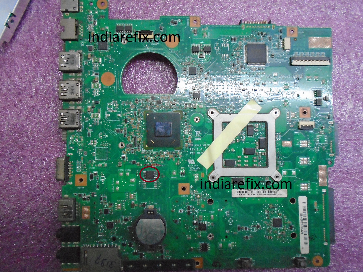

Make/Model- HCL Me L1044
Motherboard Part No- A34A Rev-2.0
[hidden]Processor Type- 2nd Gen
Ram Type –DDR3
Problem –No Display
Diagnosis- Bios Program currept
Process-
Check Voltage Charging Is Ok StepDown Voltage Is ok Ram Volatge-1.5v ok Processor Voltage ok PCH (BD82HM65) Overheat Reprogram Bios (MX25L3206E) after Reprogram Bios PCH Overheating Off then check display coming and work fine laptop …[/hidden]
