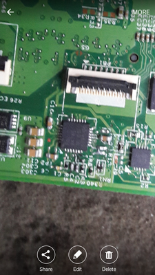

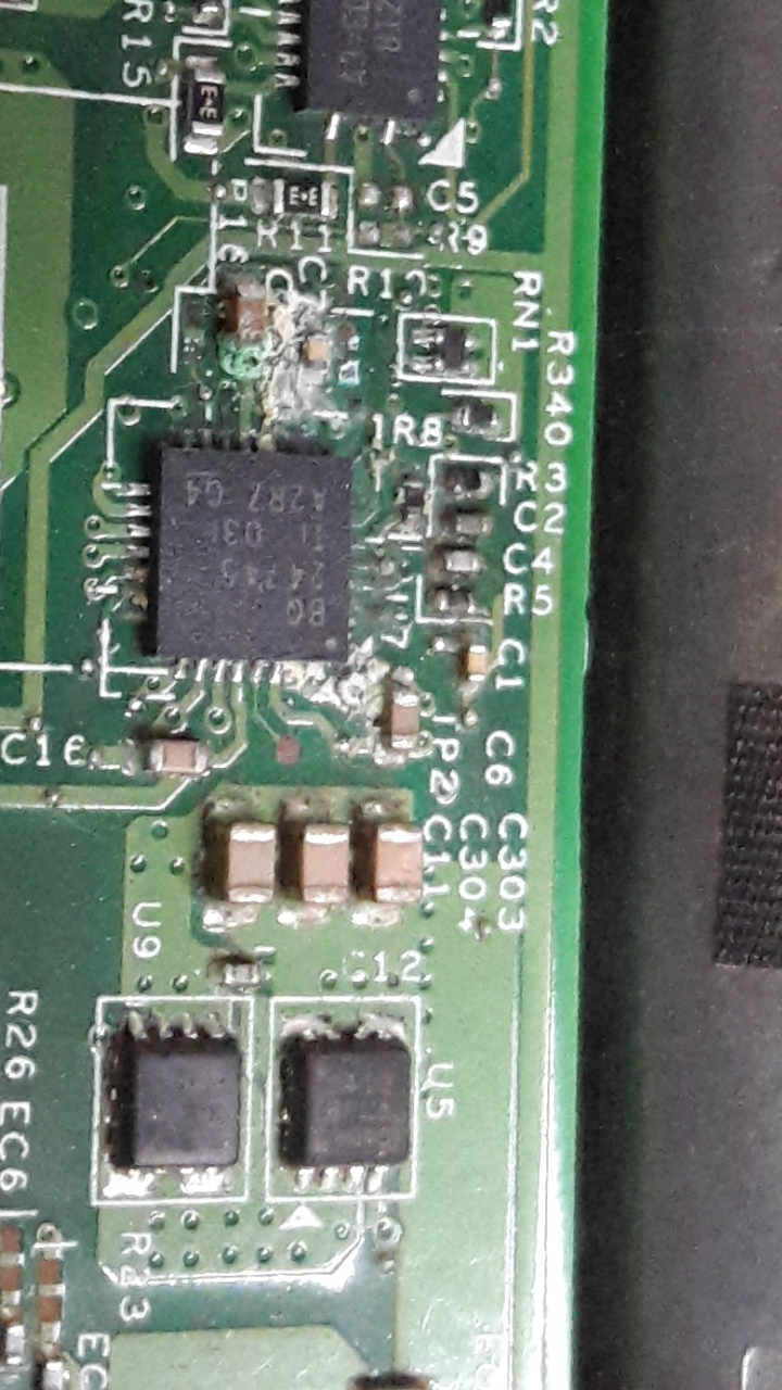

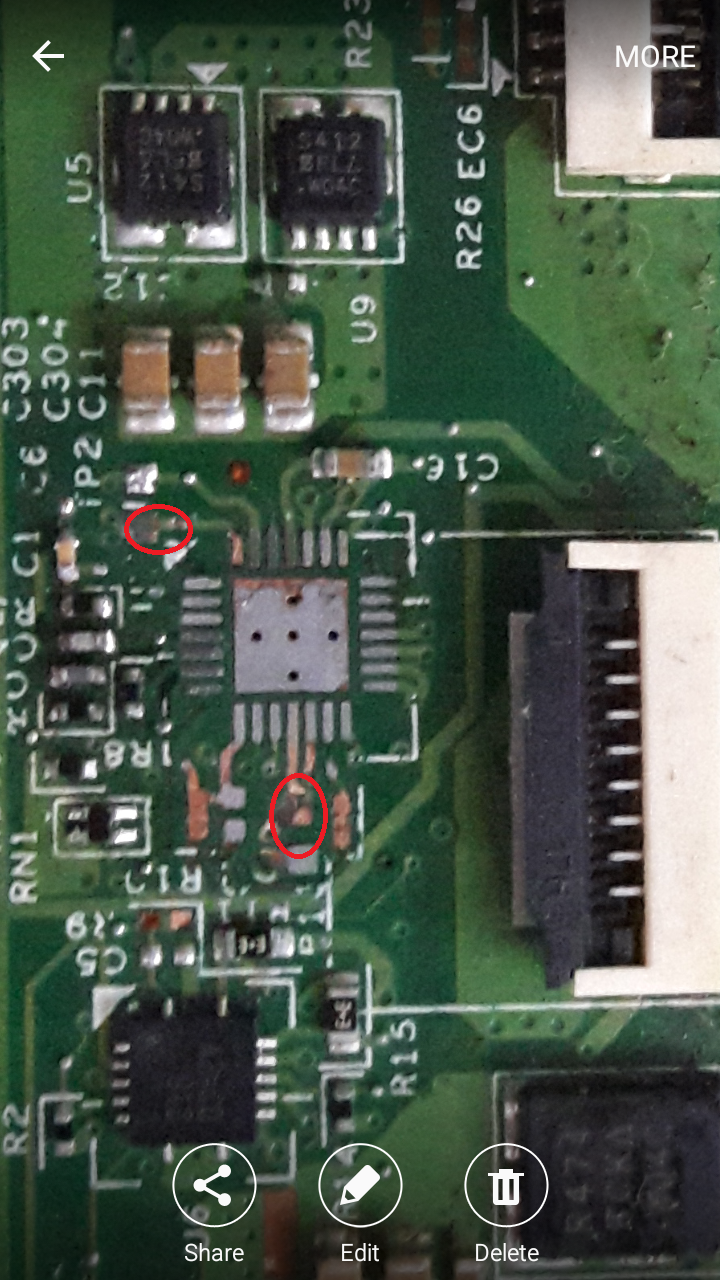

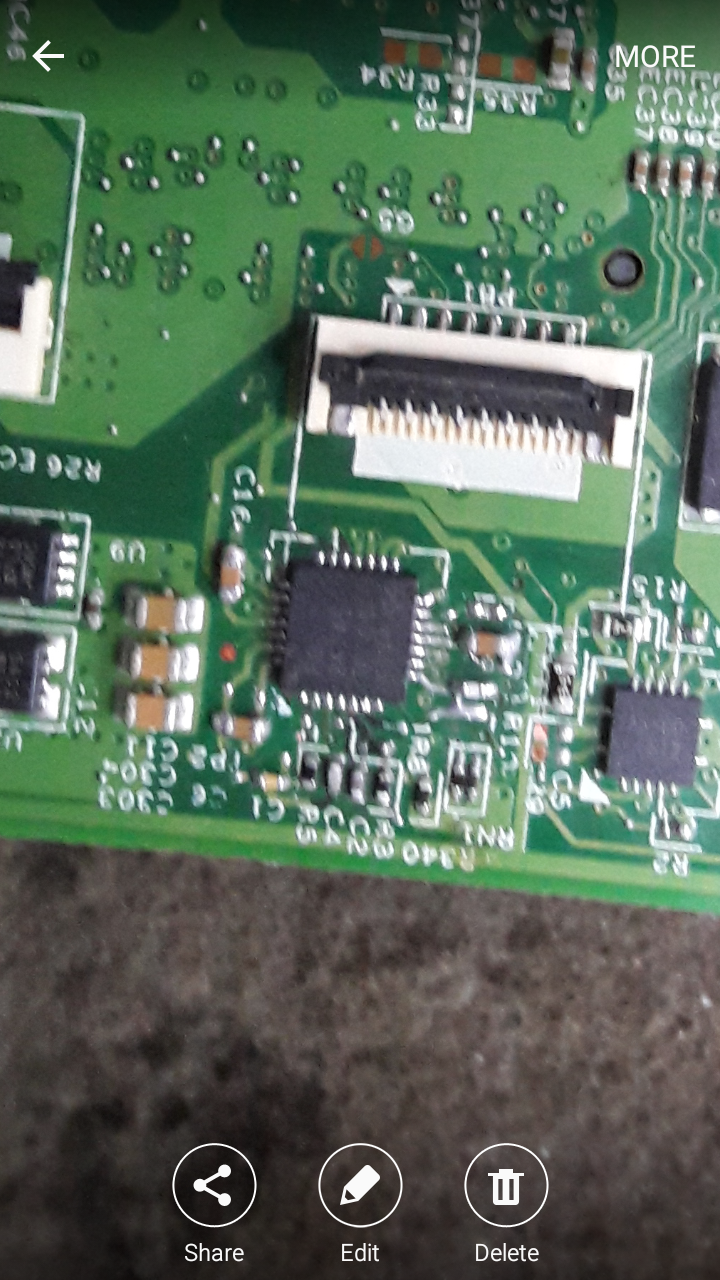

Received lenovo b460 not charging board part no is[glow=red]la46[/glow]
found liquid split near charging ic two tracks open
rebuild track ...two caps bad...replace caps
system is fine now[/img]
