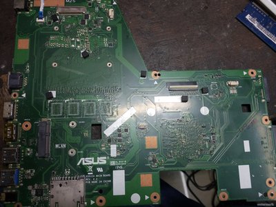

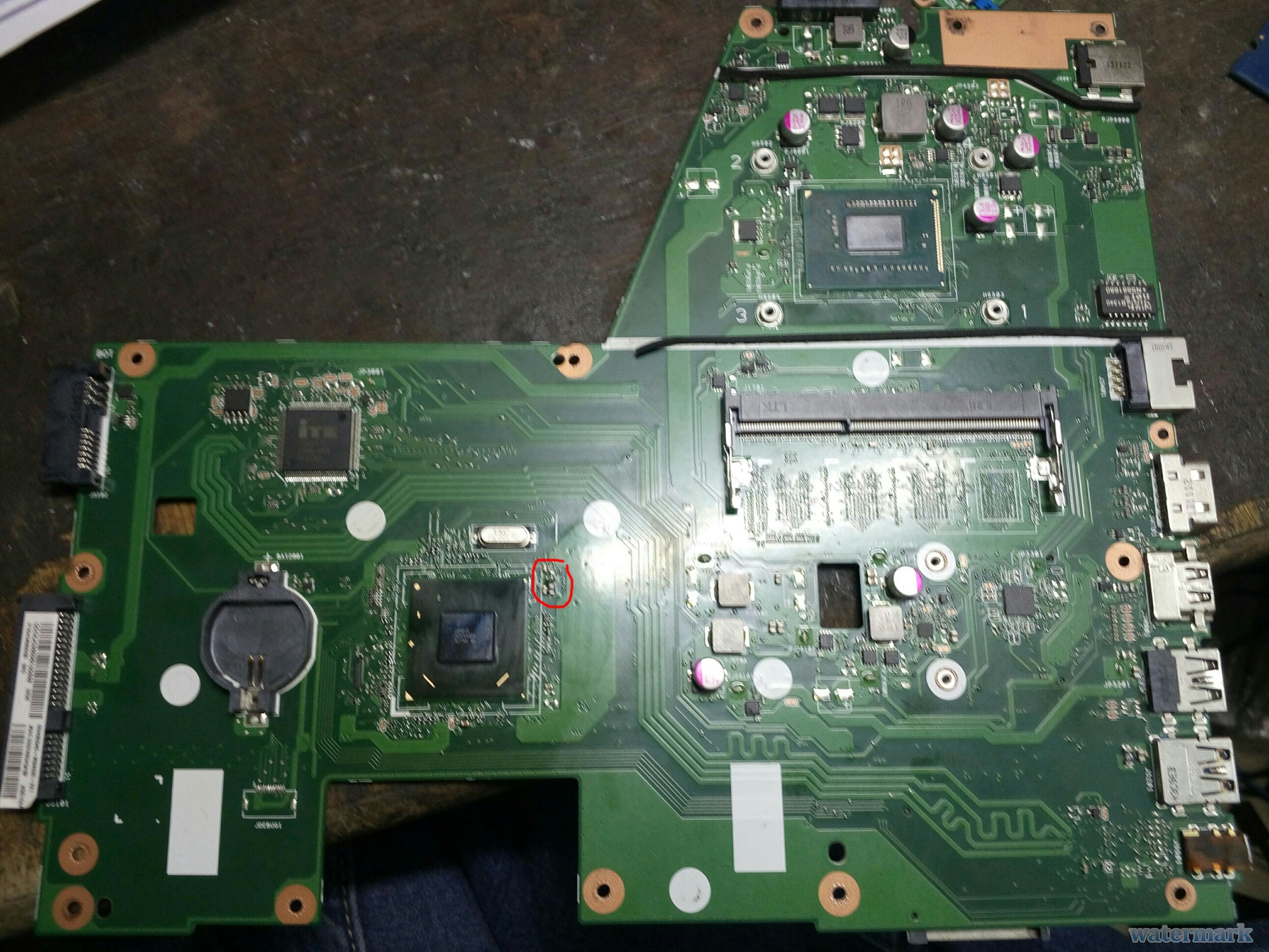

MODEL X551CA
PART NO-X551CA
PCH-SJTNV
CPU-SR109
I/O -ITE IT8517E
PROBLEM POWER ON BUT NO DISPLAY (AMP 1.06)
FIND SOME COMPONENT MISSING (SOMEONE TAMPERED)NEAR PCH
(SEE IN IMAGE) JUST PUT JUMPER WIRE ... BUT AFTER THAT ALSO NO DISPLAY DONE BIOS NOW ITS RUNNING FINE
