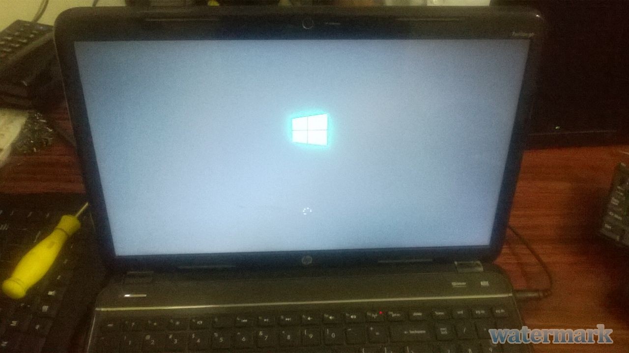

Case Study
Make/Model- HP 2000 series
Motherboard Part No- Quanta R33H
Processor Type- On board CPU
Ram Type – DDR III
Problem – Power trips in 1 Sec
Diagnosis- Corrosion Found
Process-
Laptop trips power in 1 second ….found full corrosion on I /o controller …
Removed the component ….cleaned the tracks and laid the I/ O back …
And Job Done…
