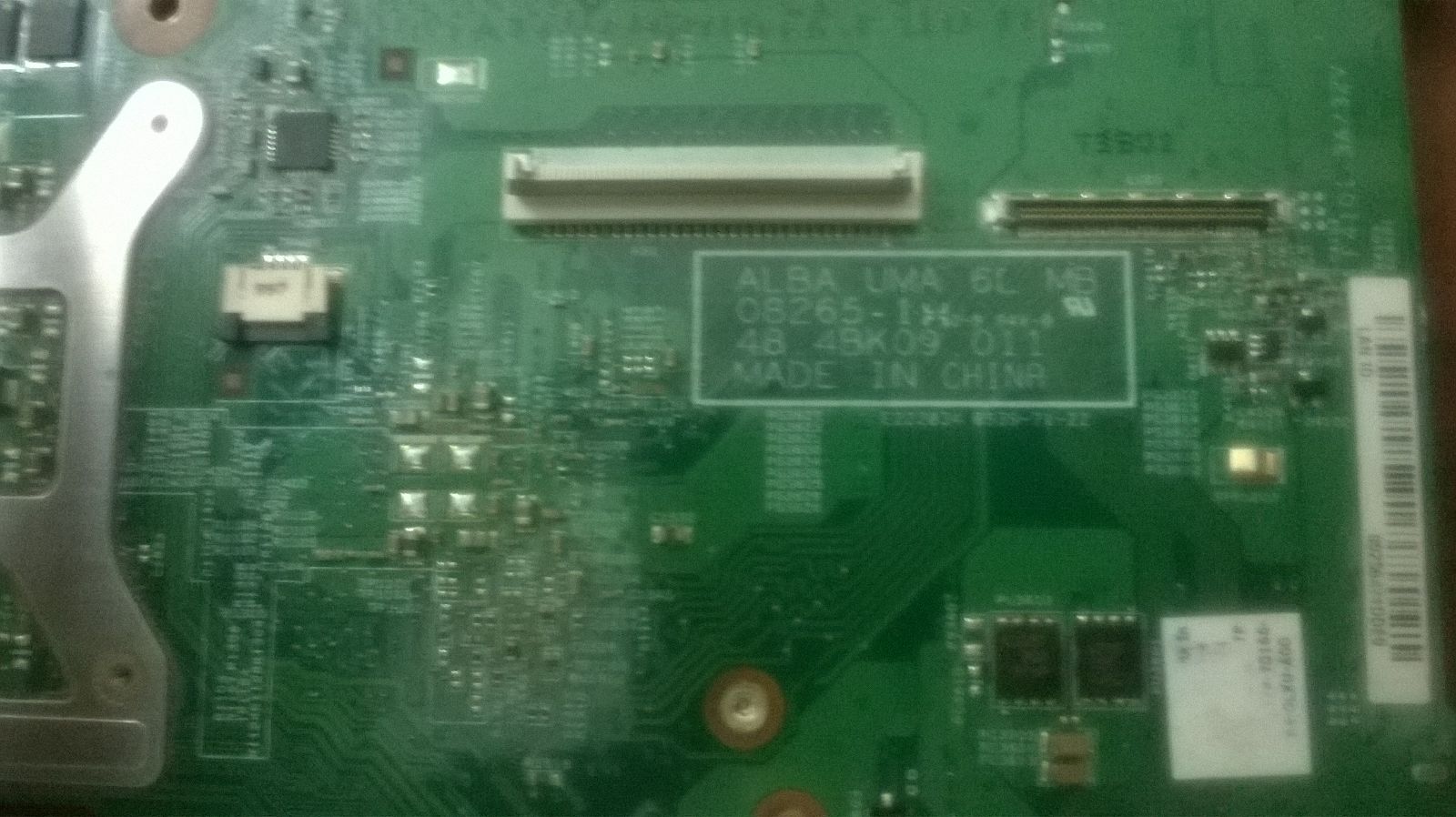

Dell studio 1440 Case Study ...

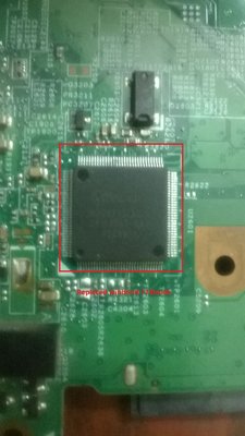

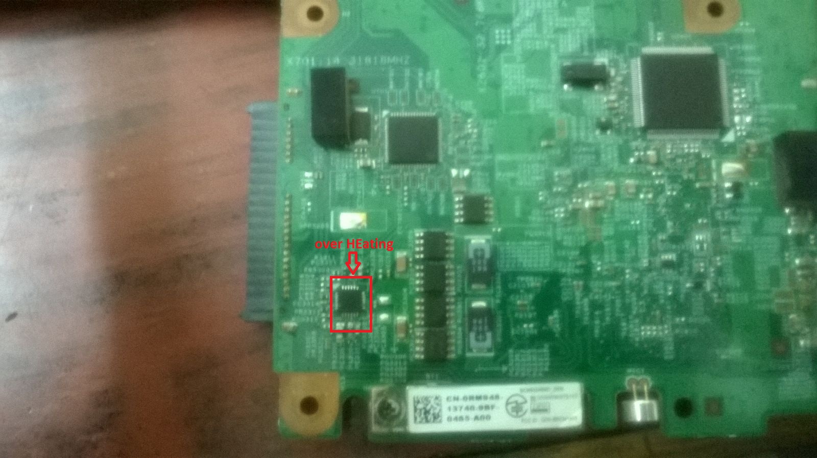

No power ....as sooon as plugged in psu goes up to 0.26amps
Found TPS51125 Over heating...

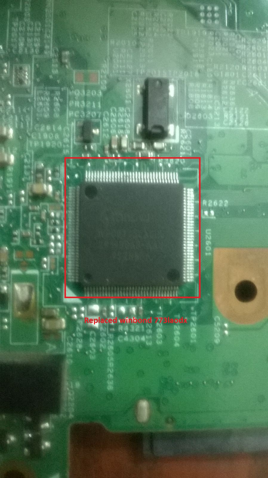

Found I/O Controller Short (winbond 773laodx)
Replaced ...
LAptop working fine
her are the pics
