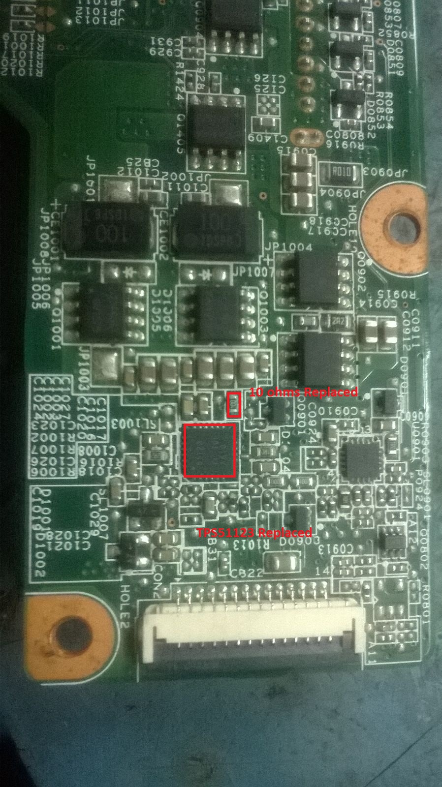

here is the case study for HP630
LAptop with no power
Found No 3.3/ 5 V regenerating
Missing 19V to TPs51123
REpalced Resistor 10 ohms ...
supply ok to ic but heating up ...
Replaced TPS 511123 ...
Everything ok
Job done here is the pic
