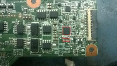

LAptop arrives in dead condition

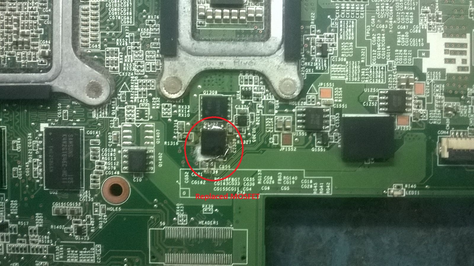

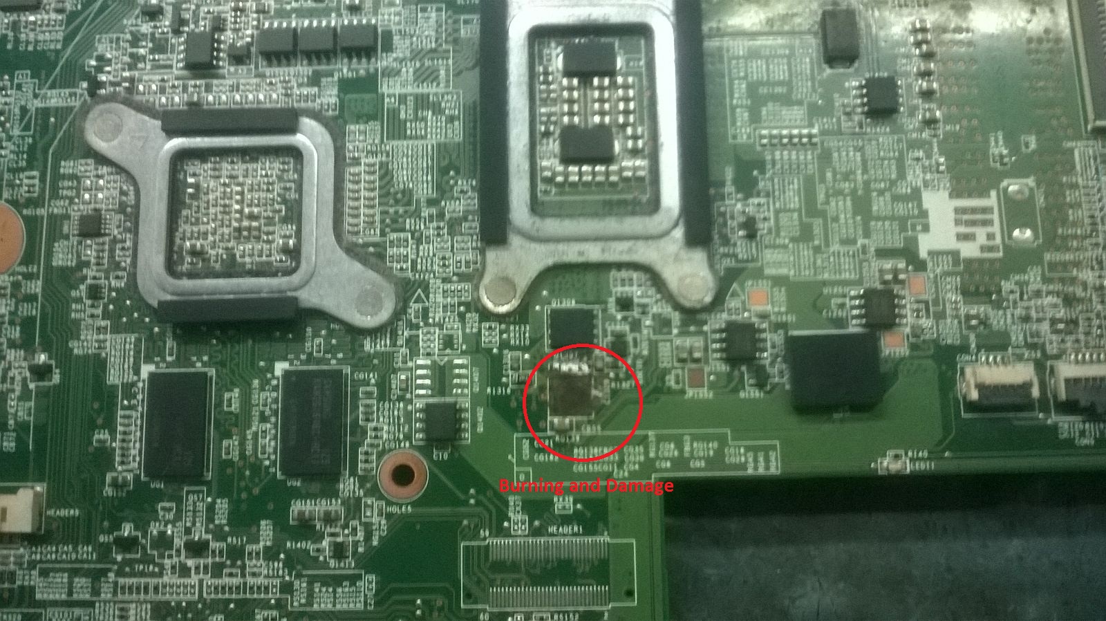

Found burning OF mosfet Q1307 ... and Track ....
Removed and Replaced laid the track ...

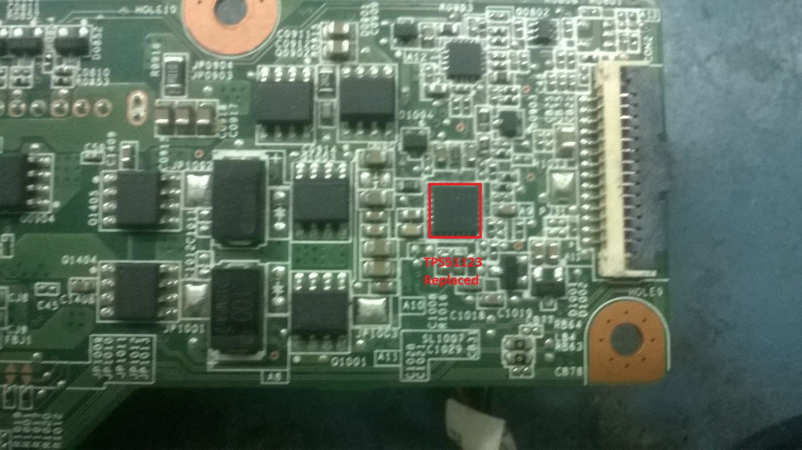

Then 3.3/%V Regulator over heating(TPS51123)
Replaced and LAptop Working fine now
here are the pics
