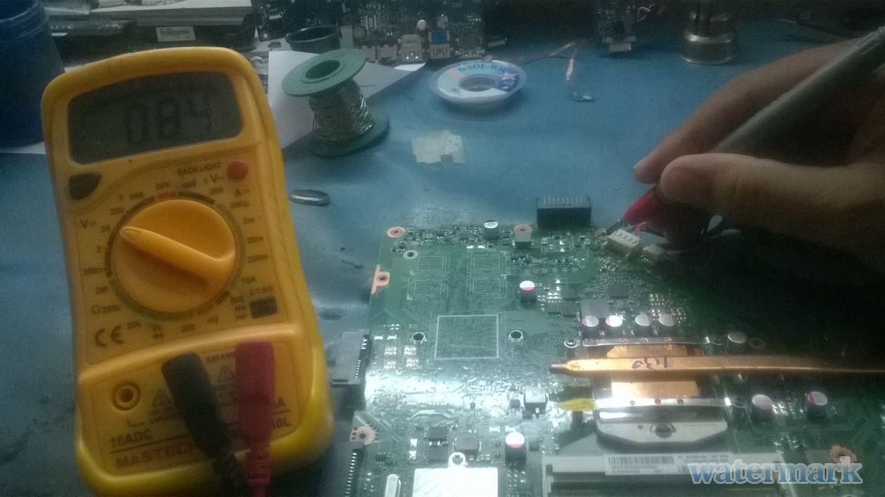

Laptop gives display with battery but with adaptor doesn’t power on
Measured voltage at the output of the mosfets..
Found it 0.84 ….
Checked the impedence between source and gate of secondary mostfet
Found it 24 ohms …
Replace the mosfet
And job done ..
