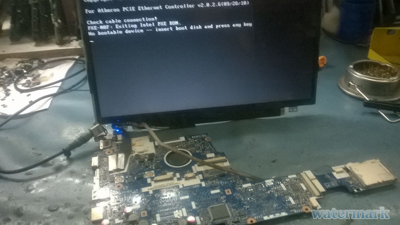

Make/Model- Acer Aspire One 722(mini)
Motherboard Part No- compal LA-7071p
Processor Type- AMD
Ram Type – DDR3
Problem –External Display ok no display ok Screen
Diagnosis-Corrosion on LVDS connector
Process-
Laptop comes with external display ok but no internal display on screen
On Physical verification verified that ..the LVDS connector is totatlly corrated
So removed the Connector and replaced with another one
Job done
Here is the pic
