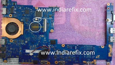

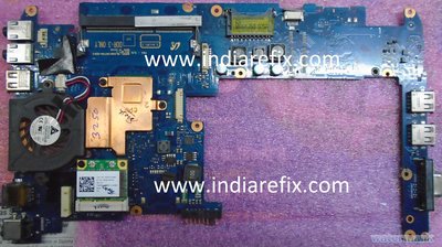

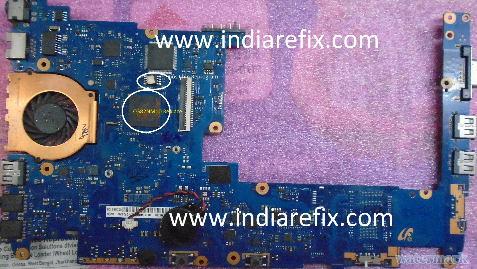

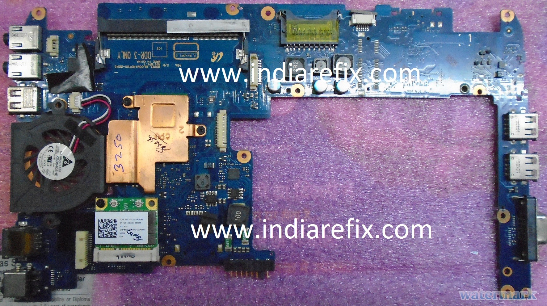

Make/Model: Samsung N145 Plus
Motherboard Part No: BLOOMINGTON-DDR3 Rev: MP1.1
Processor Type: Atom Onboard
Ram Type: DDR3
Problem: Dead
Diagnosis: Bios Chip Faulty and Chipset (CG82NM10)
Process:
Samsung Mini laptop model N145 Plus Power not on open laptop and found motherboard BLOOMINGTON-DDR3 Rev: MP1.1 this motherboard generate Charging voltage and Step-down voltage but motherboard not on when pressing on button chipset is overheating but motherboard not on, after replace chipset overheating out and motherboard on but no display, then checking voltage (Ram Voltage, Processor Voltage) is proper, when reprogram bios motherboard coming display and work proper ………
