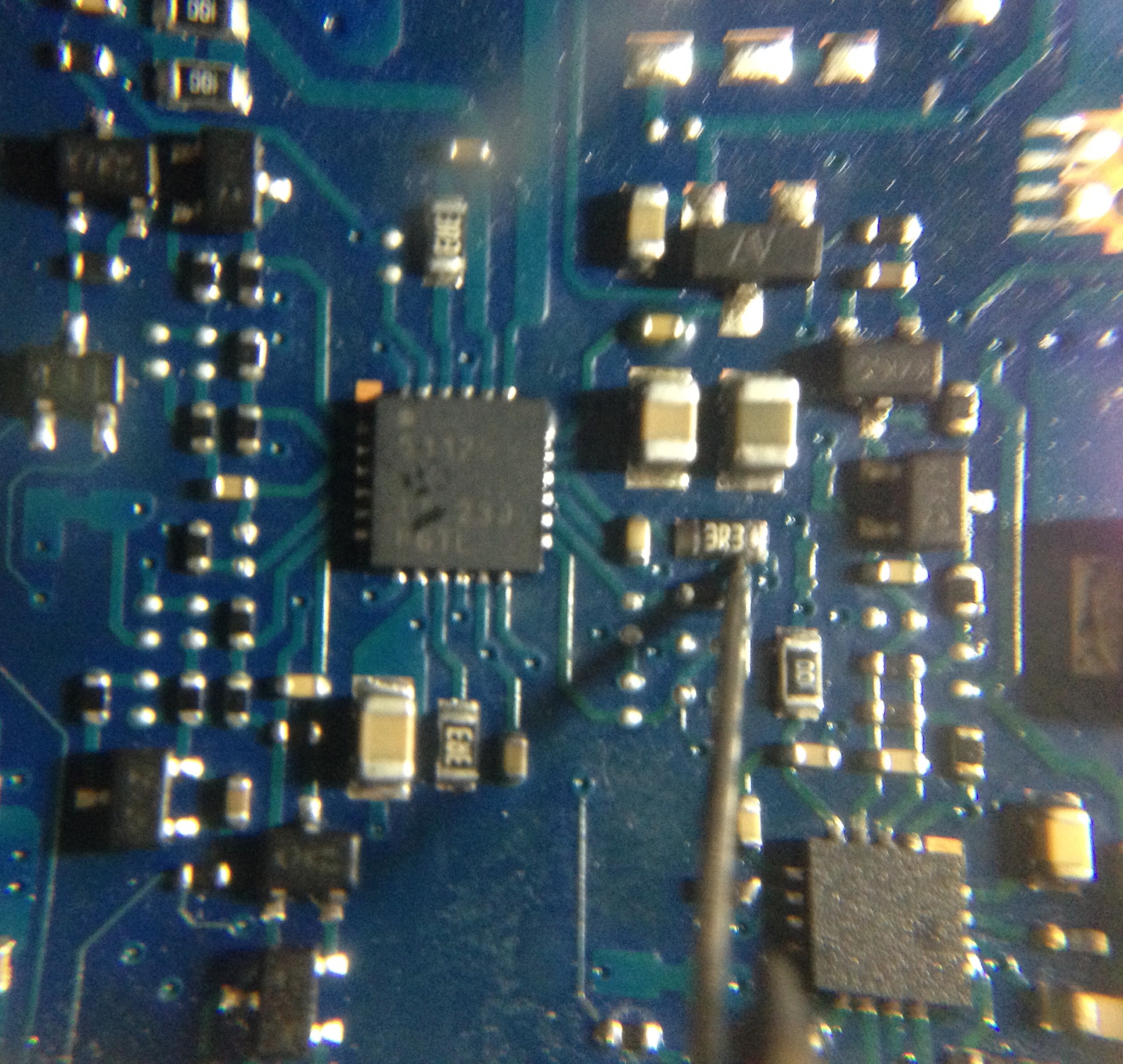

Samsung NP-500 No sign of life

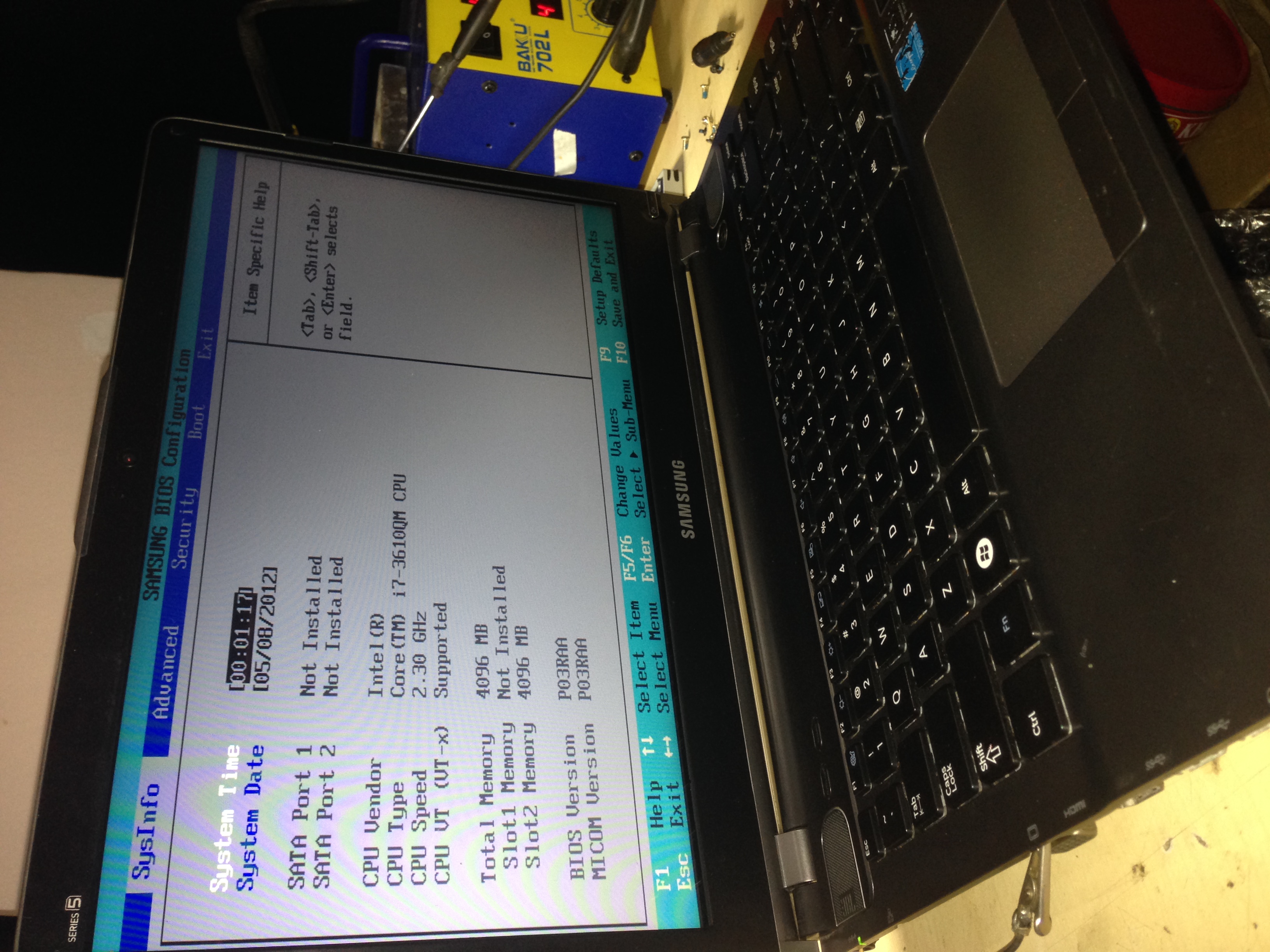

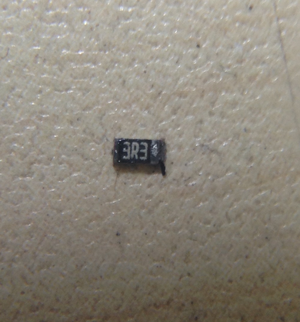

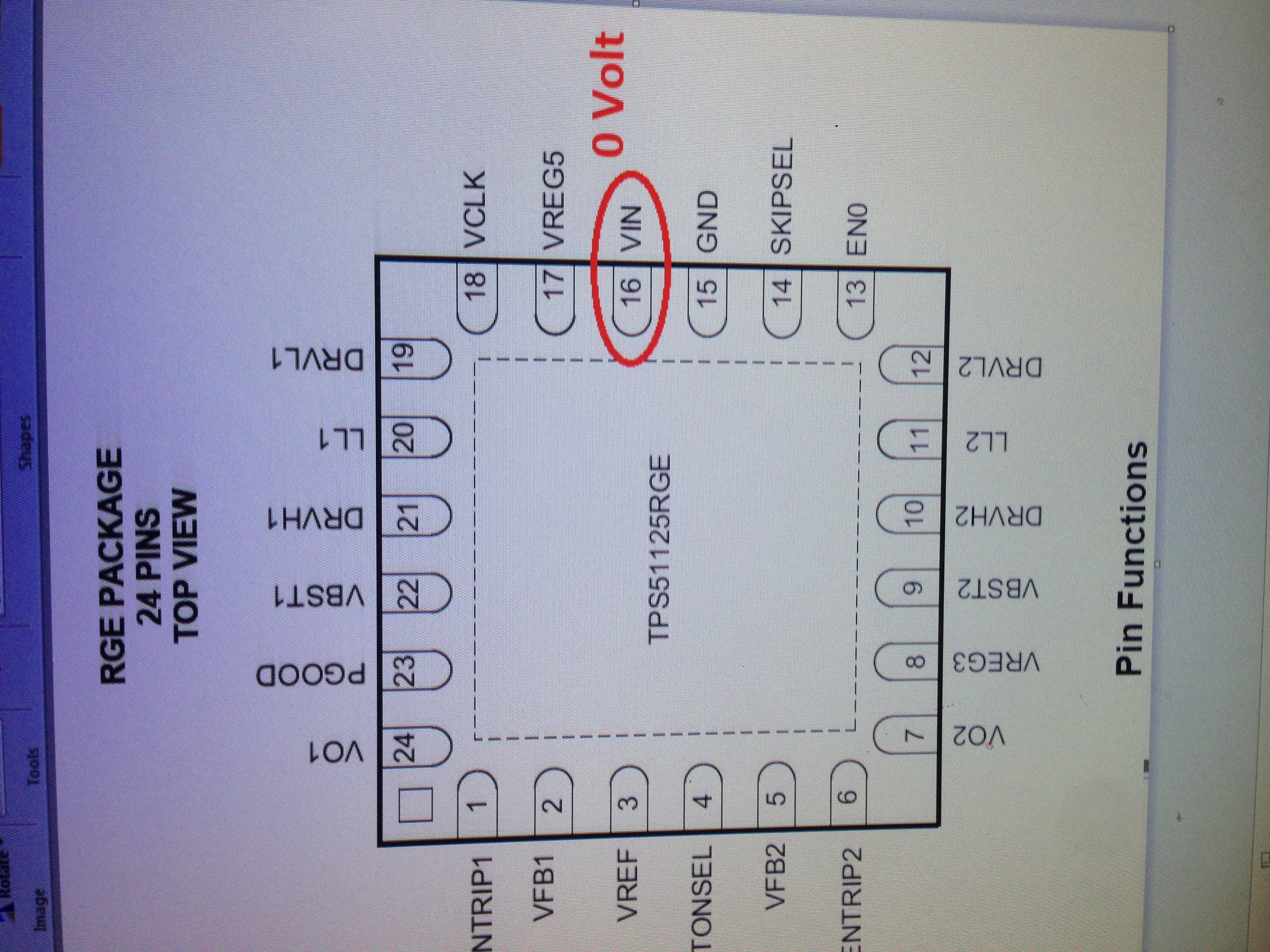

Done ! By replace TPS51125 and R 3.3 Ohm ( Vin at pin 16 of TPS51125 only 0v instead 19v )
Samsung NP500 , No sign of life

Re: Samsung NP500 , No sign of life
Nice work man
nice good job
nice job same here solved
