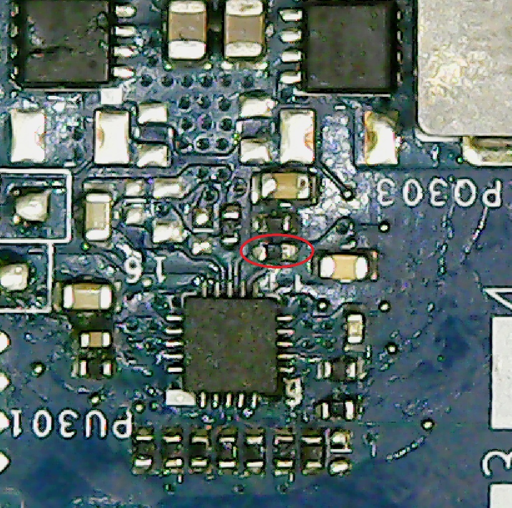

Problem : No charger Indication and not turning on
Checked 19V line Ok
+3Vl Missing
Checked ENLDO Not Present
499k Resister open
Replaced Resister
Laptop Turned On Display Ok
