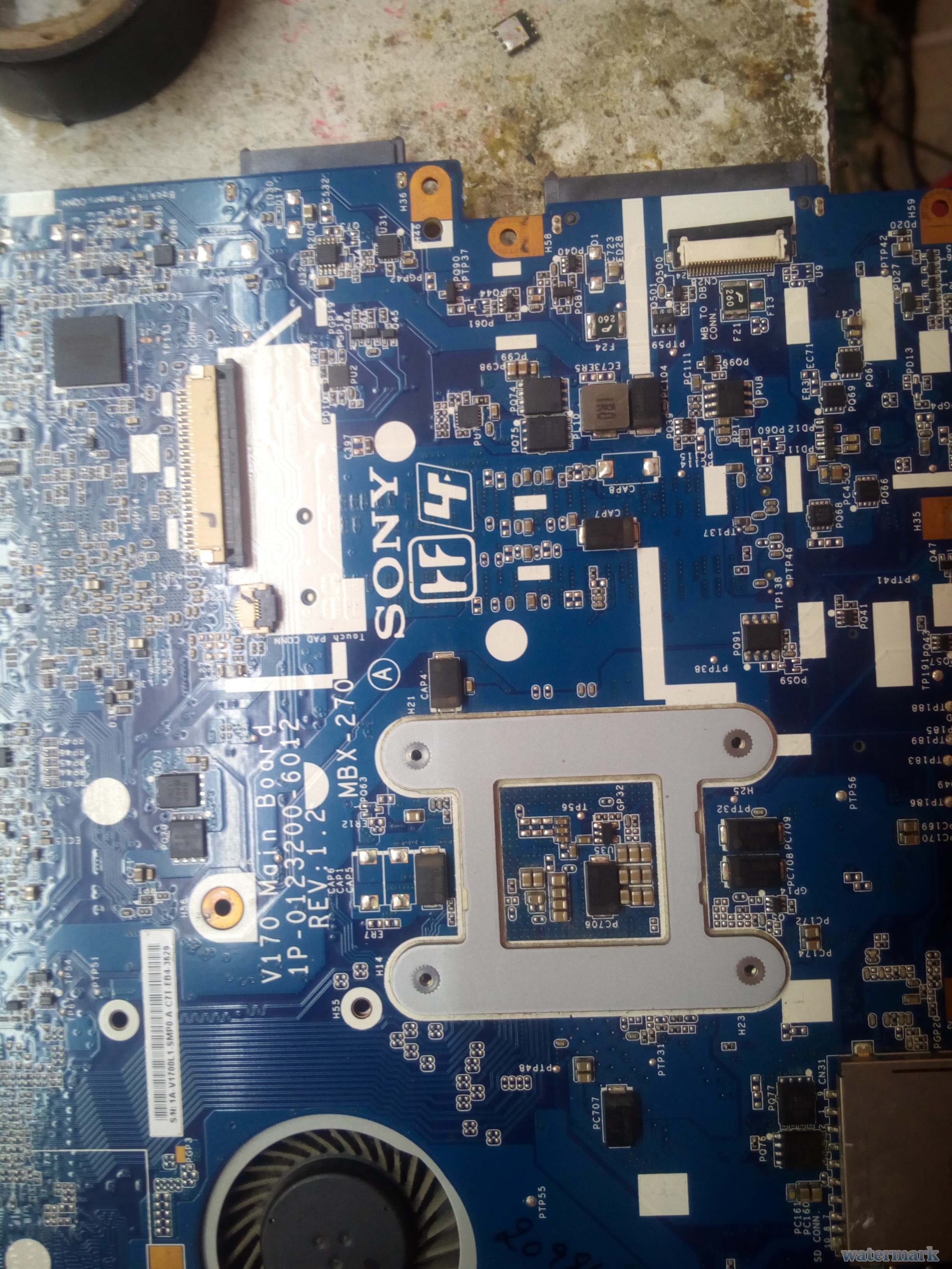

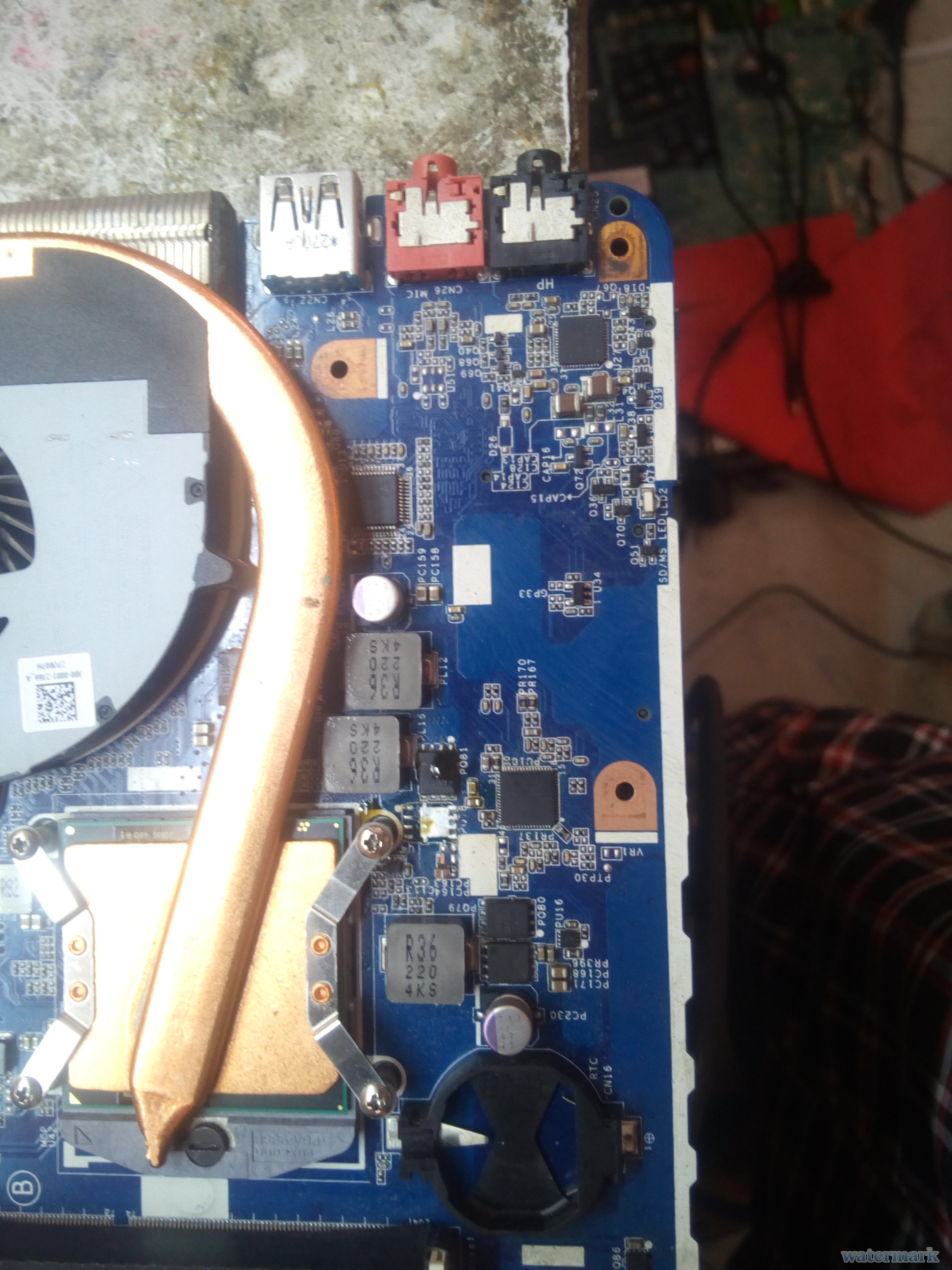

today got a mb mbx-270 which is unepaired by some try to figure out shorting

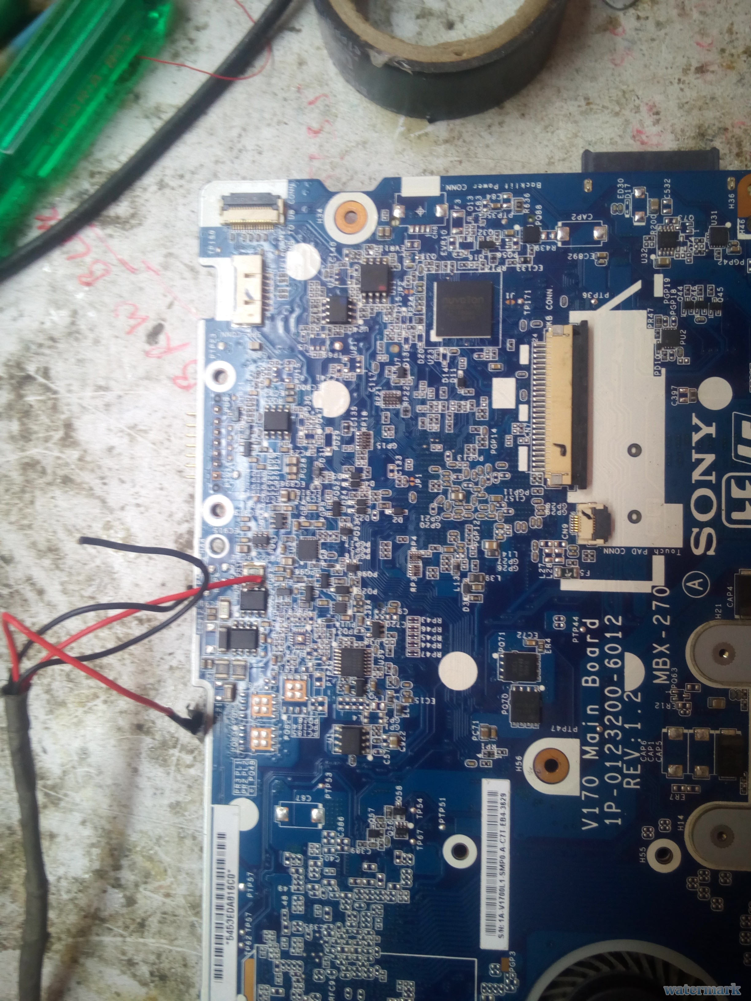

use old technique put own dcjack on mosfit that out to mb nd give imput voltage below batttry out means 9 v
component heats remove component nd board okk
mbx-270 dead multiple shorting
