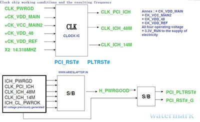

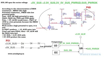

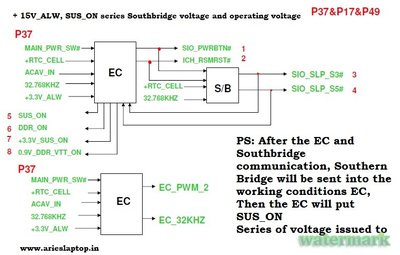

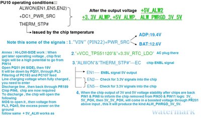

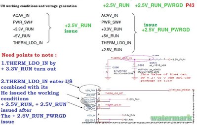

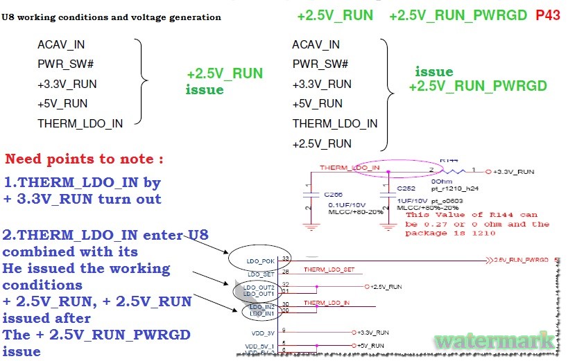

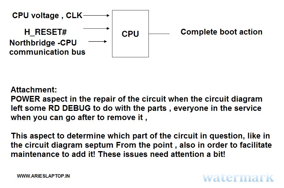

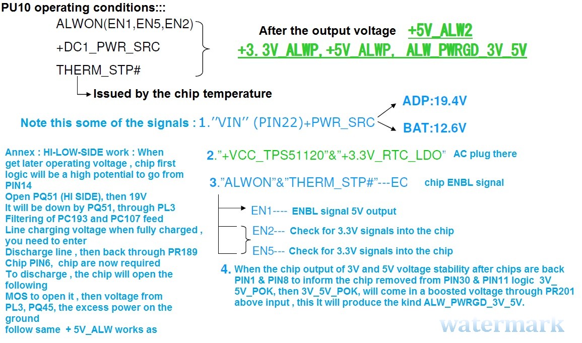

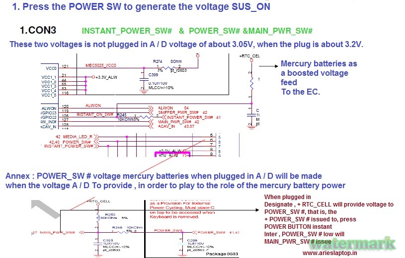

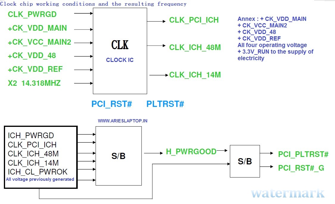

LAPTOP ALL SIGNALS & VOLTAGE (Author Aries)
Photos was an converted chinese to english language . some pronounce and adjective mismatch in translator ...

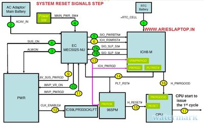

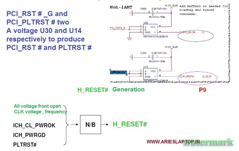

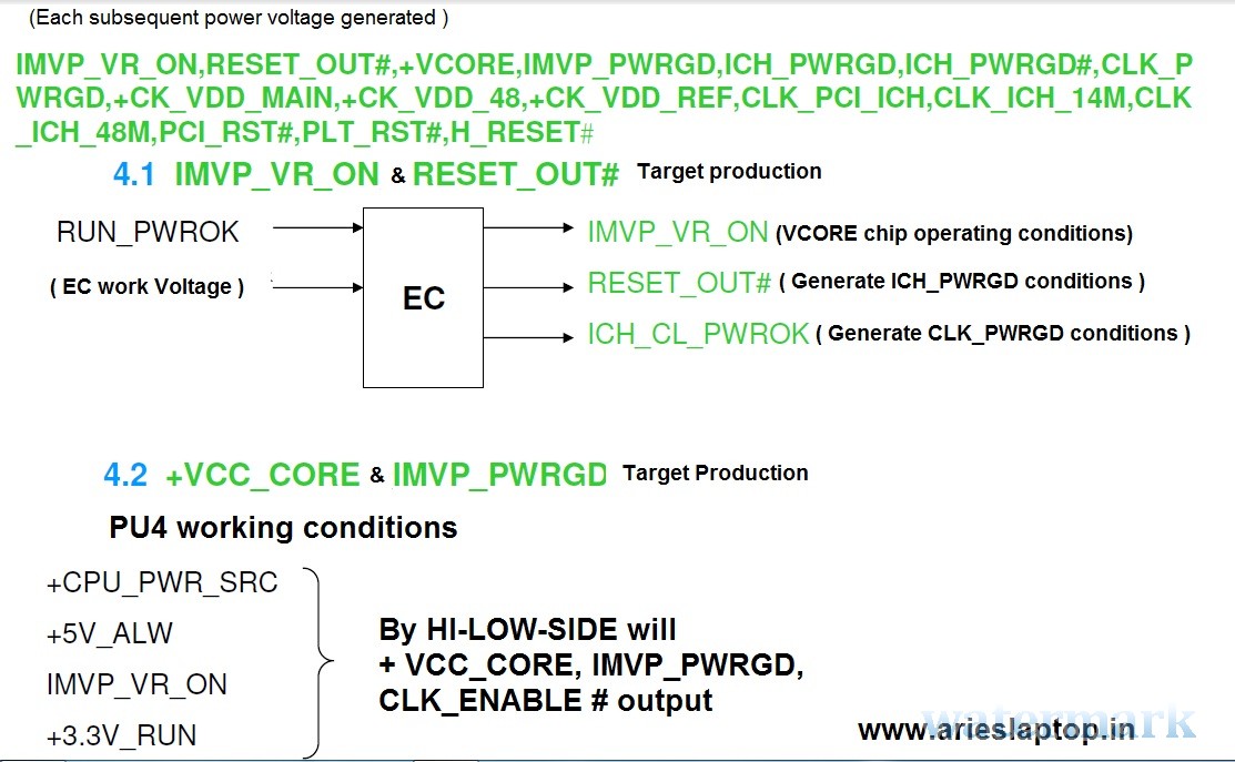

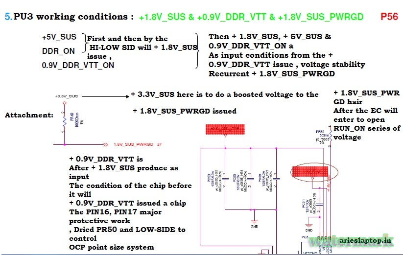

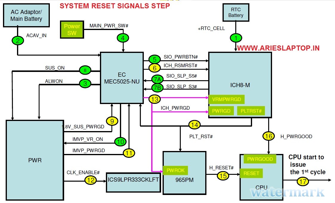

Few More Supply
