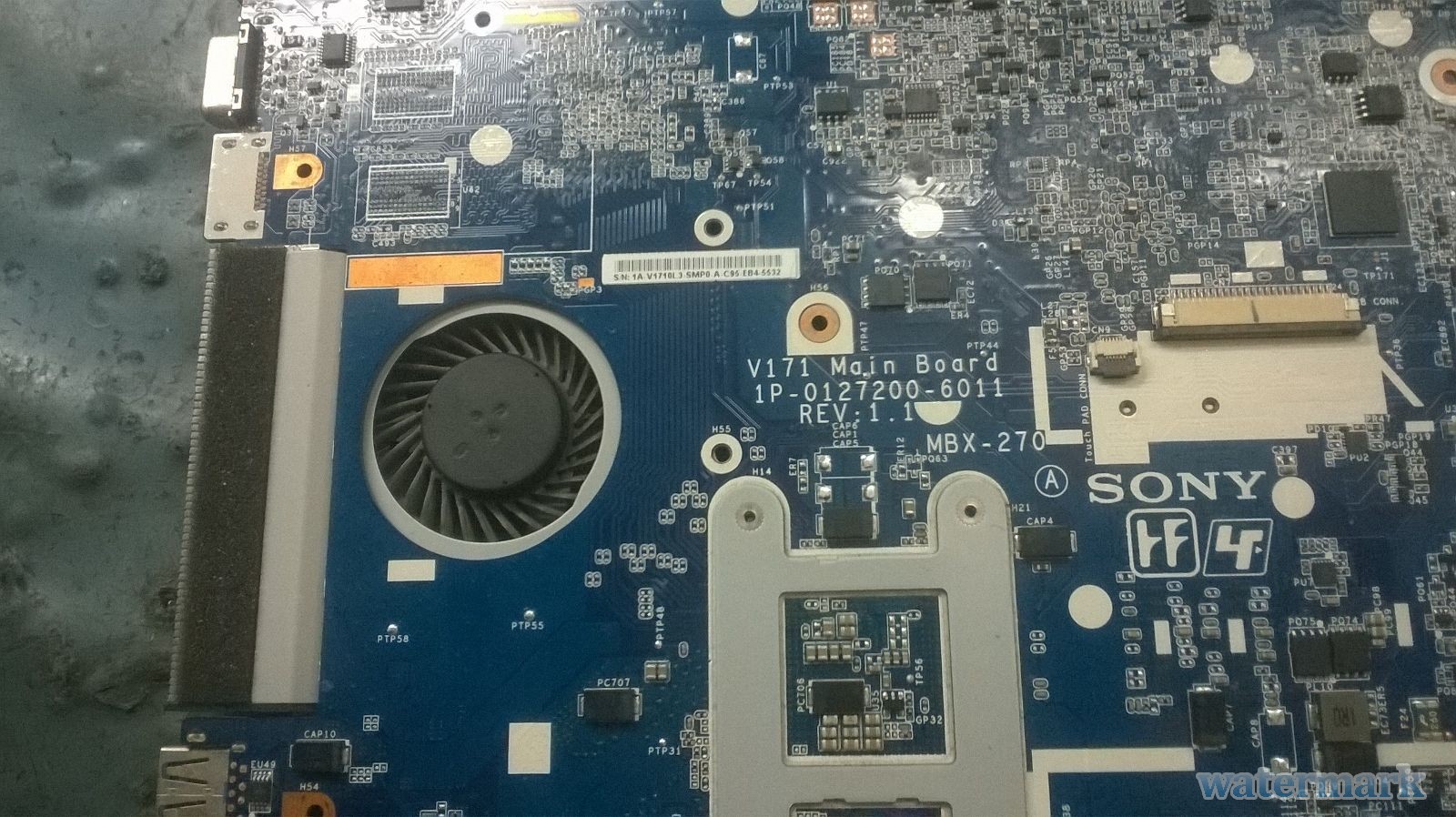

Laptop : sony
Model MBX-270 UMA V171
Problem : laptop not booting
LAptop display sony logo then hangs at post screen with curser blink ...
doesnt boot with Cd usb or hdd
Flashed Main bios Problem Resolved
here is the pic
