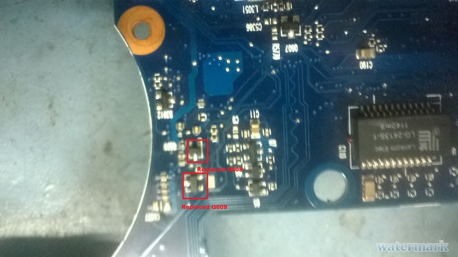

Laptop: Hp elite book 8460p
MBP: 6050a2398701-mb-a02
Fault : DIM display
Laptop comes with power on and im display ... found 3.3 enable back light voltage missing
found faulty Q608 and Q609
Replaced and job done
here is the pic
Case study HPelite book 8460p

the same problem I had
