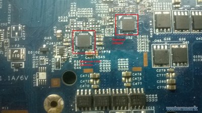

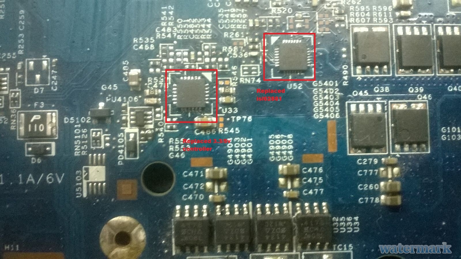

Laptop Acer 4743Z
problem no power
Diagnosis
No 3.3 /5v found
cswapped the 3.3 /5 Vregualator from same old board ...
board power on but 1.05 missing
found isl62881 problem ...replaced and
job done
here is the pic
