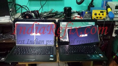

Same Issue and Same Repair
All Voltage Rails Present
All Rst Signal Present
Checked external display - no display Confirm!
Bios Chip Reflash but No Good Because Both Bios Chip itself is bad
Replaced Bios and reprogram it with k42jr bios
verified and Done!
End
I will Upload the working Dump in Bios Section Working for both rev 2.0 and 3.0 for K42JR Asus Board
