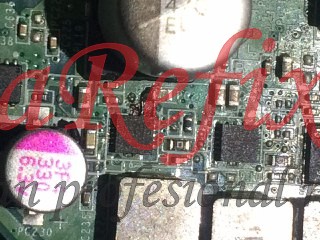

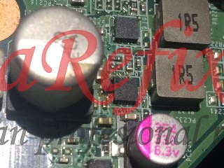

Case study Quanta R62
No Power
Found pu9 burned and vin track at pin 1 melt and short with inner ground layer, remove pu9, cut vin track from pin 1 and clear shorting with ground then fix new NB670 IC and make jumper from pin1 to pc207. Case done laptop working fine
