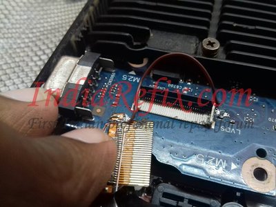

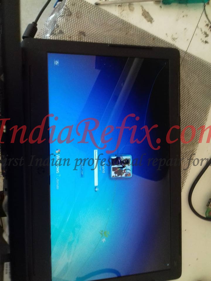

HP 241 GOVERMENT LAPTOP DIM DISPLAY PROBLEM.AFTER CHECK THE BOARD DISPLAY CABLE 19V TRACK DAMAGED. TAKE 19V DIRECTLY TO DIPLAY CABLE LAPTOP WORKING FINE.
