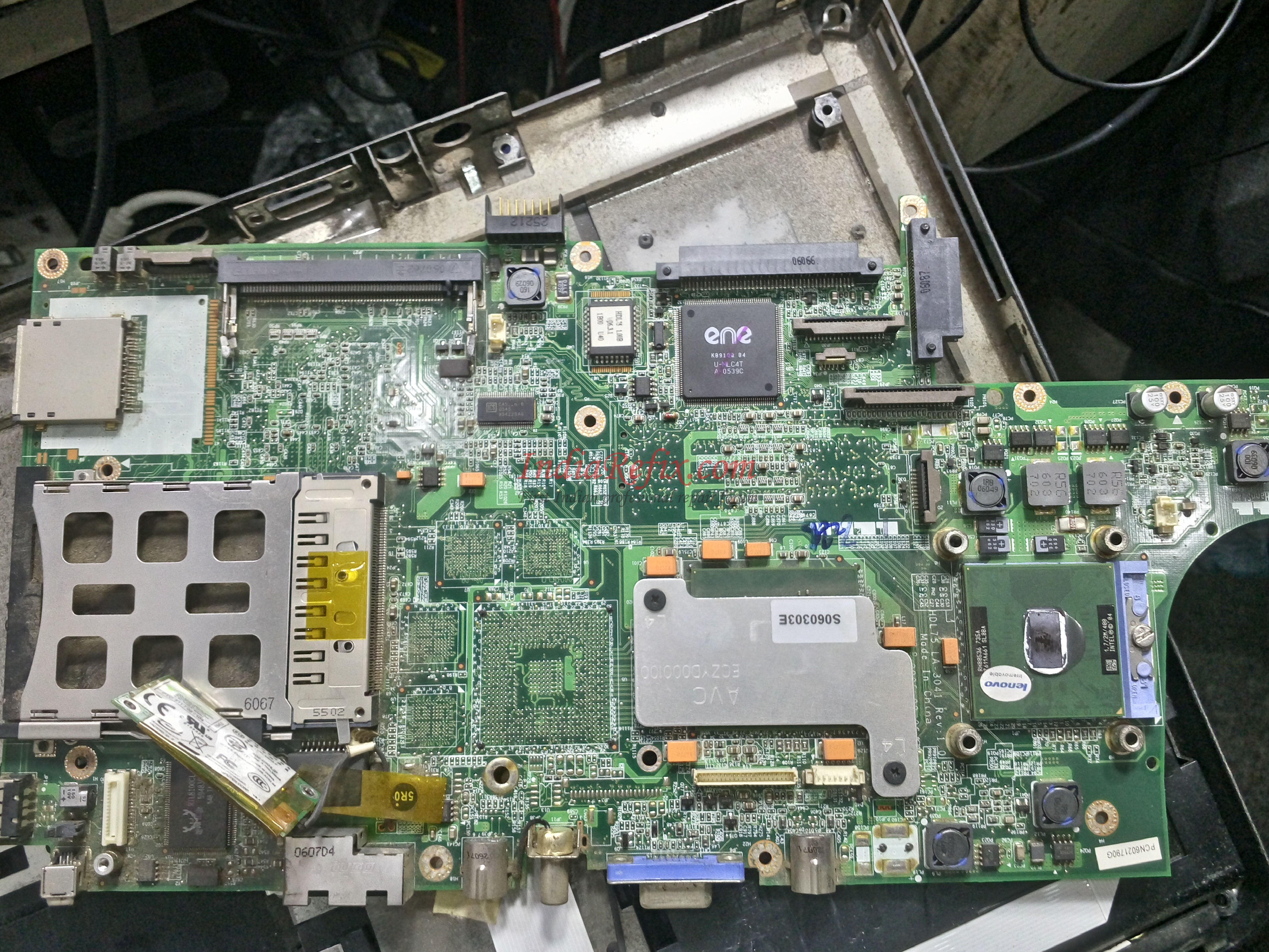

THE MOTHER BOARD WAS DEAD

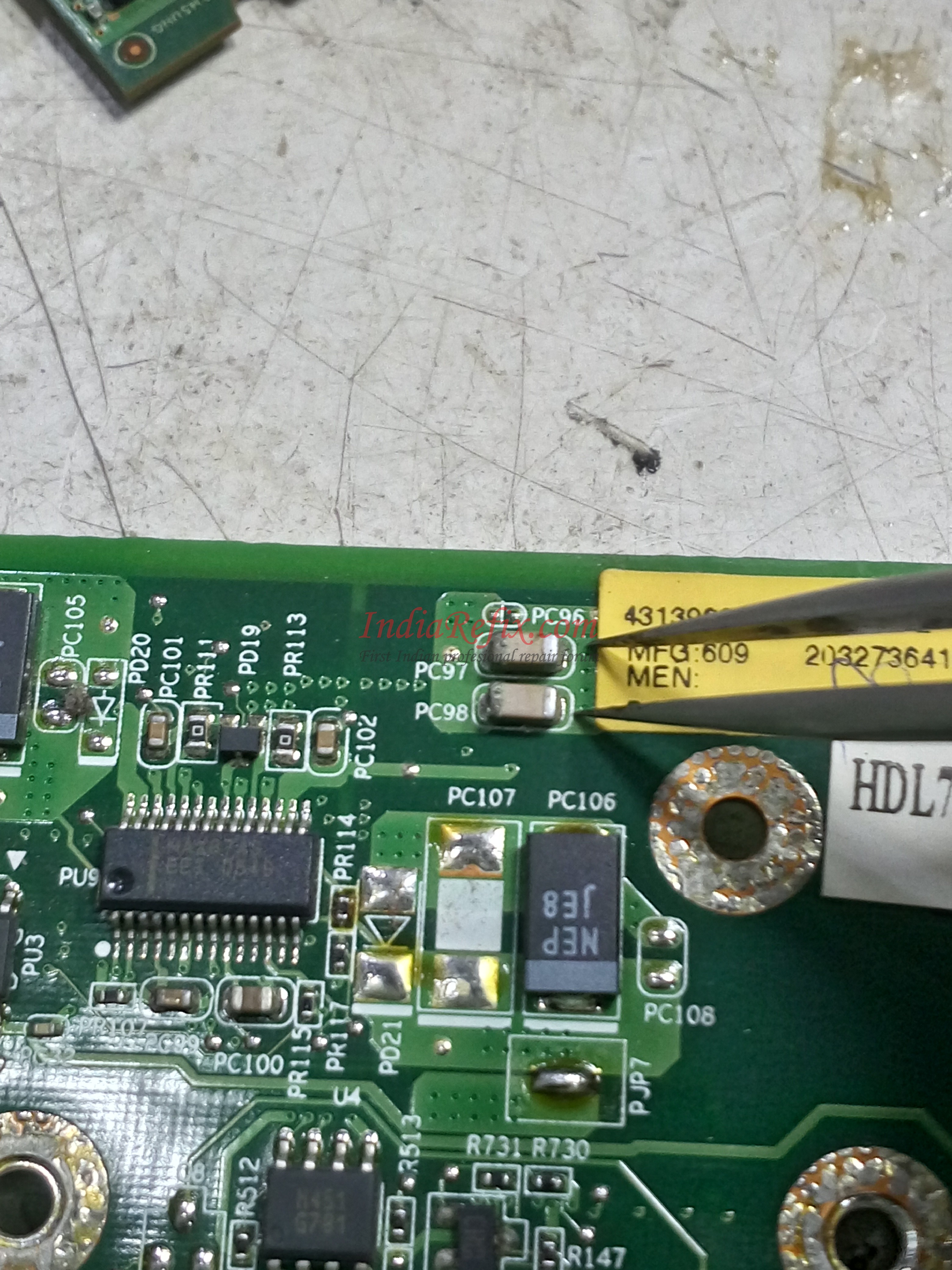

NOT GETTING DC IN 19 VOLT

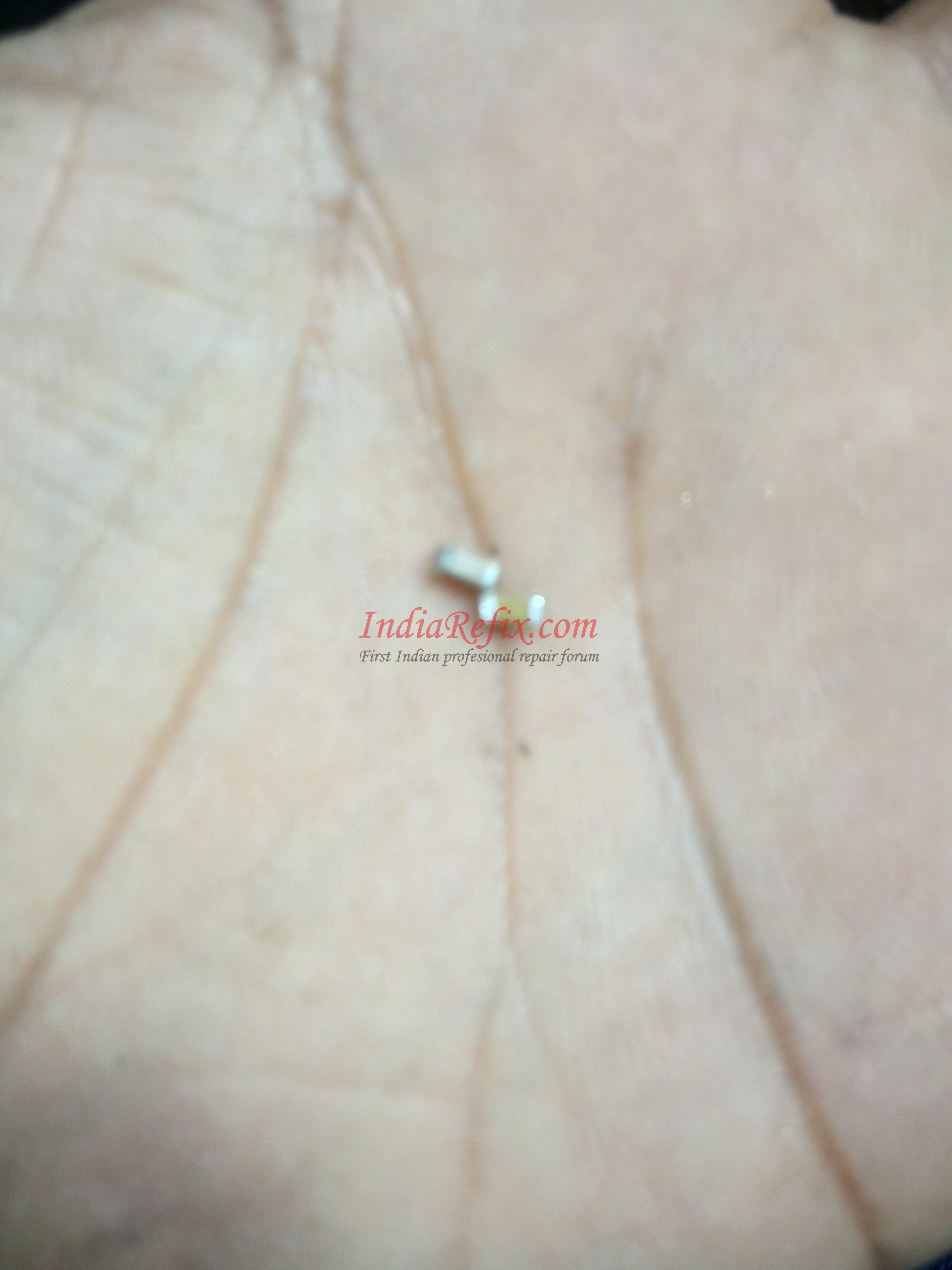

FOUND TWO CAPS SHORT
REPLACED AND ITS WORKING FINE
