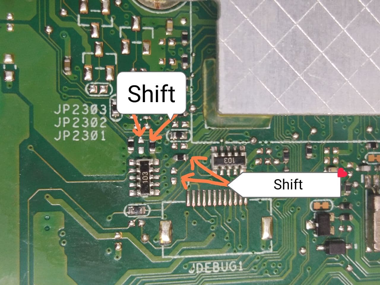

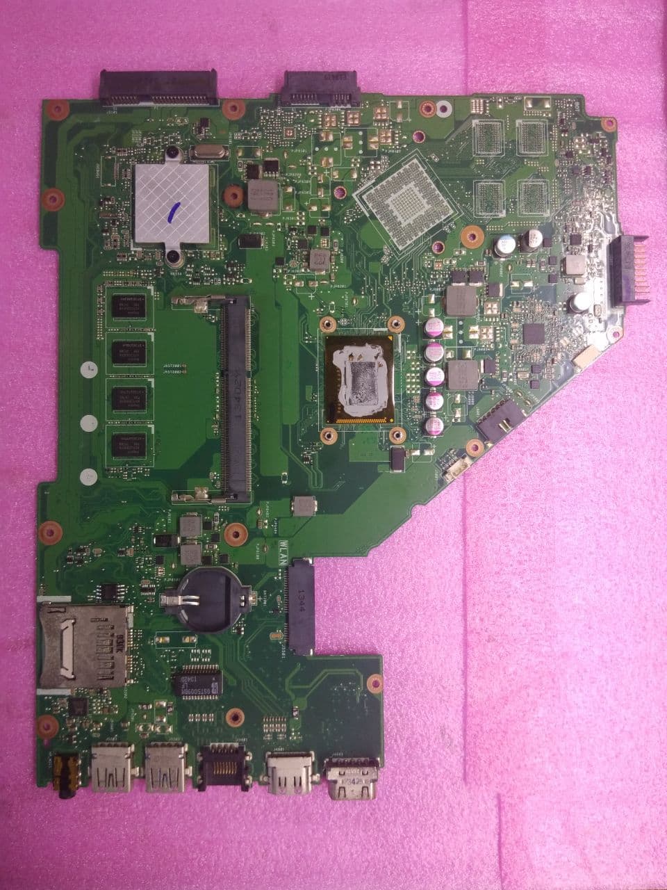

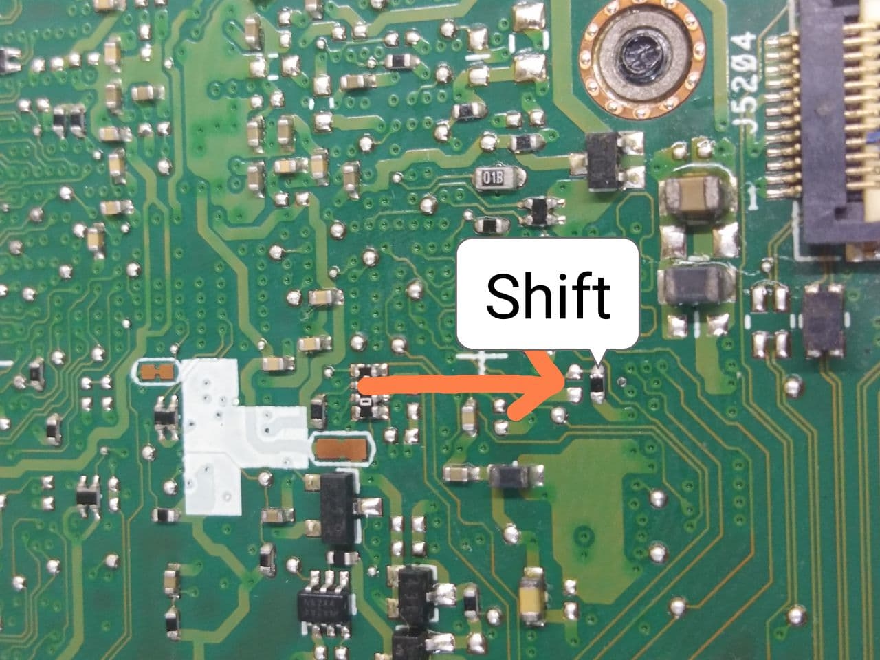

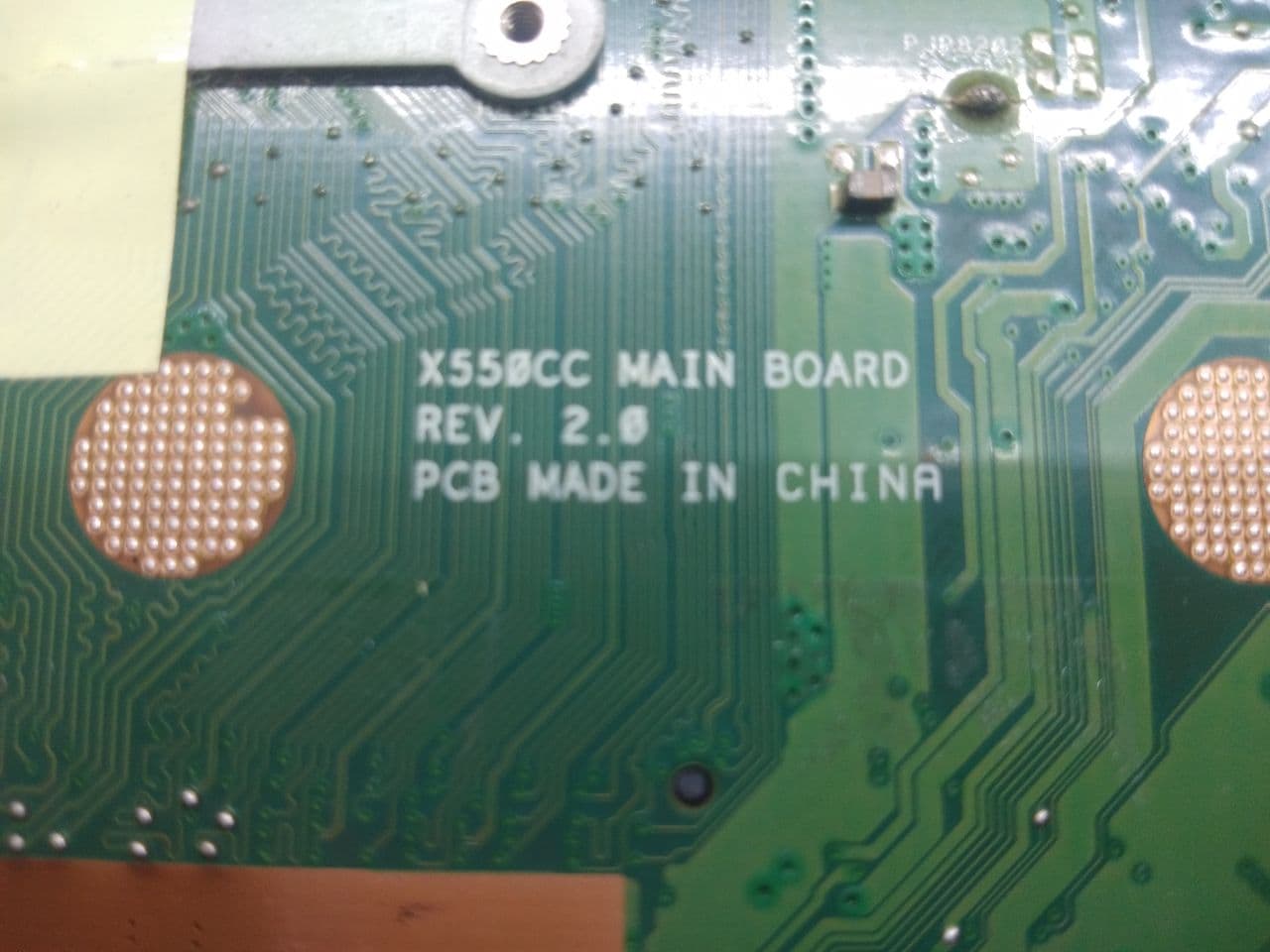

ASUS X550CC MAIN BOARD REV 2.0 ONBOARD RAM DISABLE
#ASUS X550CC MAIN BOARD REV 2.0 ONBOARD RAM DISABLE
#ONBOARD RAM DISABLE
