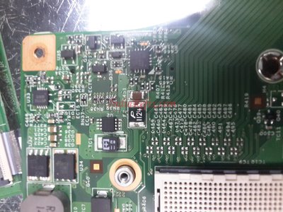

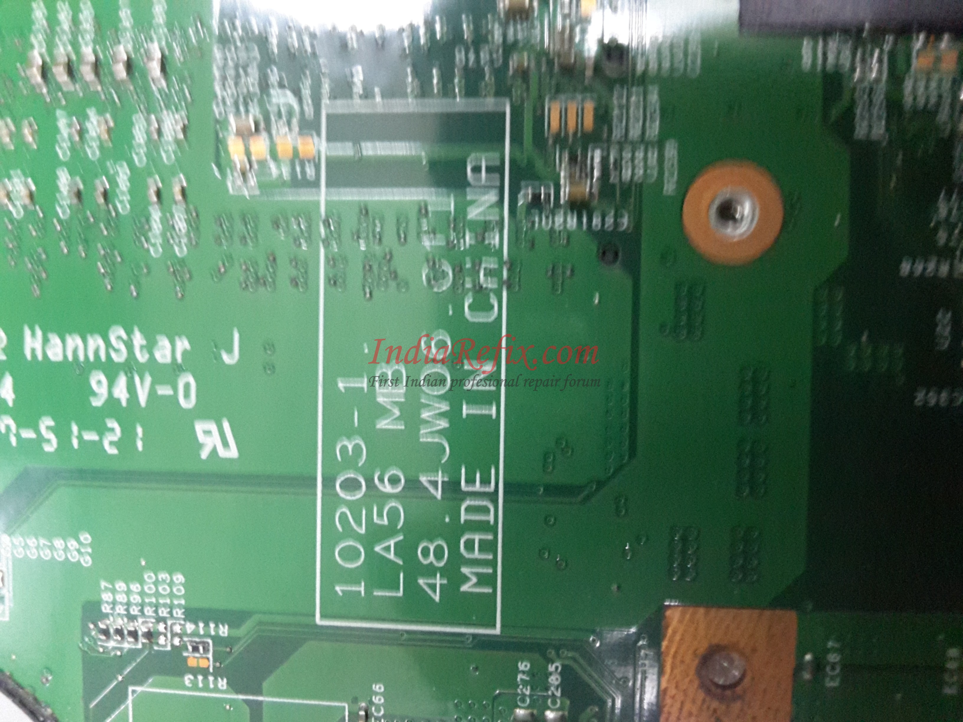

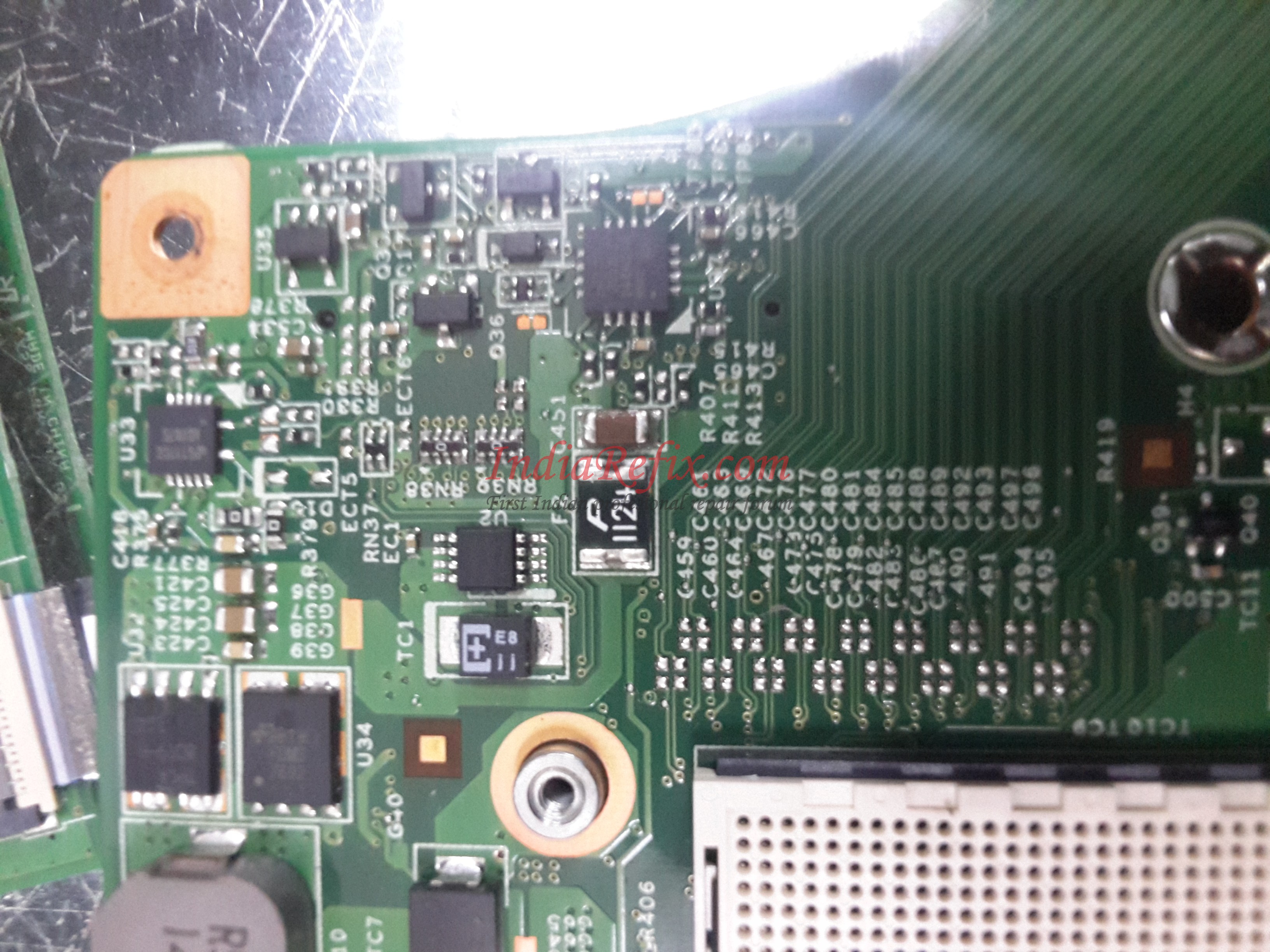

Lenovo b560
La56 mb
Problem dim display
Fuse f2 is got heated
All capacitor shows 12ohms
C451 leakage problem replaced
Working fine
