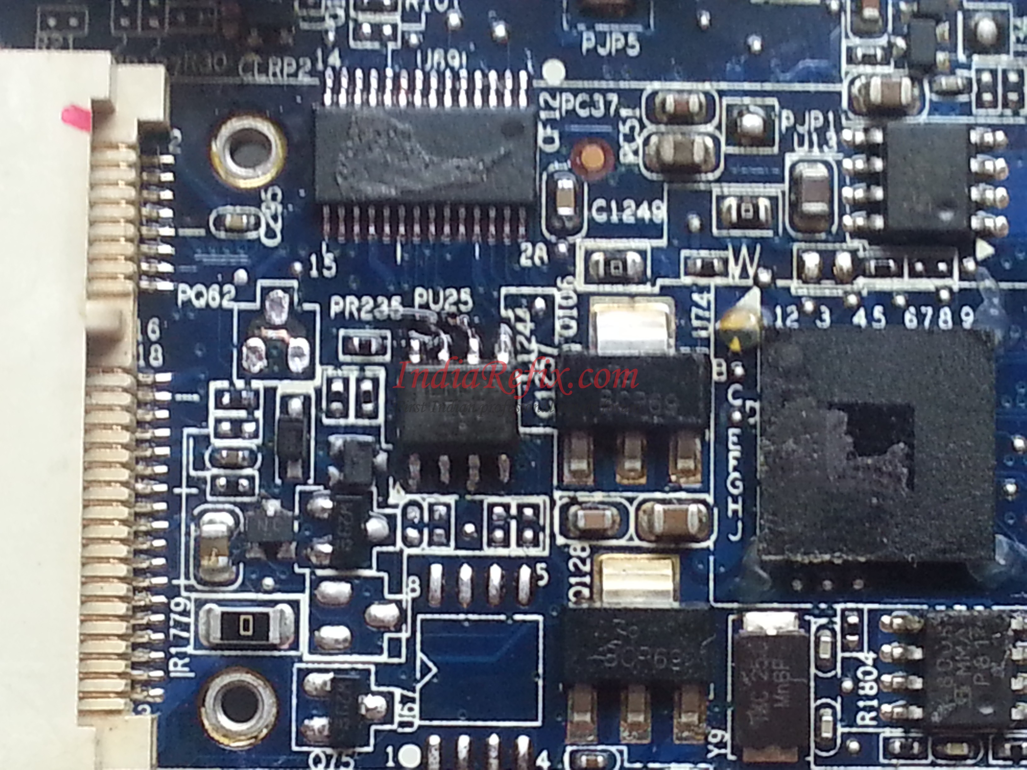

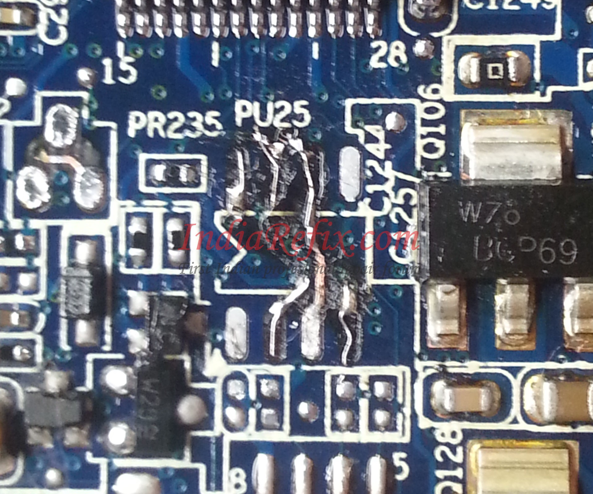

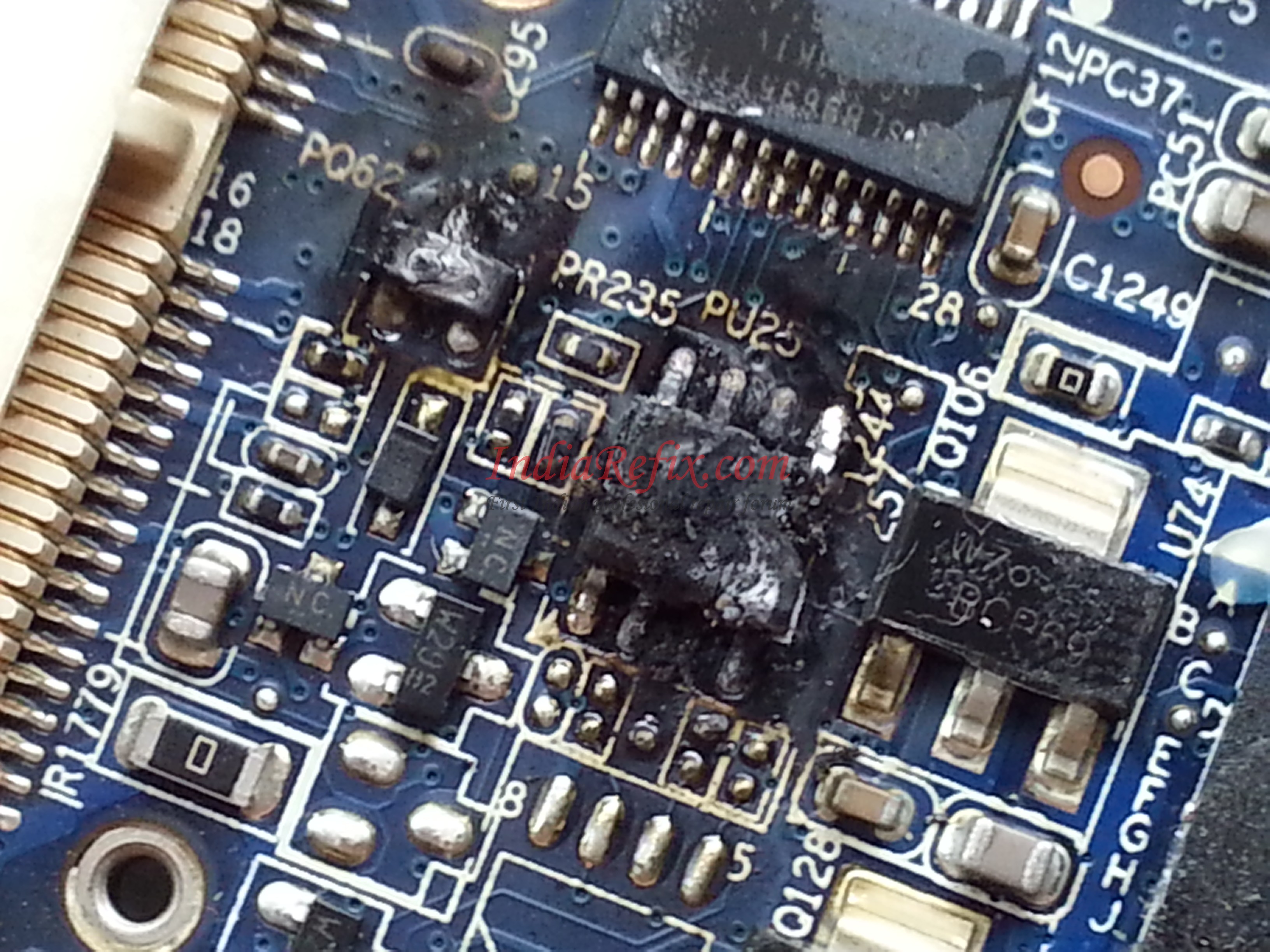

NO POWER ON.. AMP 0.10

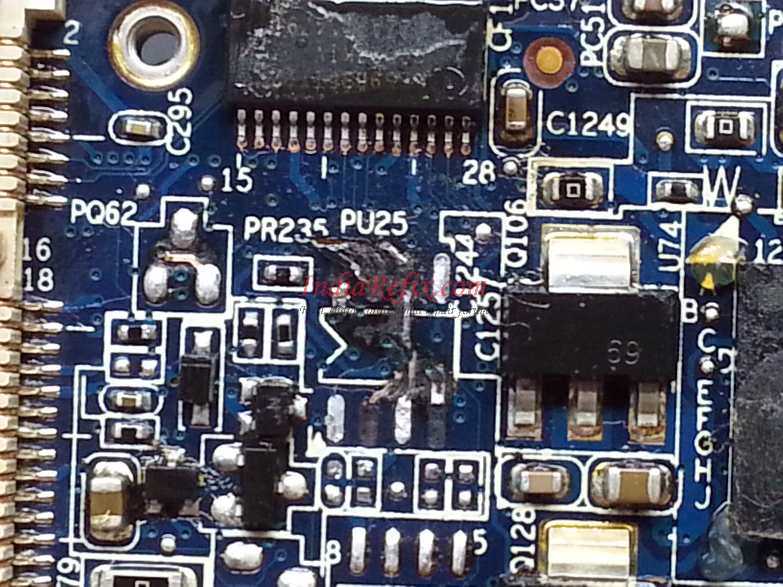

I FOUND PU25 (LM393) AND PQ 62 BURNED , i make jumpers and replace with new ics

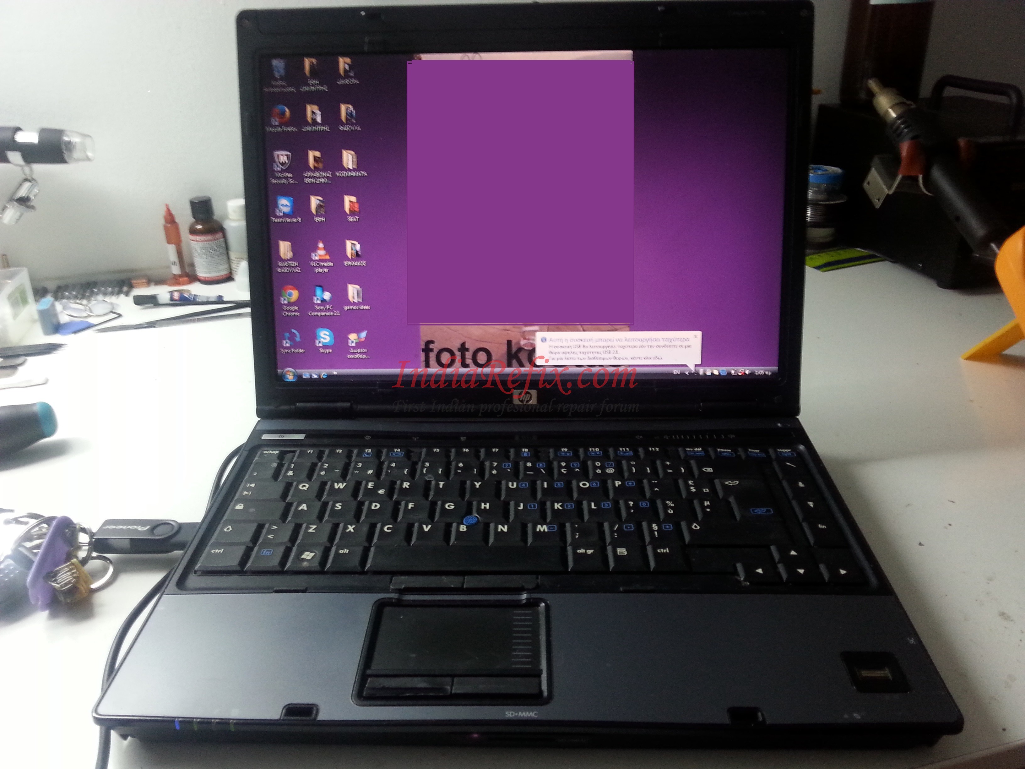

problem solved , laptop works again :)
