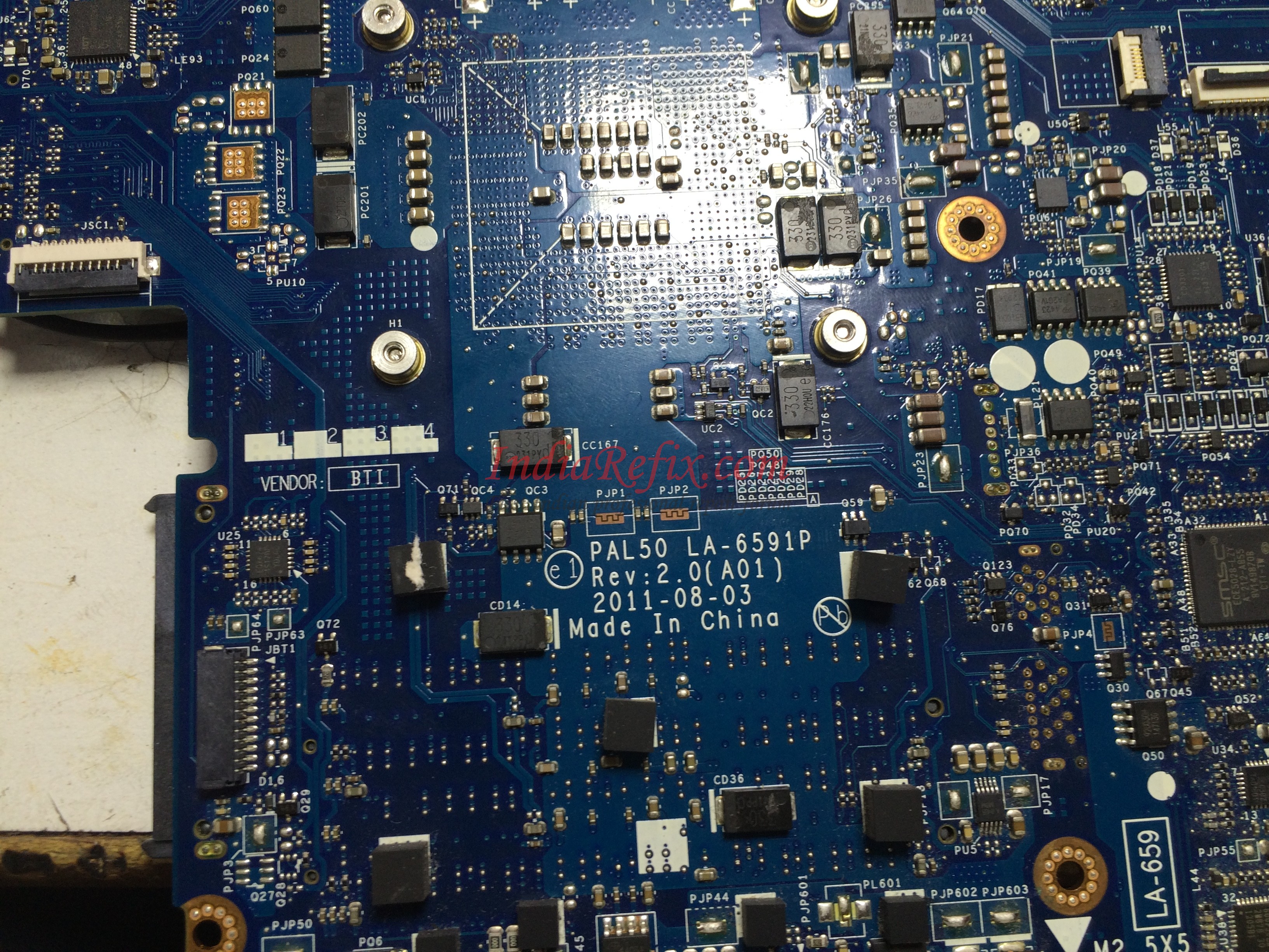

MB- PAL50 LA6591A
PROBLEM- NOT CHARGING

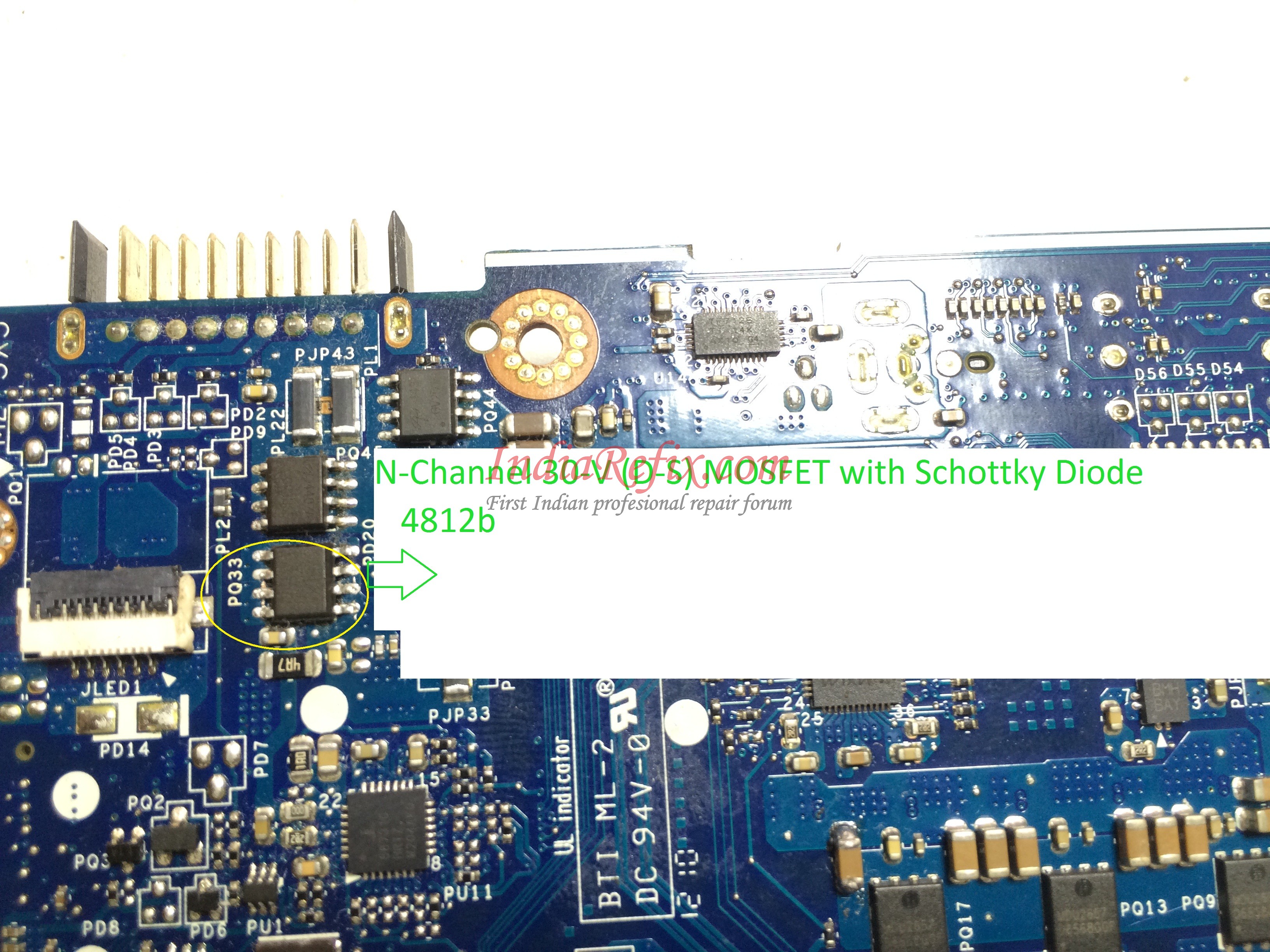

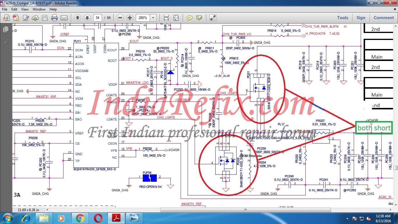

CHECK IN BOARD FOUND +VCHRG LINE IS SHORTING

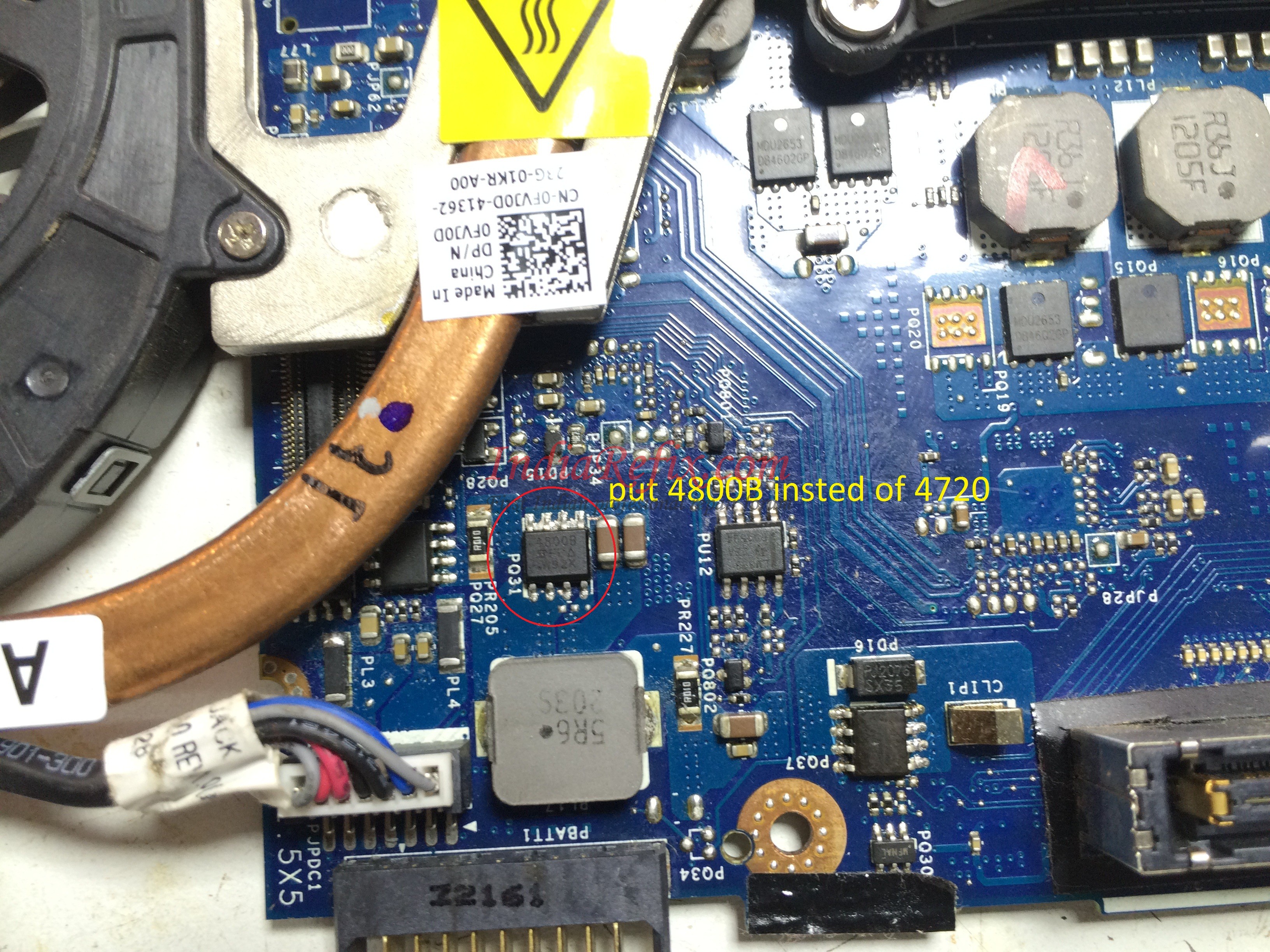

PQ31 & PQ33 BOTH MOSFET ARE SHORT
PQ31 IS 4720 AND PQ33 IS 4820B
BOTH MOSFET ARE N CHANEL BUT PQ33 (4820 IS N- CHANEL 30V WITH SCHOTTKY DIODE)
RESOULATION
REPLACE 4720 (PQ31) WITH 4800B (N- CHANEL 30V MOSFET)
REPLACE 4820 (PQ33) WITH 4812B (N-Channel 30-V (D-S) MOSFET with Schottky Diode)

PQ33 ( REPLACE WITH 4812B)
PQ31 ( REPLACE WITH 4800B)
+VCHRG SHORT PQ31/PQ33
BOARD PART
BOARD PART
