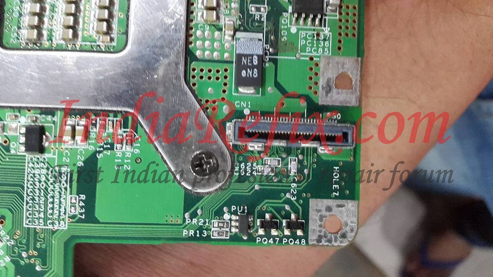

Problem Dim Display
Diagnose 19 Volt missing Found 19 volt passing pin damage in display connector (Pin No. 29)
Solution : Change Display Connector Display OK...
