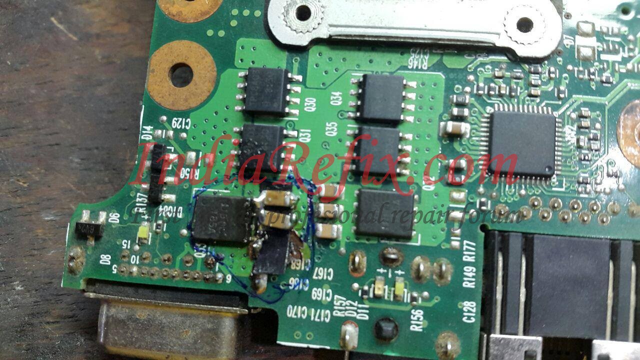

Problem: Laptop on But No Display
Diagnose Found 19volt caps short and track burn
Solution : Remove shorting and make track now display ok......
