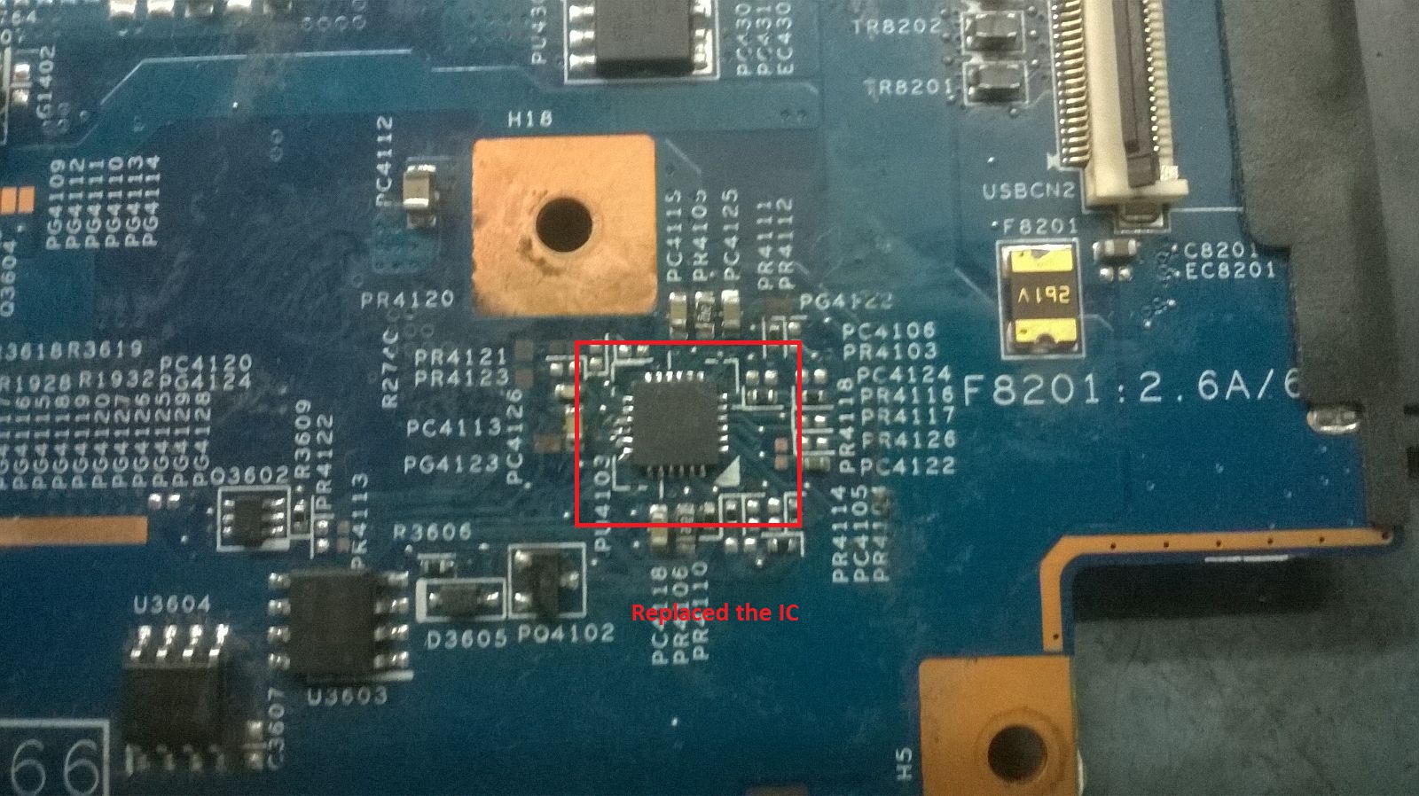

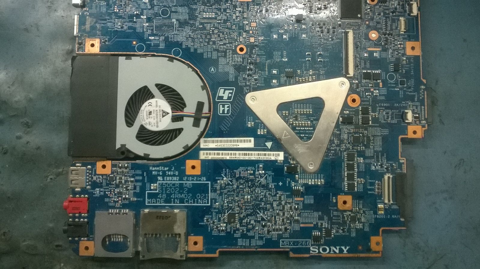

MBX-266 Z50CR no power ....
Found no 3.3 and 5 V generating ....
RElaced the controller and
system working fine now
