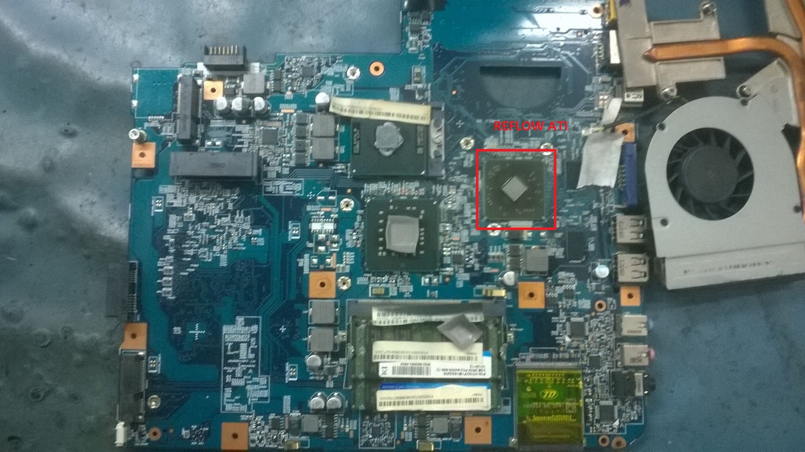

ACer 5738Z
Power on No display .....
PSU consuming upto 0.80 AMPS
ATI REFLOW DONE..
System working fine now
here is the pic
