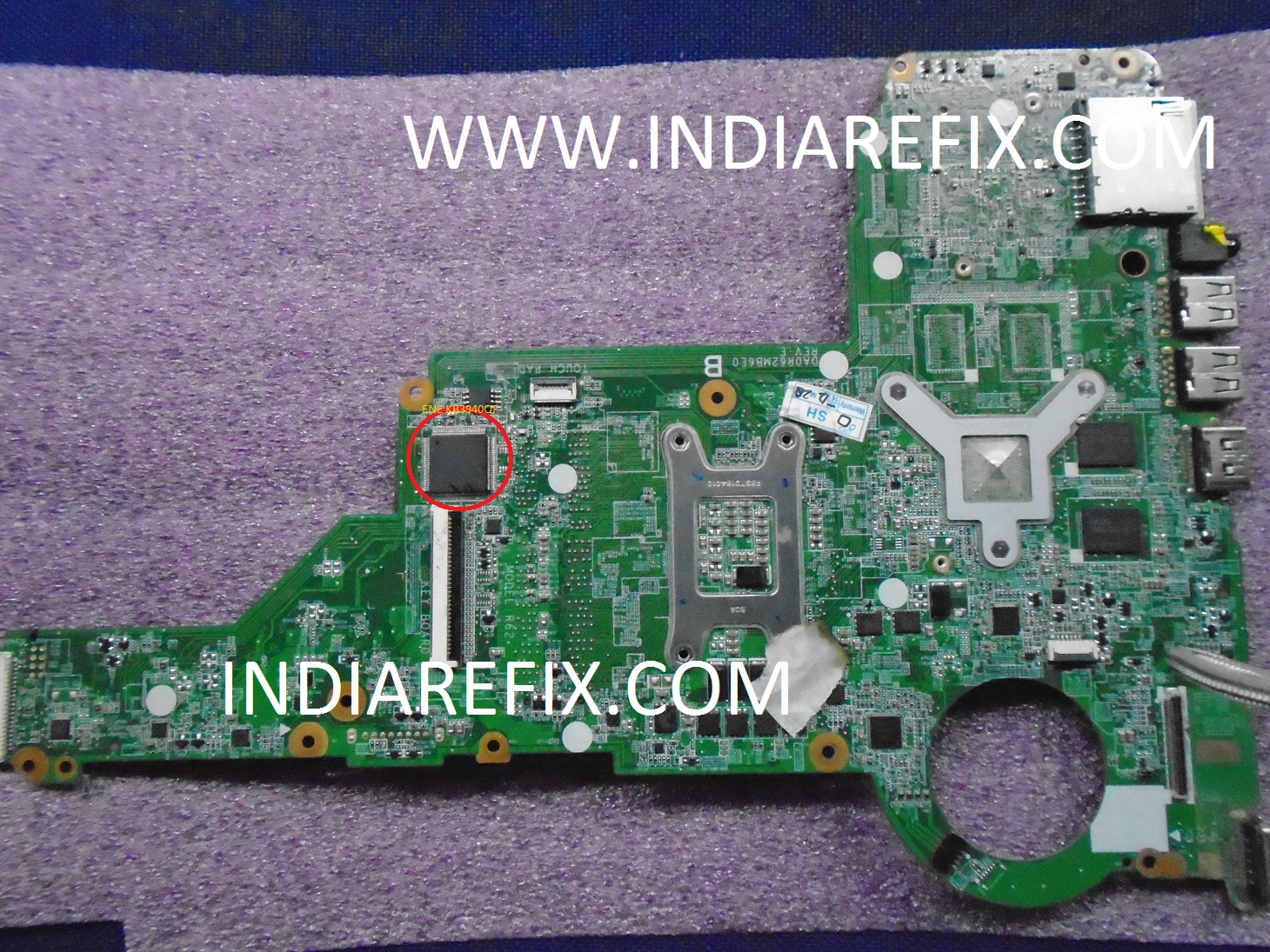

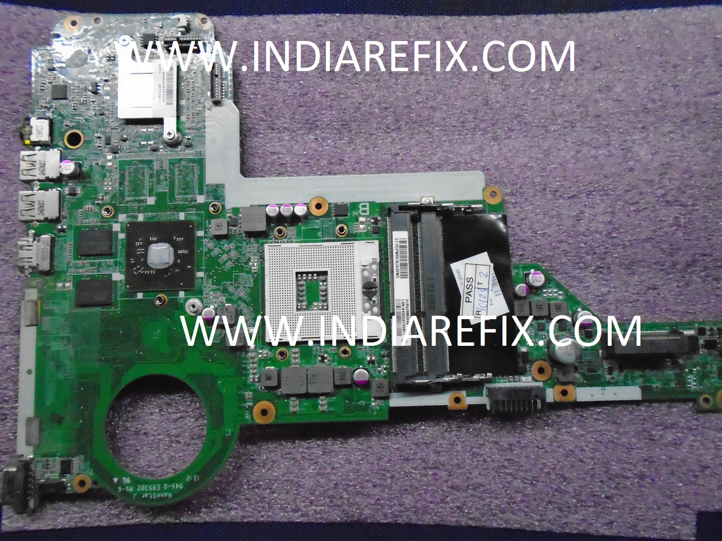

Make/Model- HP 15
Motherboard Part No- DA0R62MB6E0 Rev-E
Processor Type-i5 3rd Gen
Ram Type –DDR3
Problem – When Shutdown Laptop Restart
Diagnosis- I/O Controller Faulty
Process-
HP 15 laptop found When Shutdown restart laptop open laptop then check complete laptop not found any rusted component and track. Reprogram bios chip EC Main and PCH(SLJ8E) but problem not solved . after replaced I/O (Ene KB3940QF) Problem Solved .
