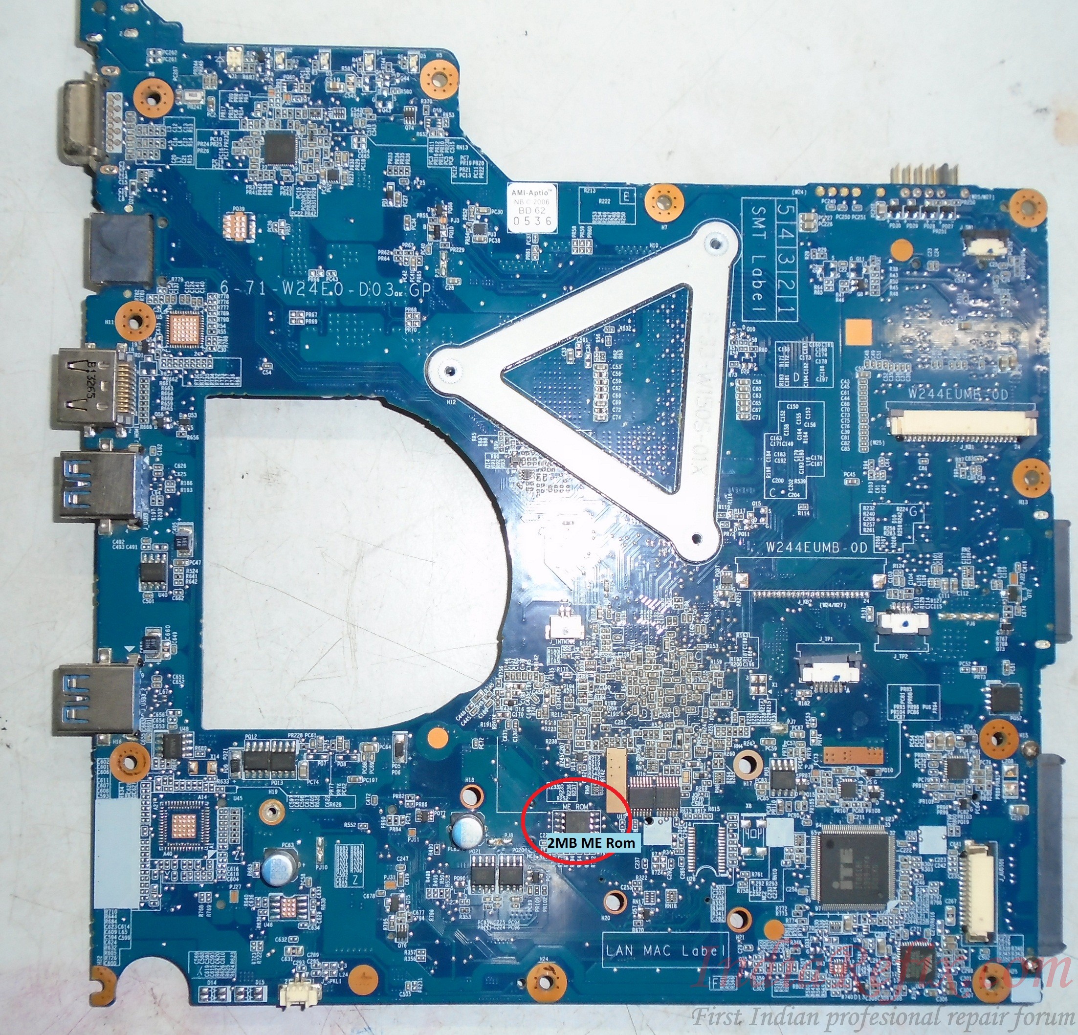

Make/Model: HCL ME L1064
Motherboard Part No: CW244EUMB-0D / 6-71-W24E0-D03 GP
Processor Type: I3 3rd Gen
Ram Type: DDR3
Problem: Laptop Auto on Display Ok
Diagnosis: Found Bios Currept (BIOS ME REGION)
Process:
Coming a laptop HCL Me L1064 Auto on And Proper Work But Laptop Not On With Switch And Not Off With Swith and When Shut Down Laptop , Auto Restart not shut down , This Case We change I/O (ITE IT8518E) But Not Solved Problem , Replace PCH (SLJ8E ) And Reprogrem And Replace MainBios (4MB) And EC(2MB) Bios After Help ABU SAEED Problem Sloved . ME REGION (2MB Rebuild ) then Program Bios Problem Solved And Laptop Work Fine.
