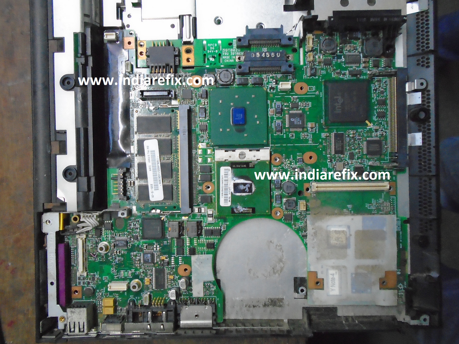

Make/Model-IBM Thinkpad R51
Motherboard Part No-
Processor Type- ------
Ram Type -DDR1
Problem –Dim Display
Diagnosis-16V+VE LVDS Line Burn
Process-

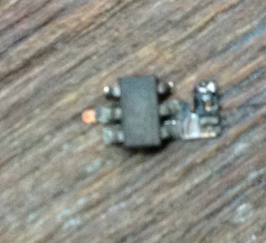

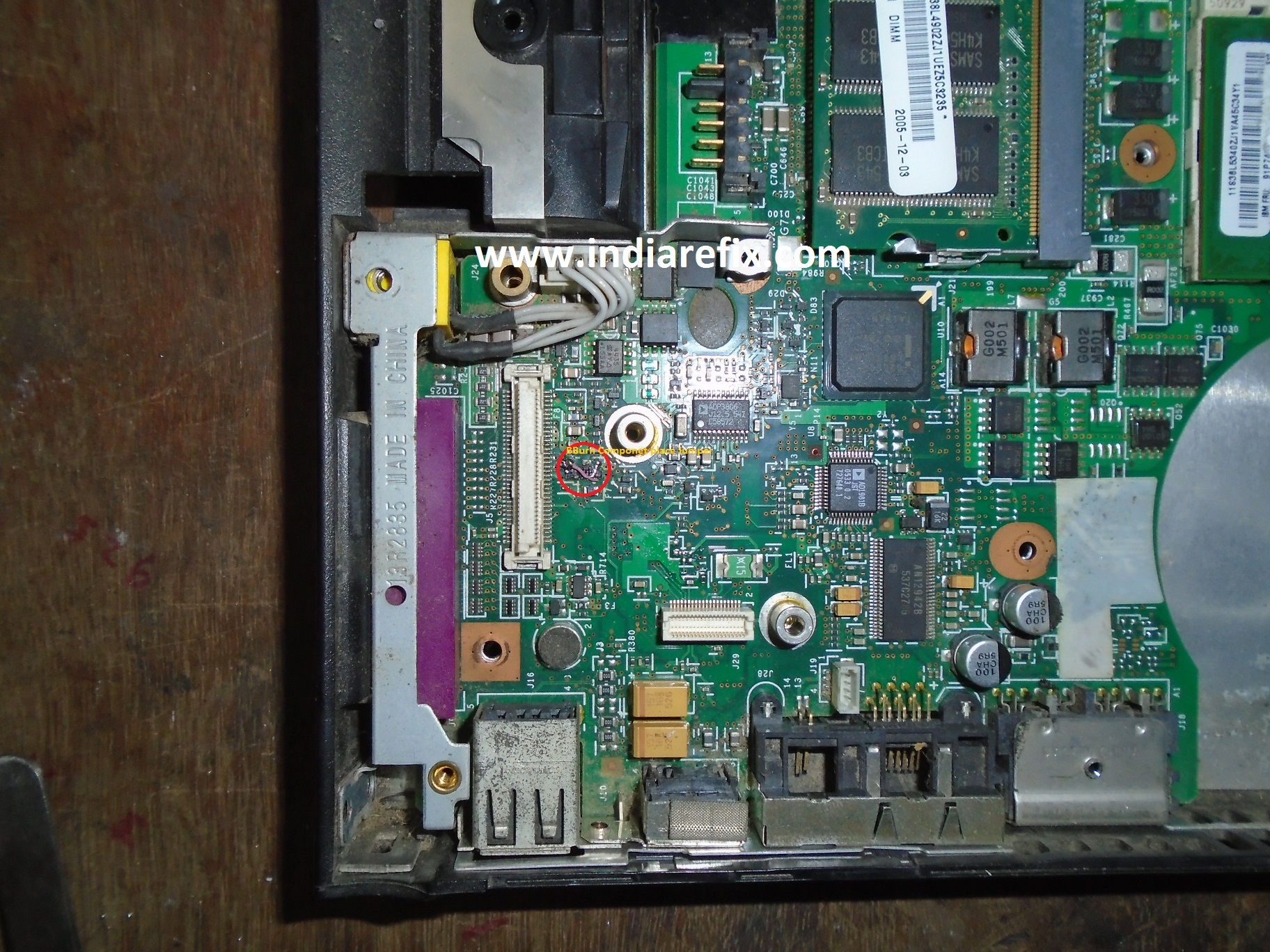

Coming a laptop IBM thinkpad R51 Dim Display (No Light On Screen But Display Coming ) Open Laptop then found near LVDS connector Burn Transistor
then open part fount track bunt then joint a jumper wire circuit complete after joint circuit check display light coming
