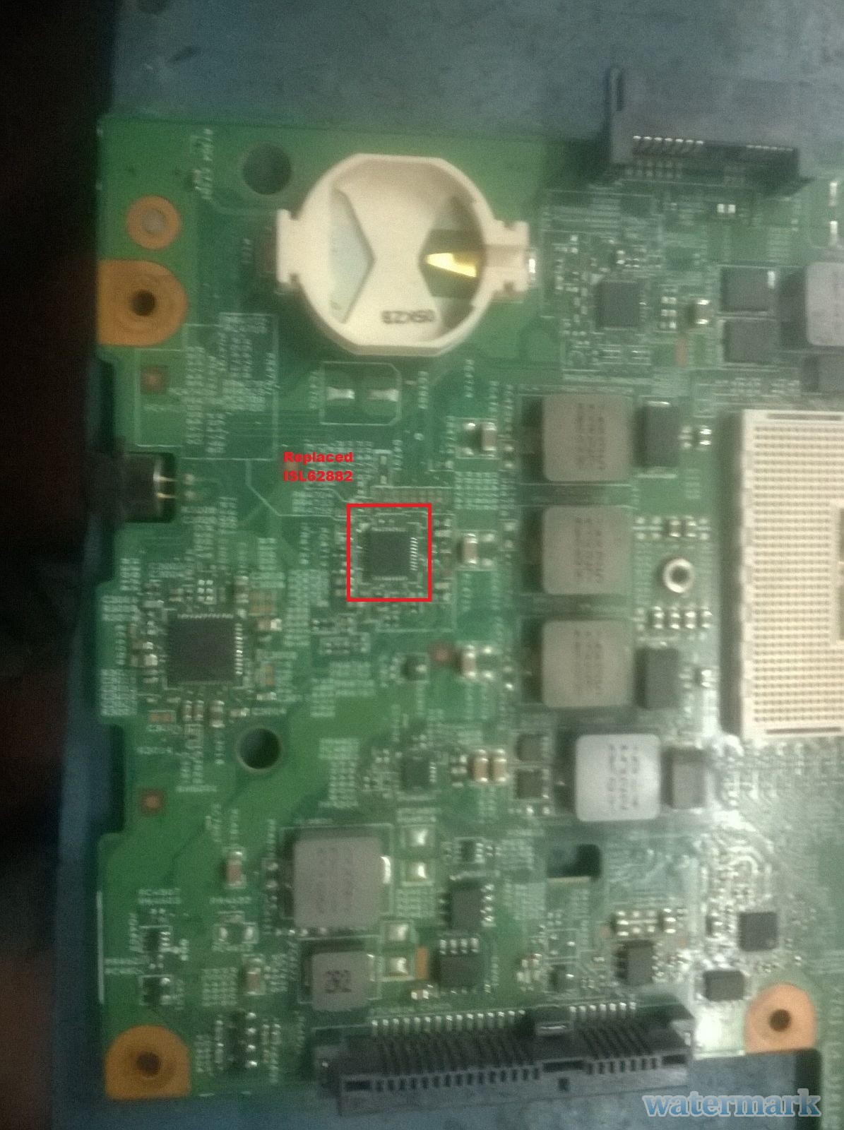

Laptop N5010 UMA
Problem No display
3.3v /5V ok ....
PSU takes up .40 AMps ....
1.05 present
no vcore ..
Changed Vcore Isl 62882
Problem solved
here is the pic

Nice how u can judge this ic is problem
