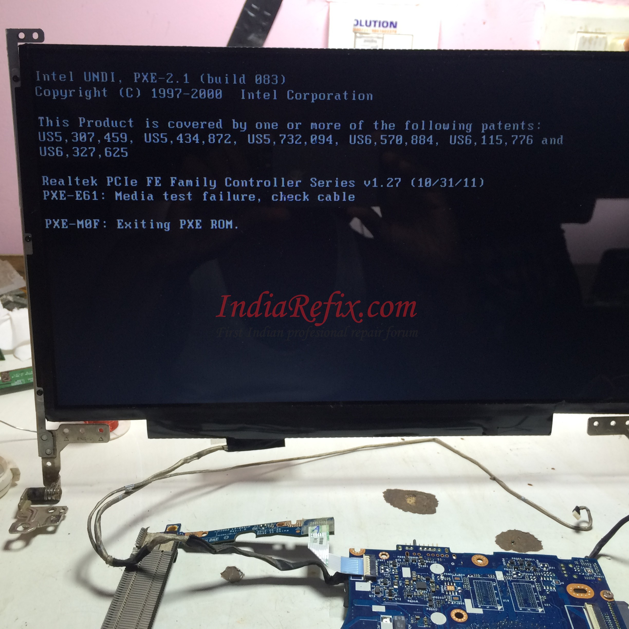

problem----dimm display no backlight

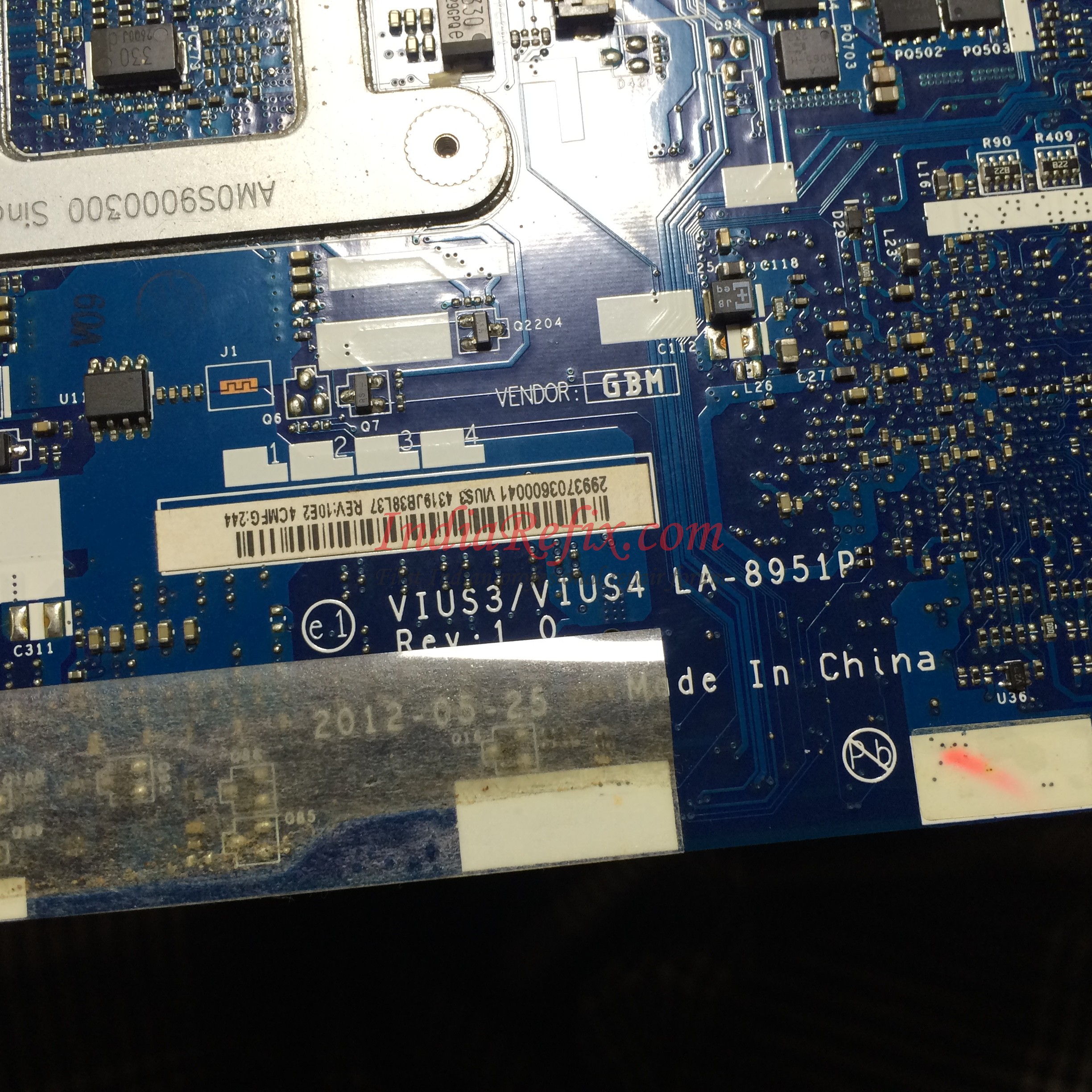

BOARD PART- VIUS3/VIUS4 LA-8951P

checked with other cable and led same result dimm display
this cable and led working fine in other board
then i confirm board issue

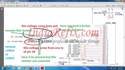

but only missing pin35 of invt_pwm 3.3v which enable the led light ( EN_LED MISSING)
which is coming from pch and signal name as pch_pwm which is not avilabe 3.3v

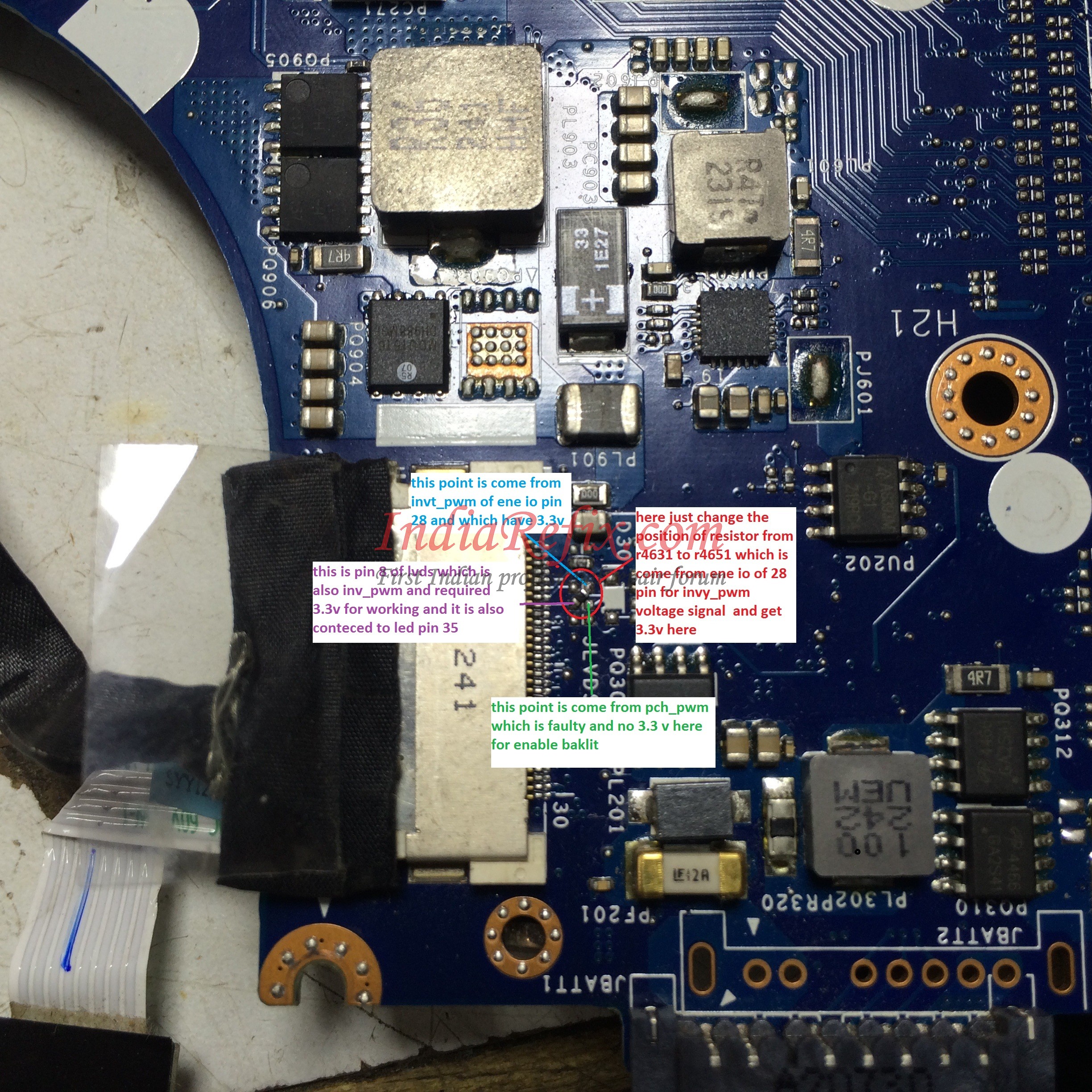

i just put jumper from pin 37 to pin 35 of lcd and BACK ligt on ( THIS IS FOR TESTING PURPOSE)
then i trace found pch issue

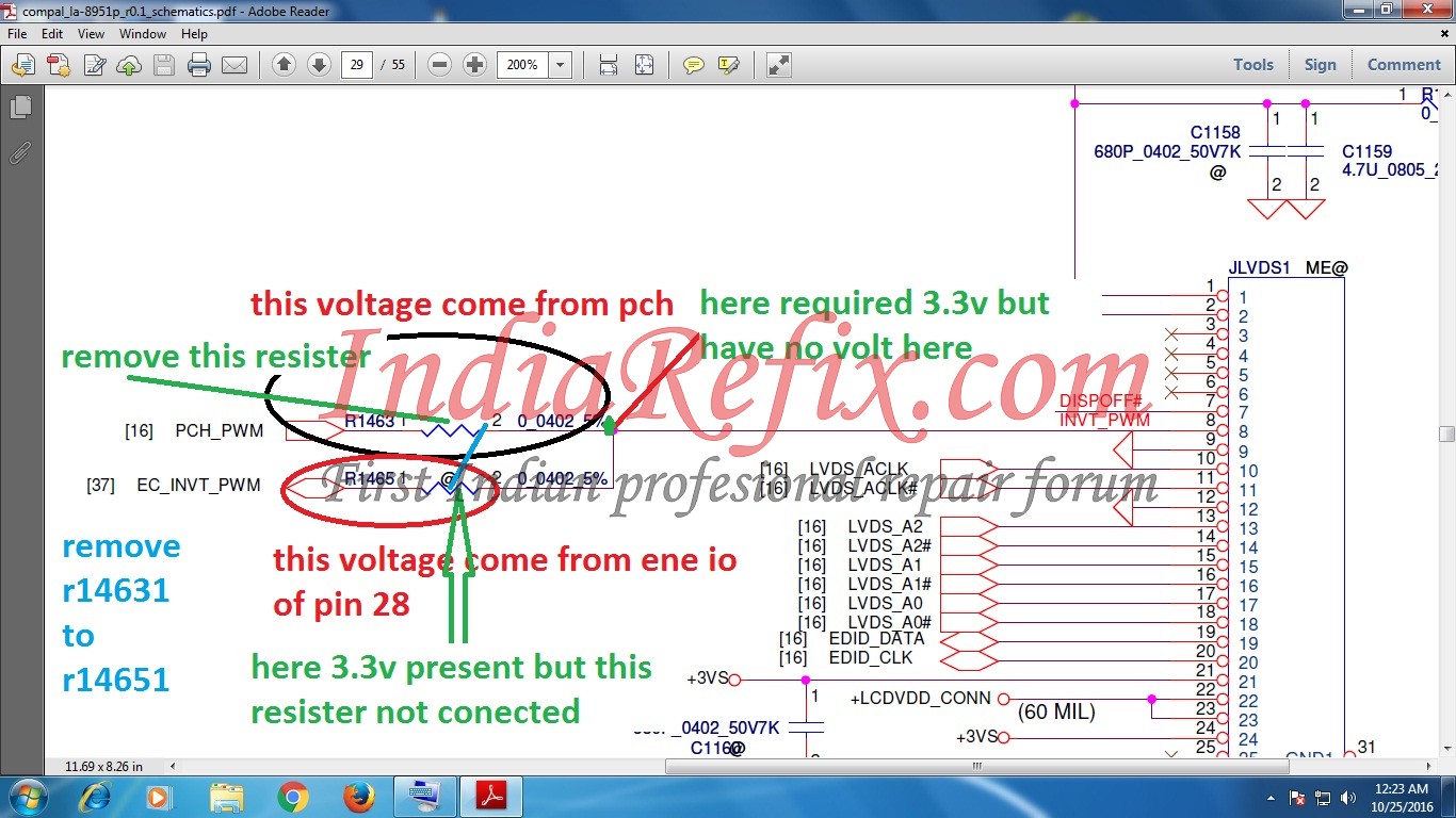

but this board have two invt_pwm one is coming from pch_INVT and other is coming from ene io ec_invt_pwm
EC_INVT_PWM not conected just optional in resistor place r14651
RESULATIONNNNNN
so just remove resistor r14631 and conect it to the place of r14651 which one is connect to lvds1 in pin8
and which is goes to pin35 of led
now laptop working fine

BOARD PART NUMBER
BOARD PART NUMBER

But Sir i think brightness will not vary.it will fix at high
skbasir
Location: BHUBANESWAR
Re: DIMM DISPLAY IN LENOVO S300 IDEAPAD
Post by skbasir »
ganeshcell wrote:But Sir i think brightness will not vary.it will fix at high
you are absoulatly right but it is pch issue and needed to replace PCH and it wiil more cost and risk so that i am doing this job................to just make working condition

Don't you think this is bad connection at PCH rather than PCH going bad? Did you check for open traces?
