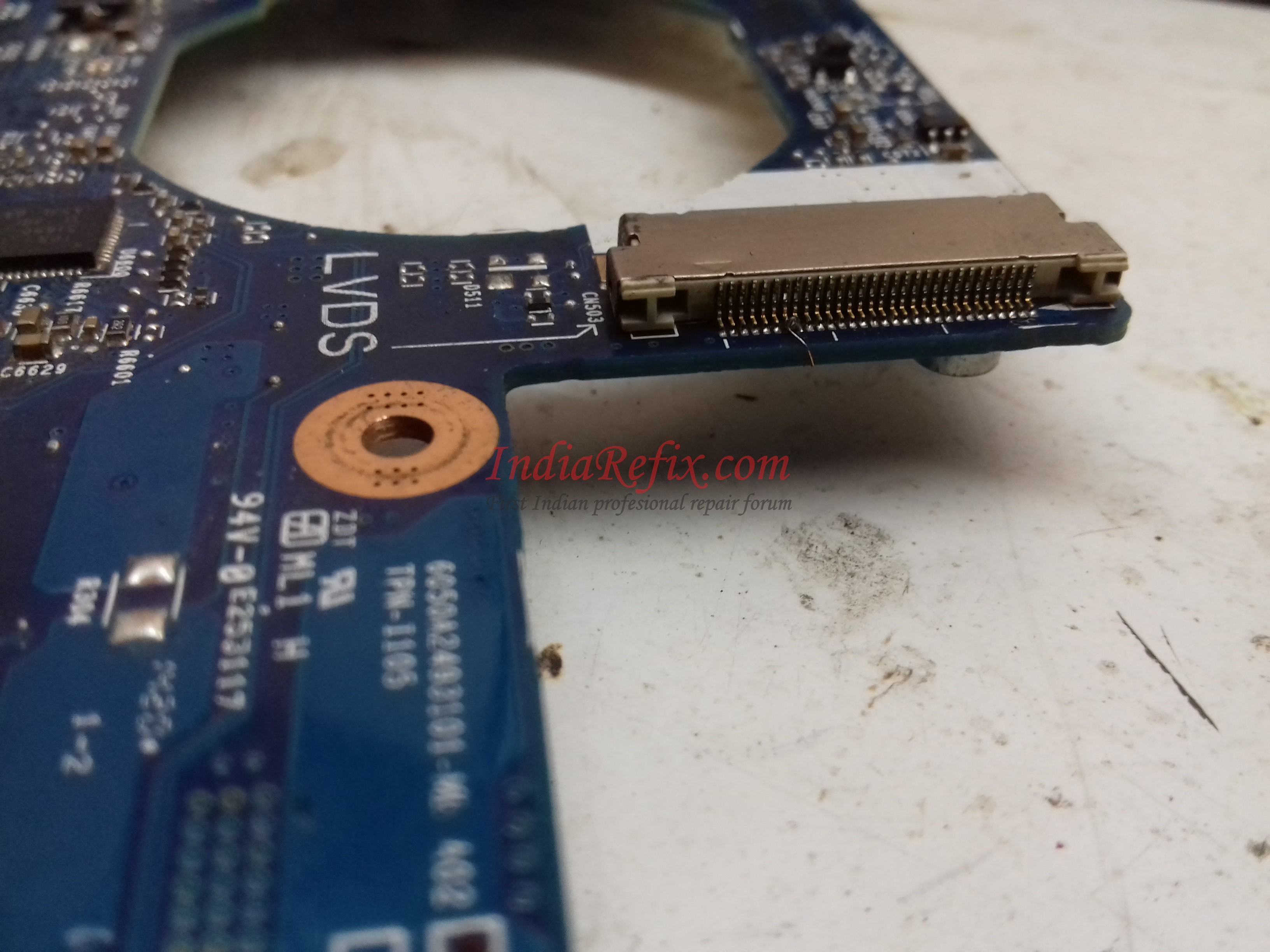

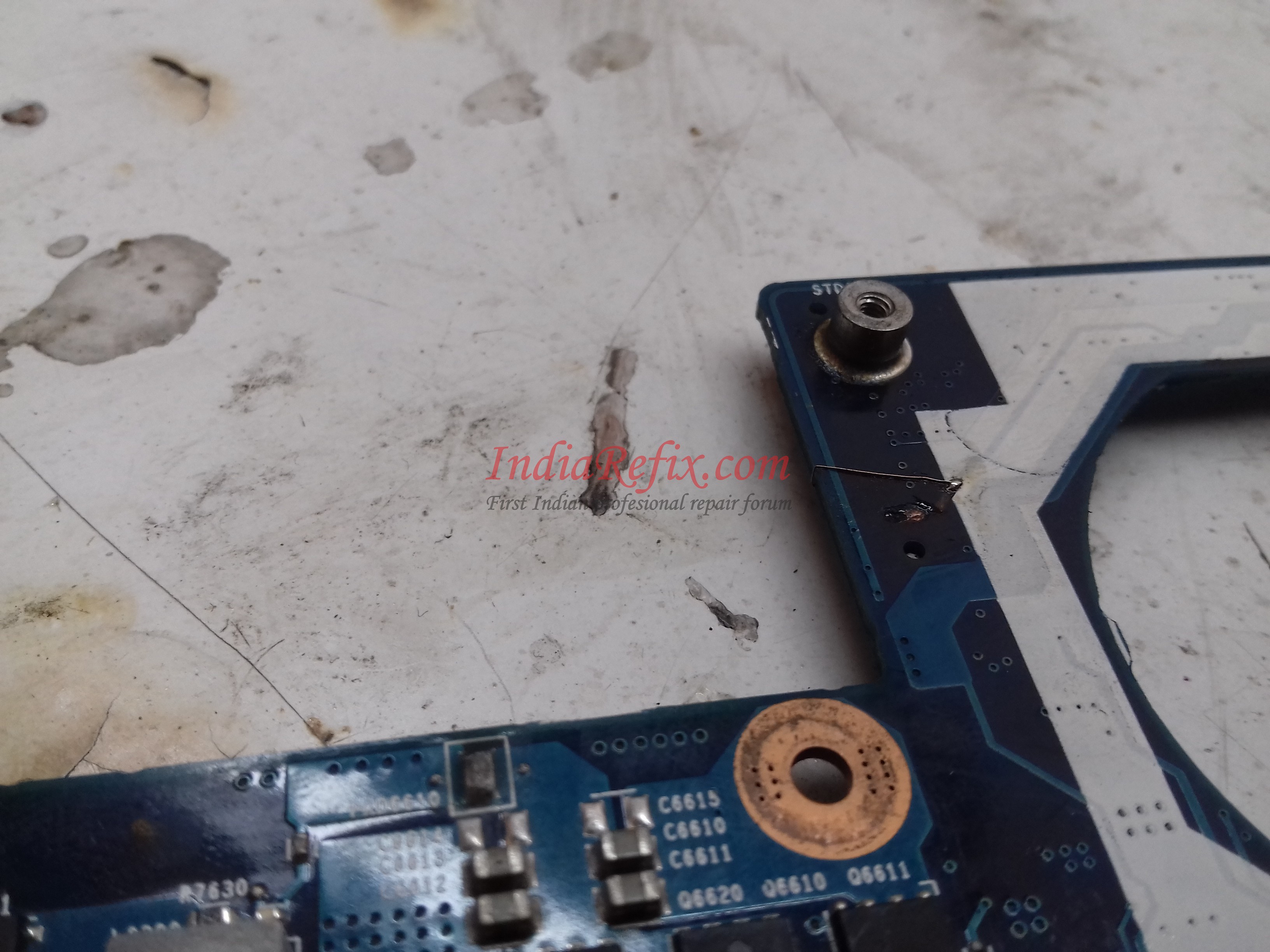

HP 246 DULL DISPLAY...CABLE AND DISPLAY CHANGED....FINALLY CHECK THE VOLTAGE IN LVD CONNECTOR...19V MISSING IN PIN NO.23,24...AFTER REMOVING HEAT SINK THAT TRACK WAS BURNED...FINALLY MAKE A JUMBER....LAPTOP WORKING FINE....
