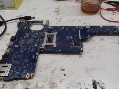

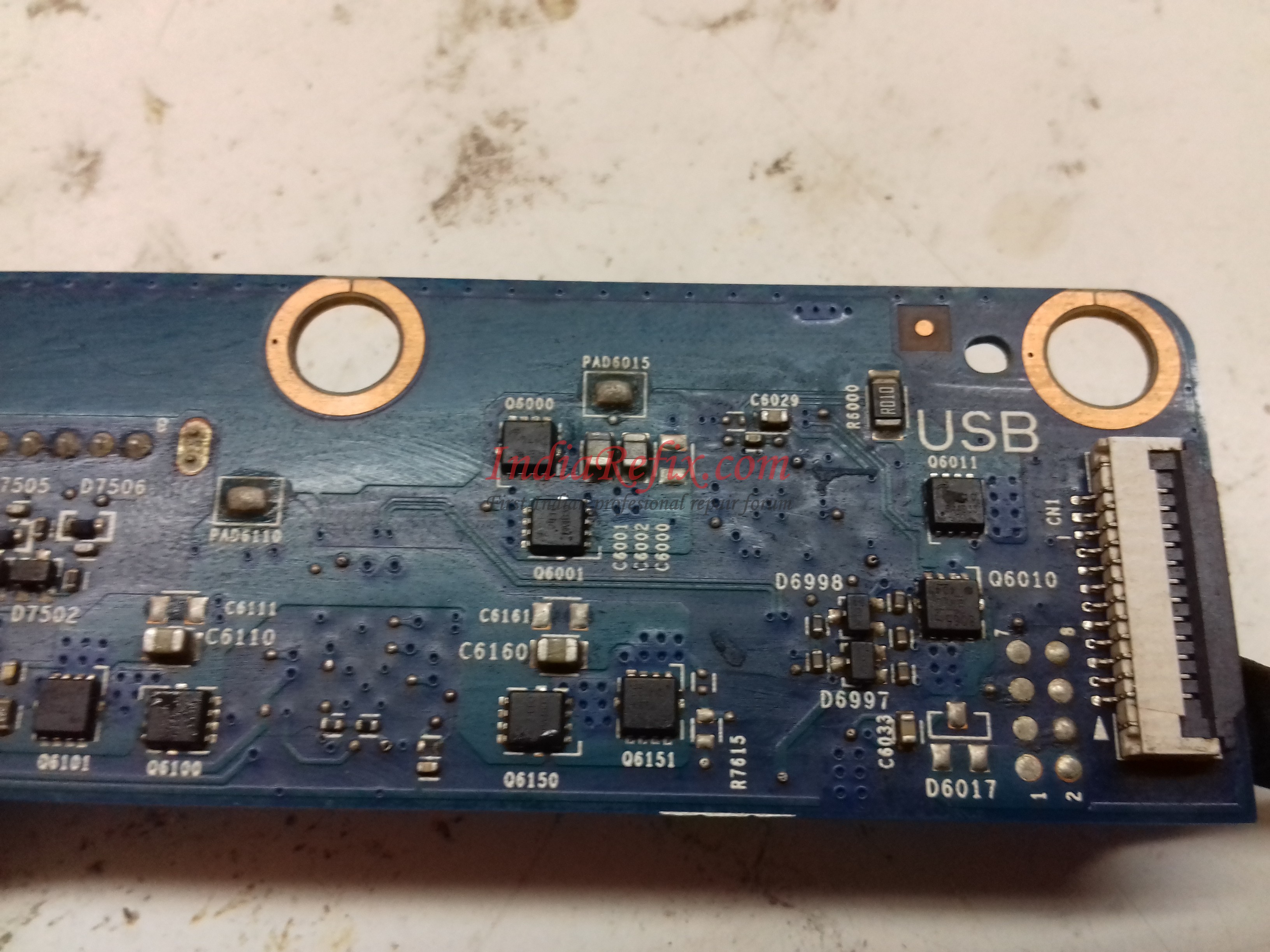

HP 246 BATTERY NOT CHARGING....AFTER REPLACE Q6010 NEAR USB STRIP CONNECTOR...BATTERY CHARGING INDICATION OK...
