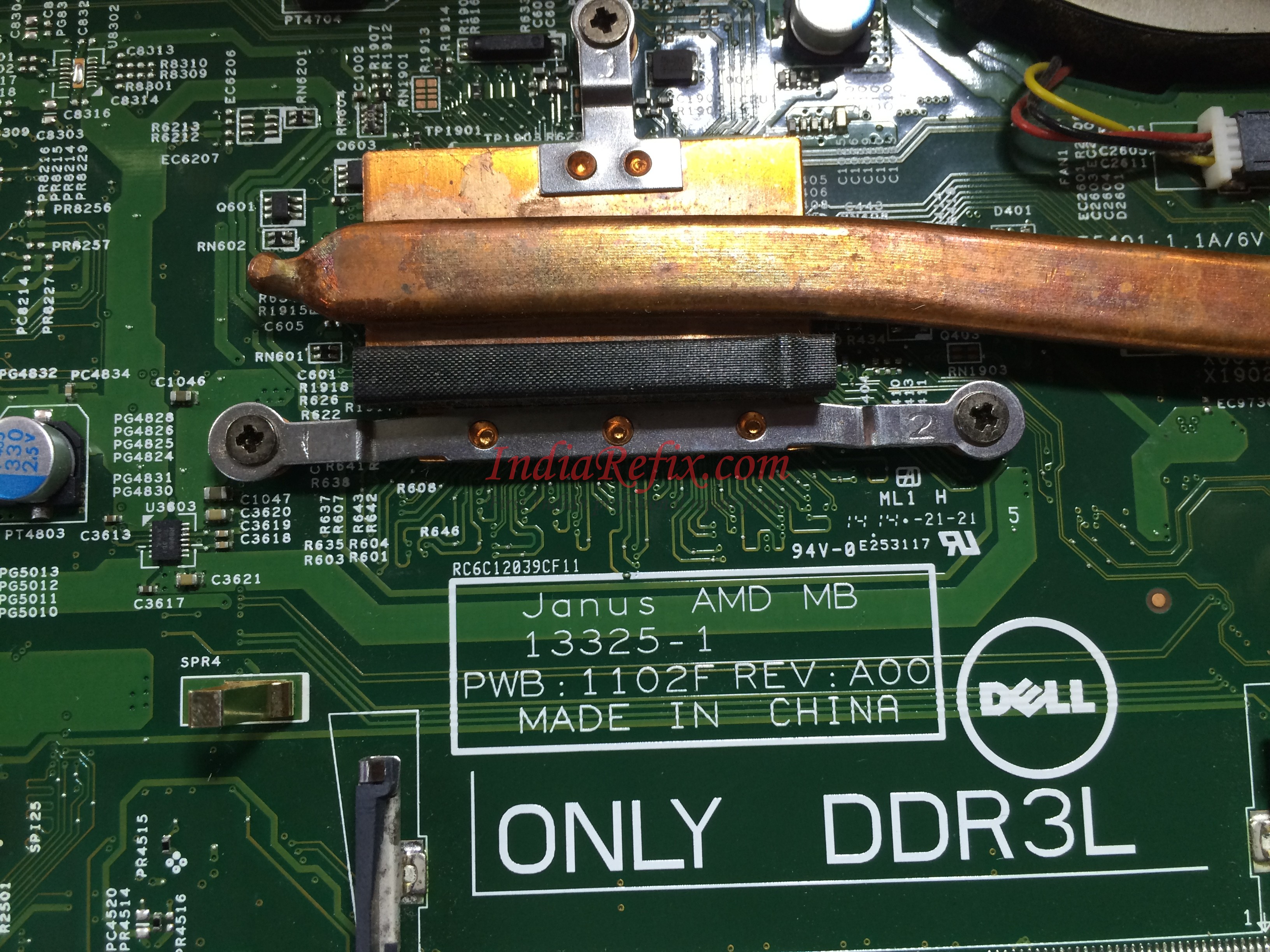

MODEL - DELL VOSTRO 3440
JANUS AMD MB 13325-1 ( PWB 1102F REV A00

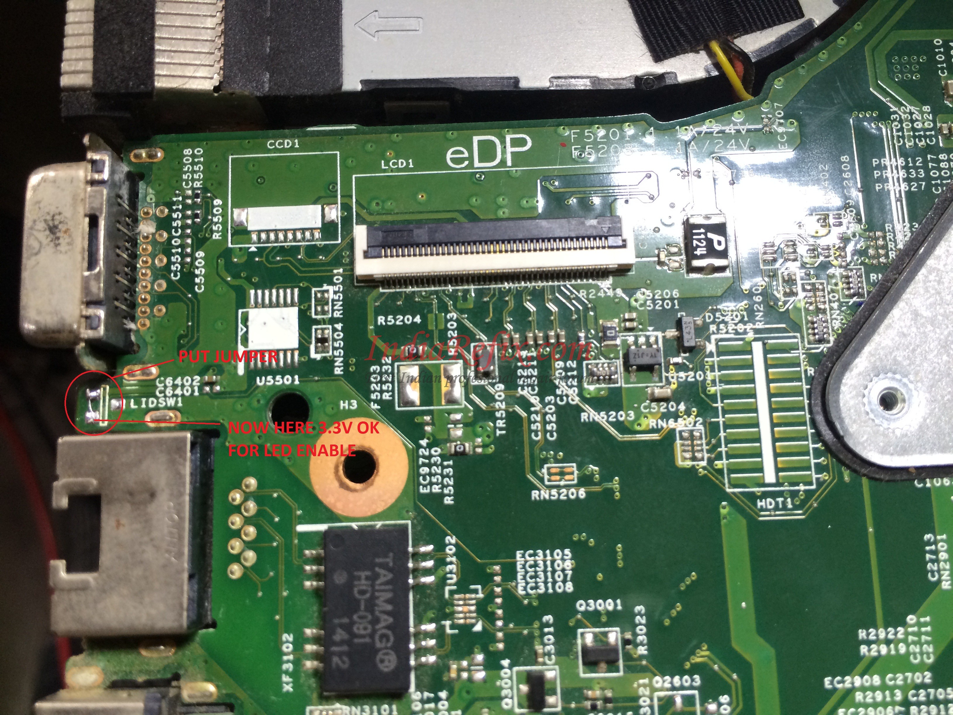

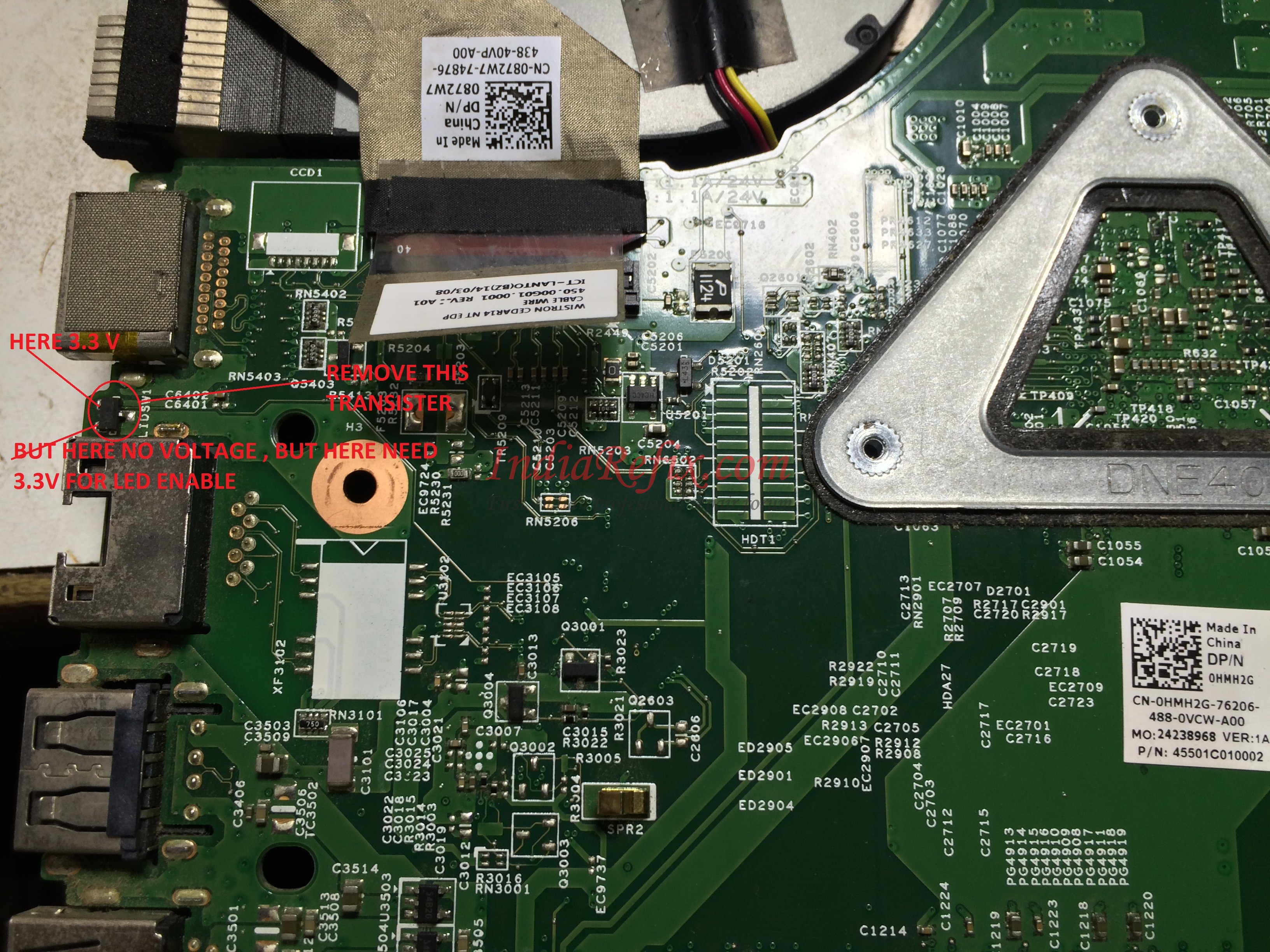

AFTER ALL CHECKED THE LID SWITCH TRANSITOR GET FAULTY.. BECUSE LED ENABLE VOLTAGE MISSING AFTER 5 SEC WHEN POWER ON LAPTOP
LID SWITCH IS HAVE THE FUCTION FOR LED ENABLE VOLATGE
RESOULATION-
REMOVE THIS LID SWITCH TRANSITER AND PUT A JUMPER
NOW DISPLAY OK
REMOVE AND PUT A JUMPER HERE NOW 3.3V OK IN BOTH LEG
THIS TRANSISTER IS LID SWITCH ( FOR LED ENABLE)
BOARD JANUS AMD
BOARD JANUS AMD
