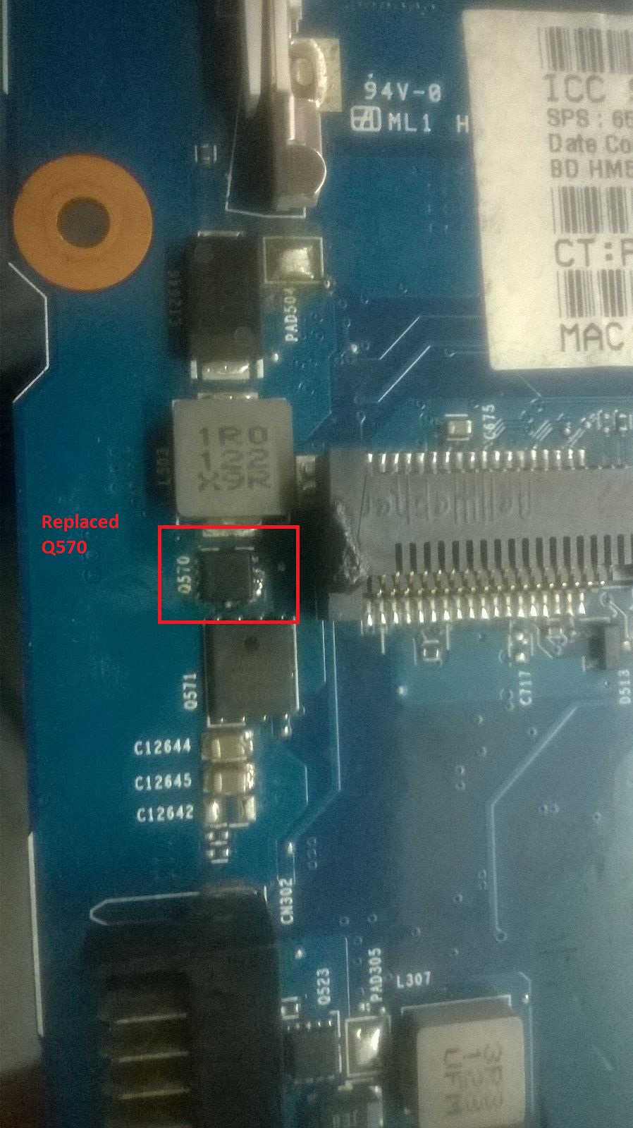

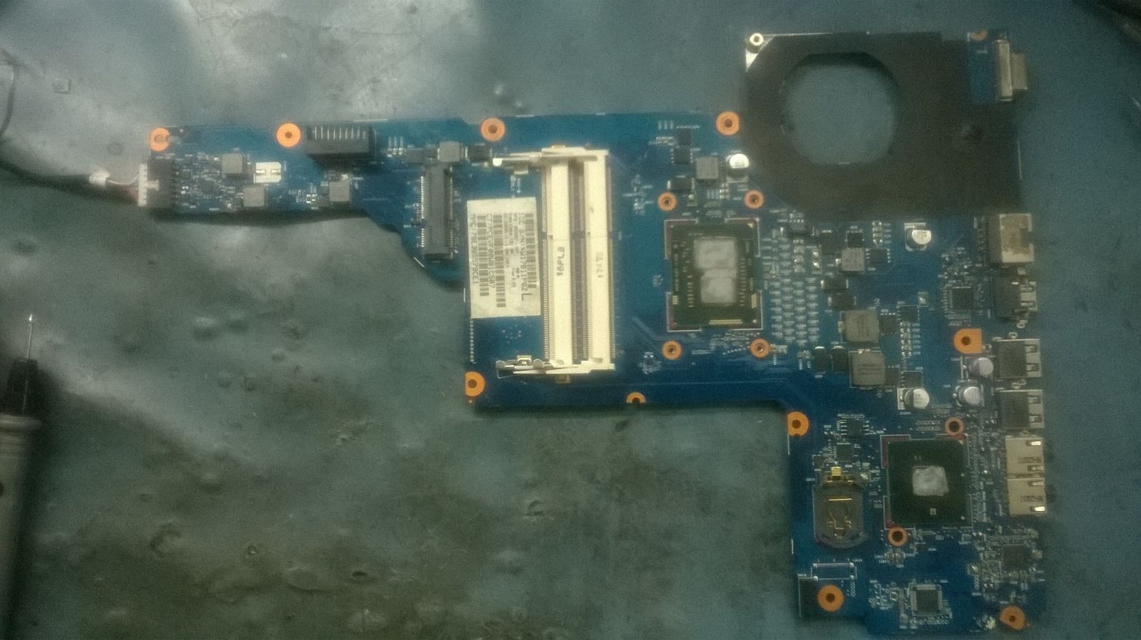

Hp G6 laptop
No power 19v Drop to 4.3V
Found Q570 Faulty ...Replaced ....
Job done
