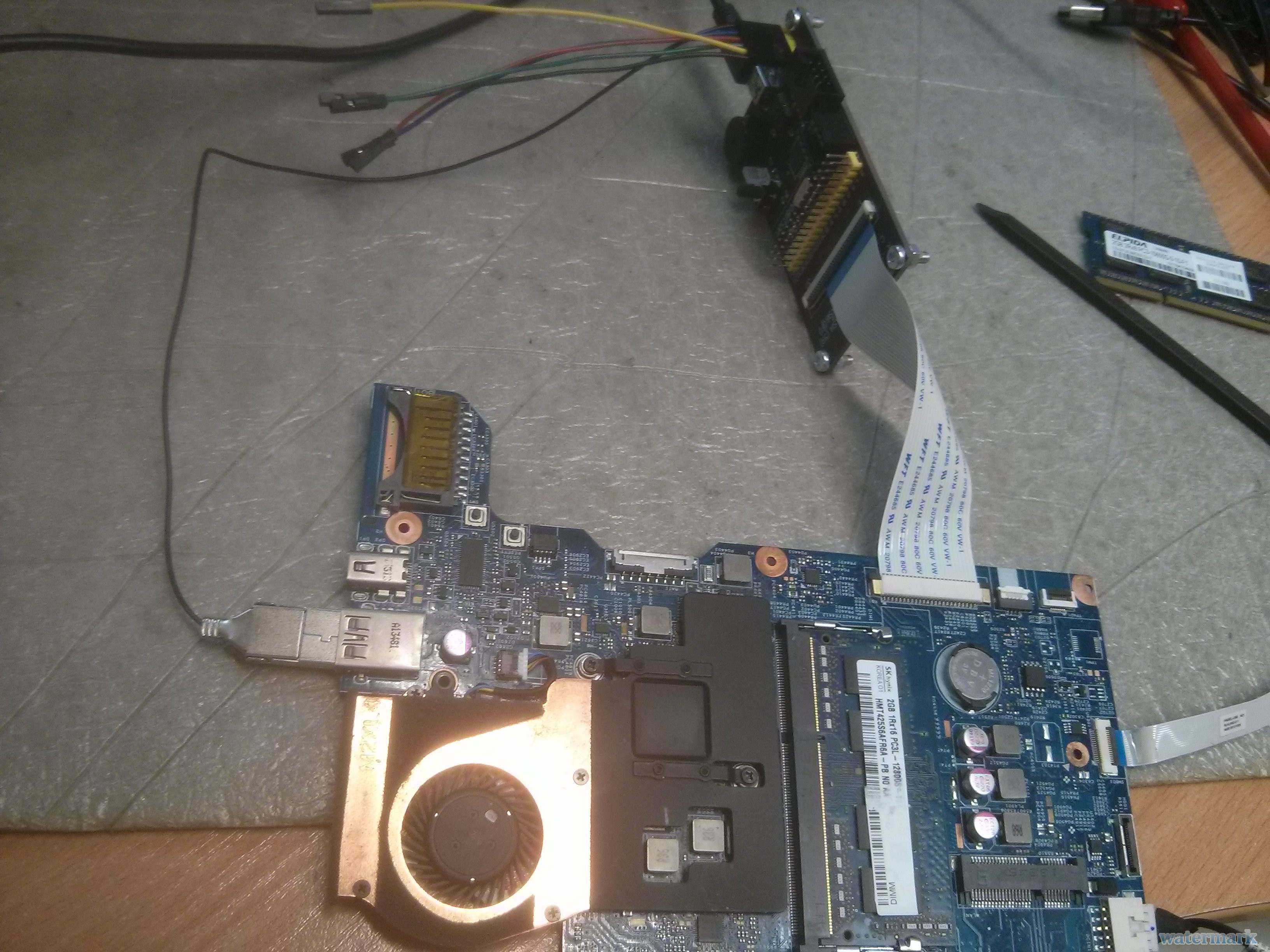

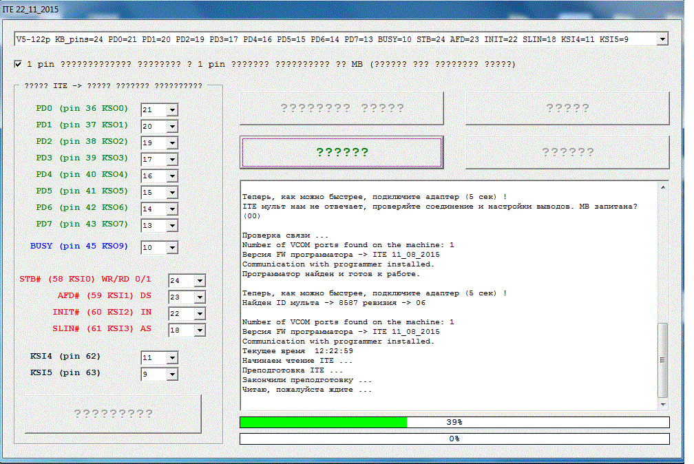

Flashing ITE8587 with sp tool

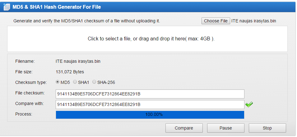

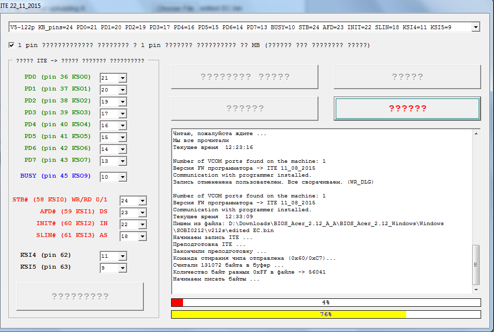

SIR WHICH SPECIAL TOOL YOU HAVE USED? PLEASE GIVE DETAILS......

Svod programmer
