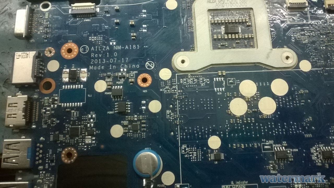

Case Study
Make/Model- Lenovo Z510
Motherboard Part No- NM-A181
Processor Type- On board CPU
Ram Type – DDR III
Problem – Power on No display
Diagnosis-- Bios Problem
Process-
The laptop power up and PSu atake up to .40 amps ,,,,Found all voltages ok ….So reprogrammed bios
And job done ..
