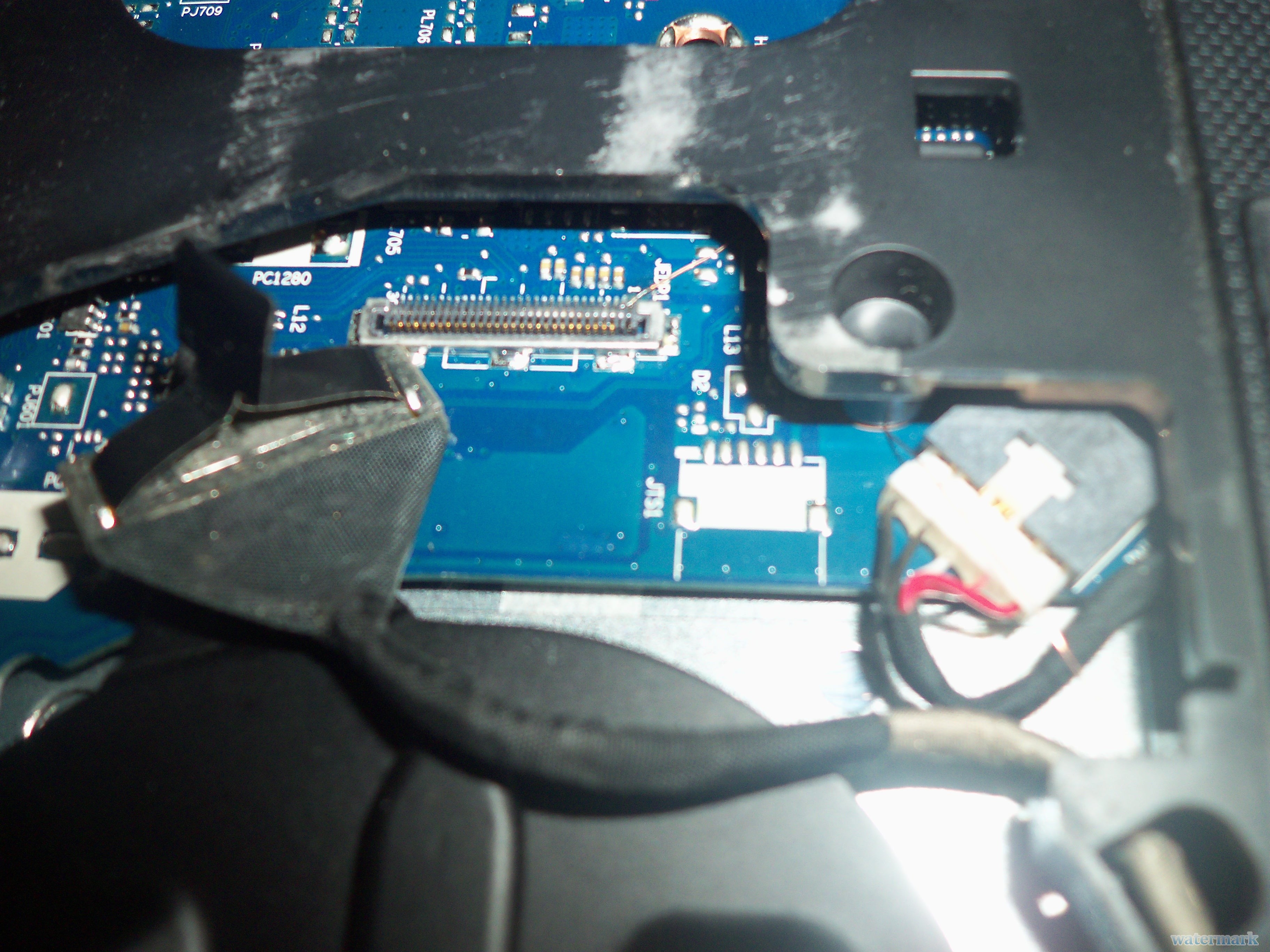

Prob: Deem Display (paper led)

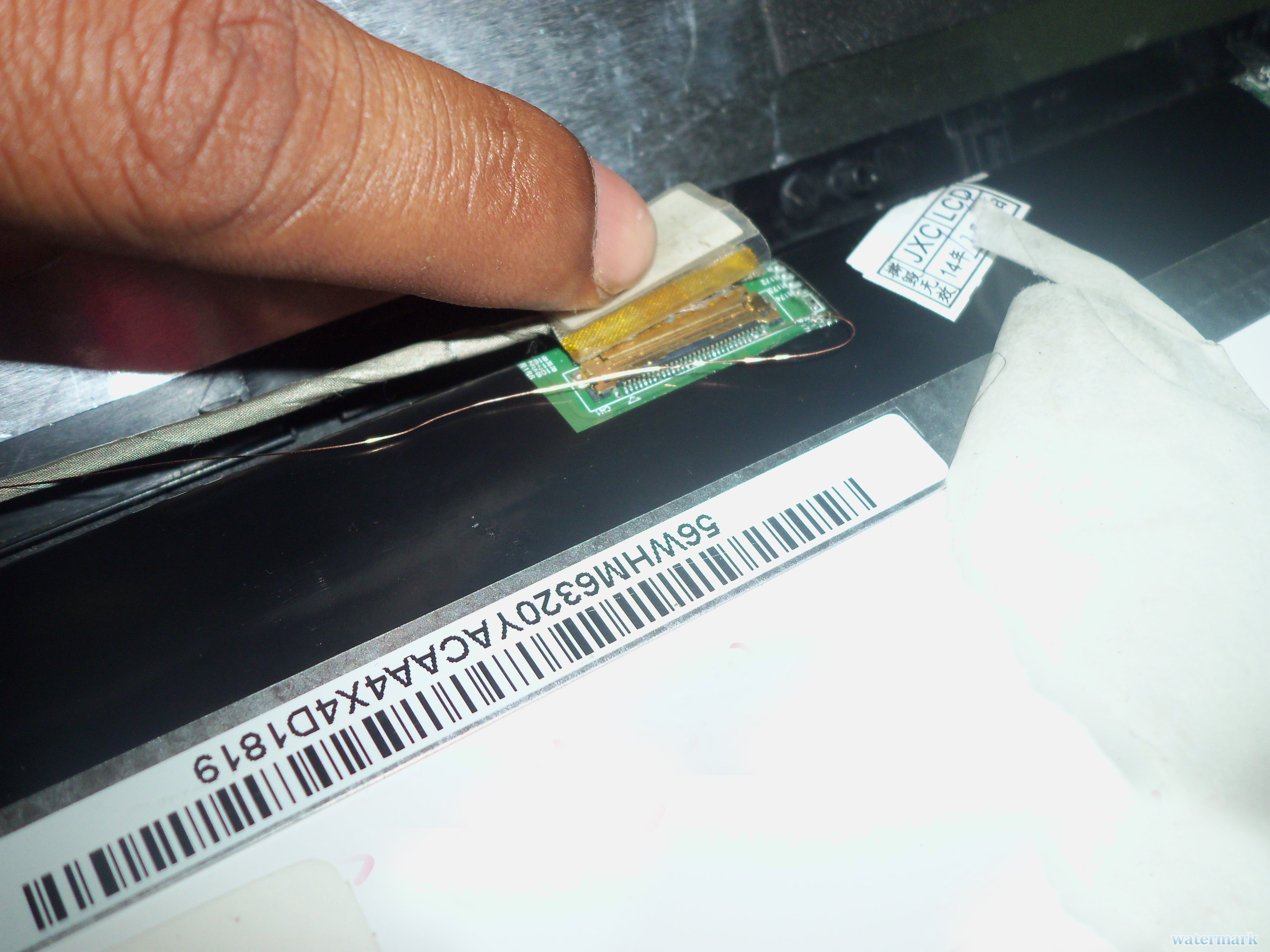

Diag: 1st change display but same, 2nd check voltage on back side of display. All ok But pin no 38, 39 and 40 has not showing any voltage.
3rd check the cable, yes there is problem on display side connector.
Sol: then jumper it and problem solv
