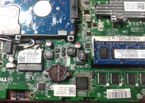

today i m sharing dell latitude 2100 [quanta zm1]
actually when switched on laptop its getting pulse and within second its off......

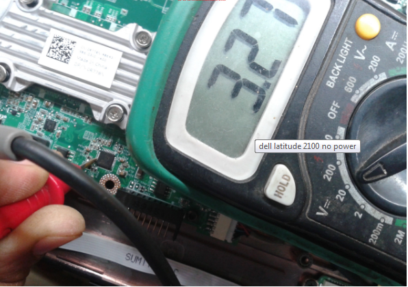

on pu1 [max 17020]
vin pin =17v ,, ldo= 0v, vcc and vdd =0v,, ref =0v,, but +3.3V_RTC_LDO = 3.3v

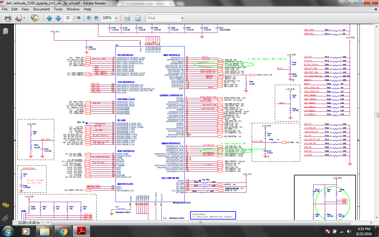

THEN on i/o chip
> ALWON its 0v but when switched on its 3.3v andwithin second its 0v
> SIO_PWRBTN# its 0v but whenswitched on its 3.3v and within second its 0v
> ICH_RSMRST# its 0v but when switched on its 3.3v andwithin second its 0v
> SIO_SLP_S3# its 0v but when switched on its 3.3v andwithin second its 0v
> SIO_SLP_S5# its 0v but when switched on its 3.3v andwithin second its 0v
> SUS_ON its 0v but when switched on its 3.3v andwithin second its 0v
> SUSPWROK its 0v but when switched on its 3.3v andwithin second its 0v
> ALW_PWRGD_3V_5V its 0v but whenswitched on its 3.3v and within second its 0v
> 1.05V_VCCP_PWRGD its 0v but when switched on its 3.3v andwithin second its 0v
> RUN ON its 0v but when switched on its 3.3v andwithin second its 0v
Then check all regulator section getting accurate voltages depend on its require..

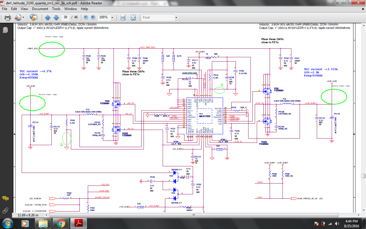

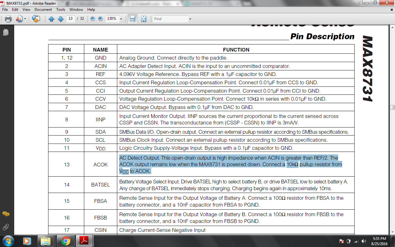

last and finally on i/o chip ACAV_IN = 0v when switched on its also 0v and its coming from charging ic pu3 [max8731a]

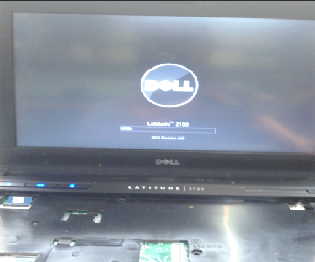

now change pu3 [ max 8731 ] and fix the problem
in this case ACAV_IN is important signal of charging ic to i/o chip but I m missing to check that signal bcoz of laptop getting pulse and off so I don’t think about this signal…
