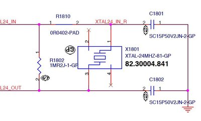

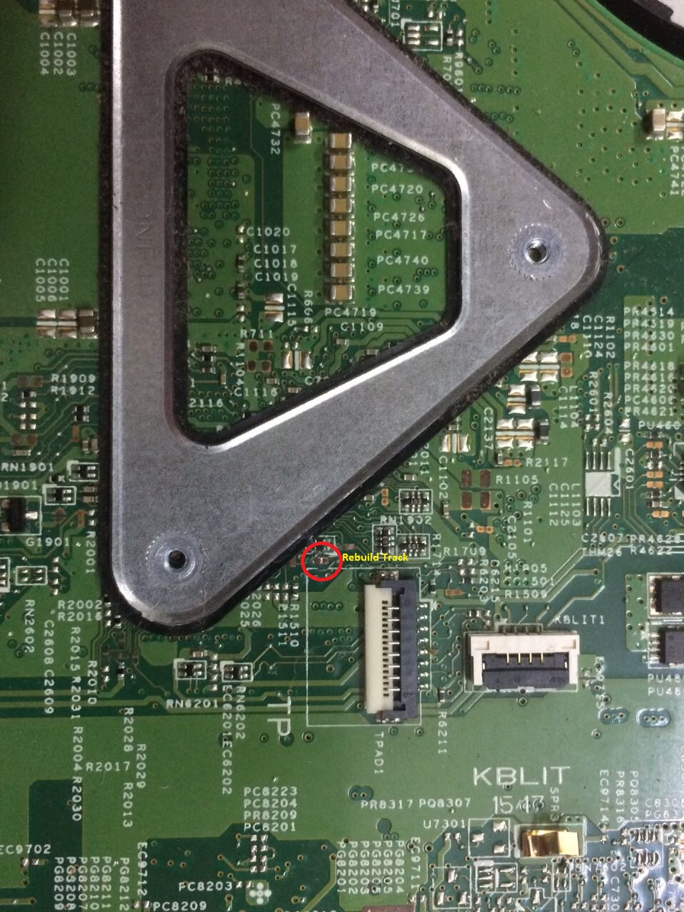

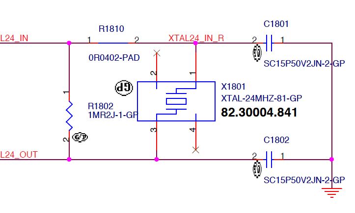

Dell Inspiron 3542 7 Beep sound Solutions
Description: Dell Inspiron 3542 7 Beep sound Solutions
Manufacture: Dell
Model: Inspiron 3542
Motherboard Part No: Cedar_intel_mb
Problem: Power on No Display And 7 Time Sound Beep
Diagnosis: Found Processor Section Damaged
Process:
Received Dell Inspiron 15-3000 Laptop Model Is inspiron 3542 And Motherboard Part No is Cedar_intel_mb Laptop On And No Display and 7 time Beep sound coming After Observe motherboard Found Rusted and Damaged Processor Back Side Near R1810 After Reading Schematics Found Hasswell to crystal X1801 (XTAL-24MHZ-81-GP 82.30004.841 ) Line Damaged After Rebuild Track Problem Solved And System Ready .
