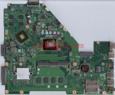

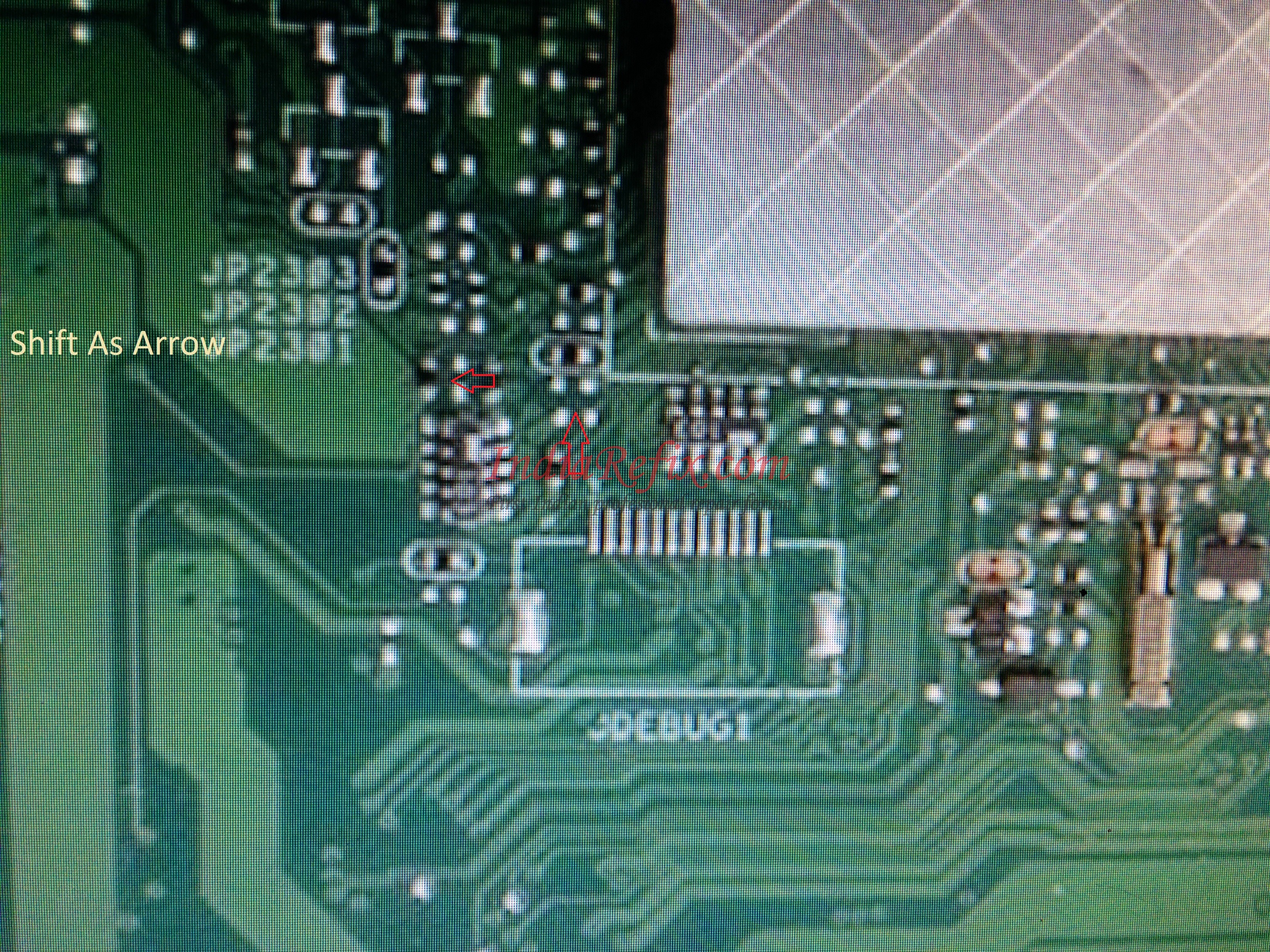

Useful when ram chip short or heats in such case remove on board ram chip and enable Ram slot..
If On board ram chip are dry and lines appear on screen then this Job can be done with Bios Change may searched on WEB
Asus X550CC OnBoard Ram Disable

Who did it test it?

if i remove onboard ram than ram slot will be enabled automaticaly?

Testing???
