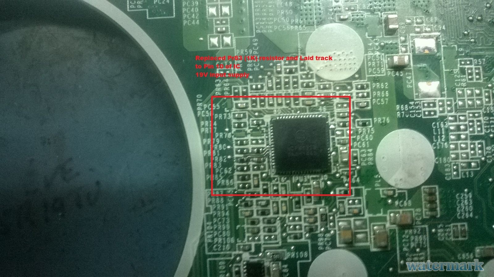

Laptop : HP15
Model Quanta U81
Problem power on No display
Diagnosis : V core supply
Hp15 with no diaplay ....seen coorosion at Vcore ..and track missing laid the trach and change the supply resistor(1k)
Job done
here is the pic

ohoo one same resistor was the cause of no vcore
