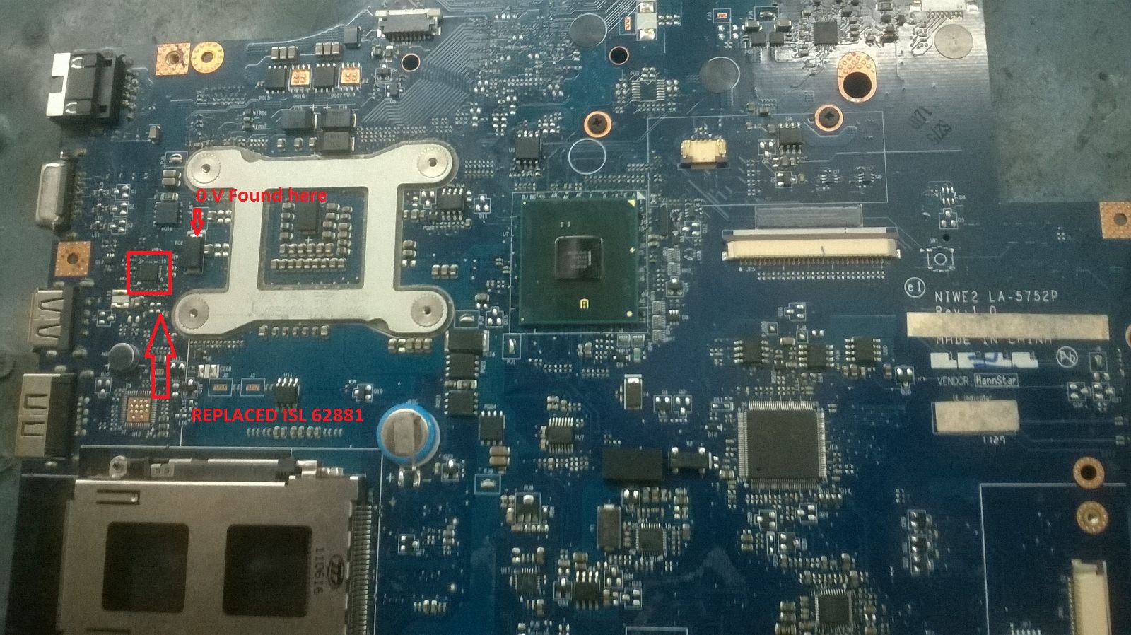

G560
Motherboard Turns off in 10 second as soon as powered on ..
no display condition ...
Measured Voltage at PC67 Found it 0 V
hence Replaced ISL62881HRTZ controller ...
System is working fine now
here is the pic
