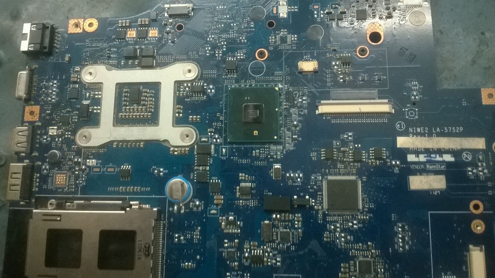

Lenovo g560 ...case study (LA-5752p)

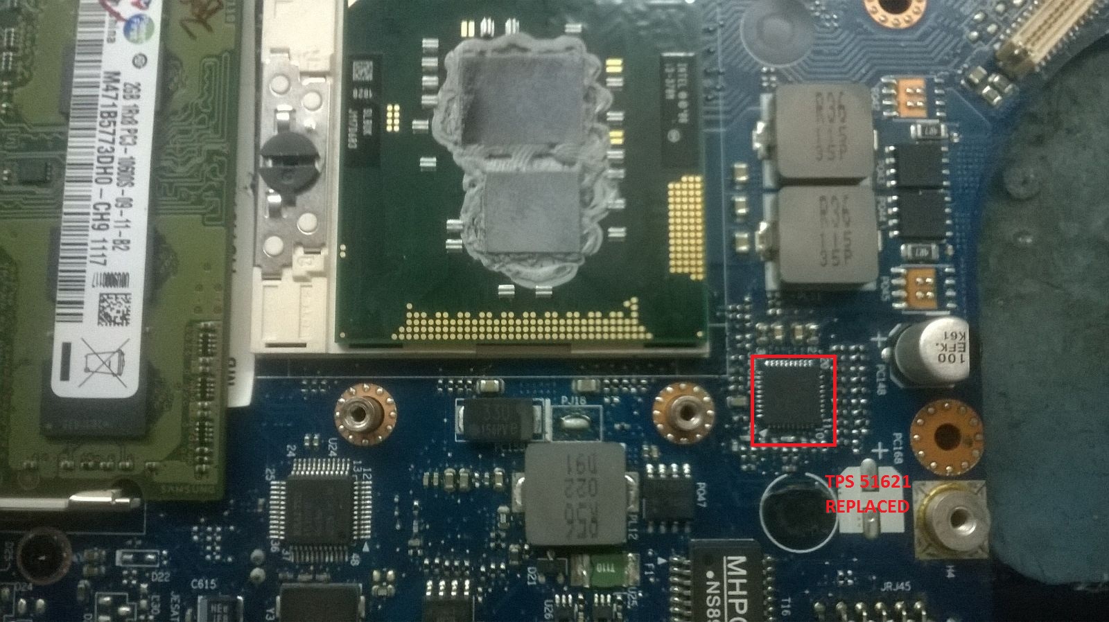

LAptop arrived with power on/no display condition and power trip in 4 seconds ...
Found Core IC tampered Bios Ic replaced..
Replaced TPS51621 and MX25l3205 ..
LAptop working Fine ...
here are the pics
