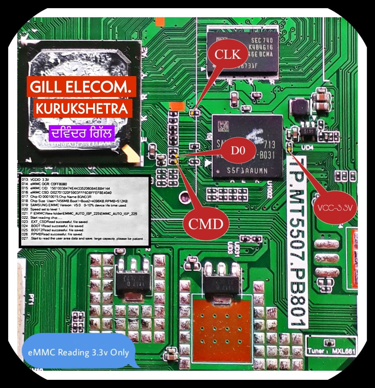

TP.MT5507.PB801
Emmc Pinout
TP.MT5507.PB801 Emmc Pinout
