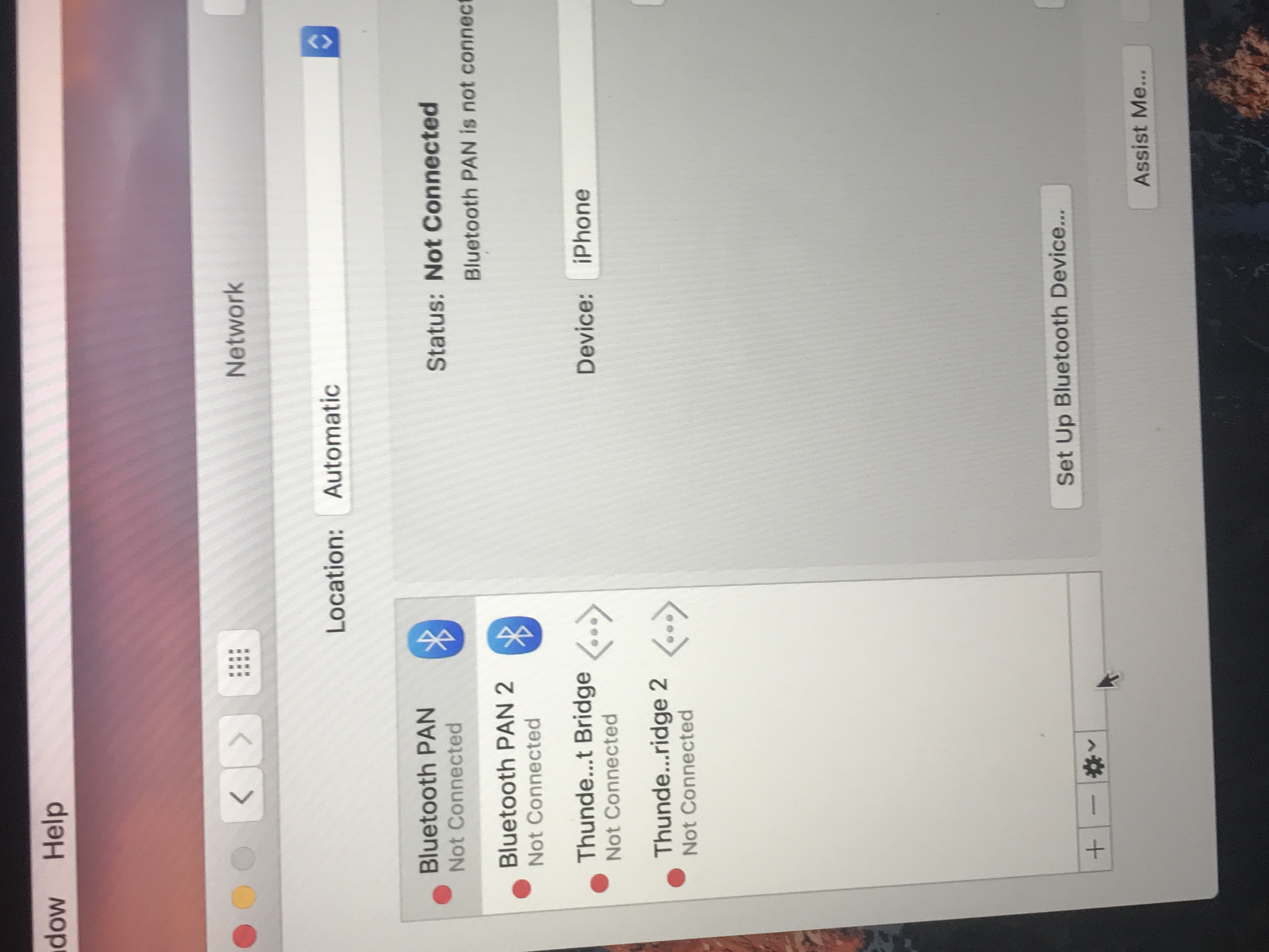

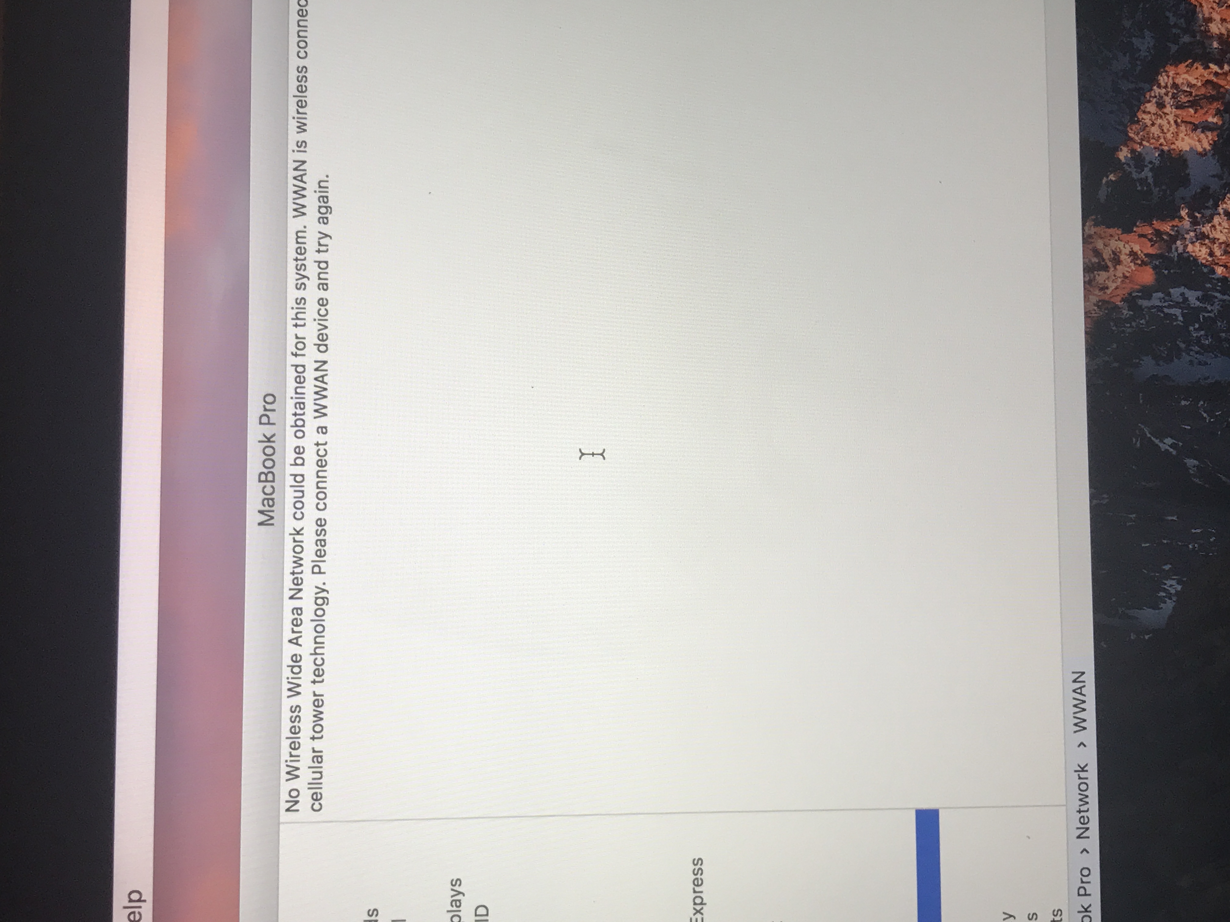

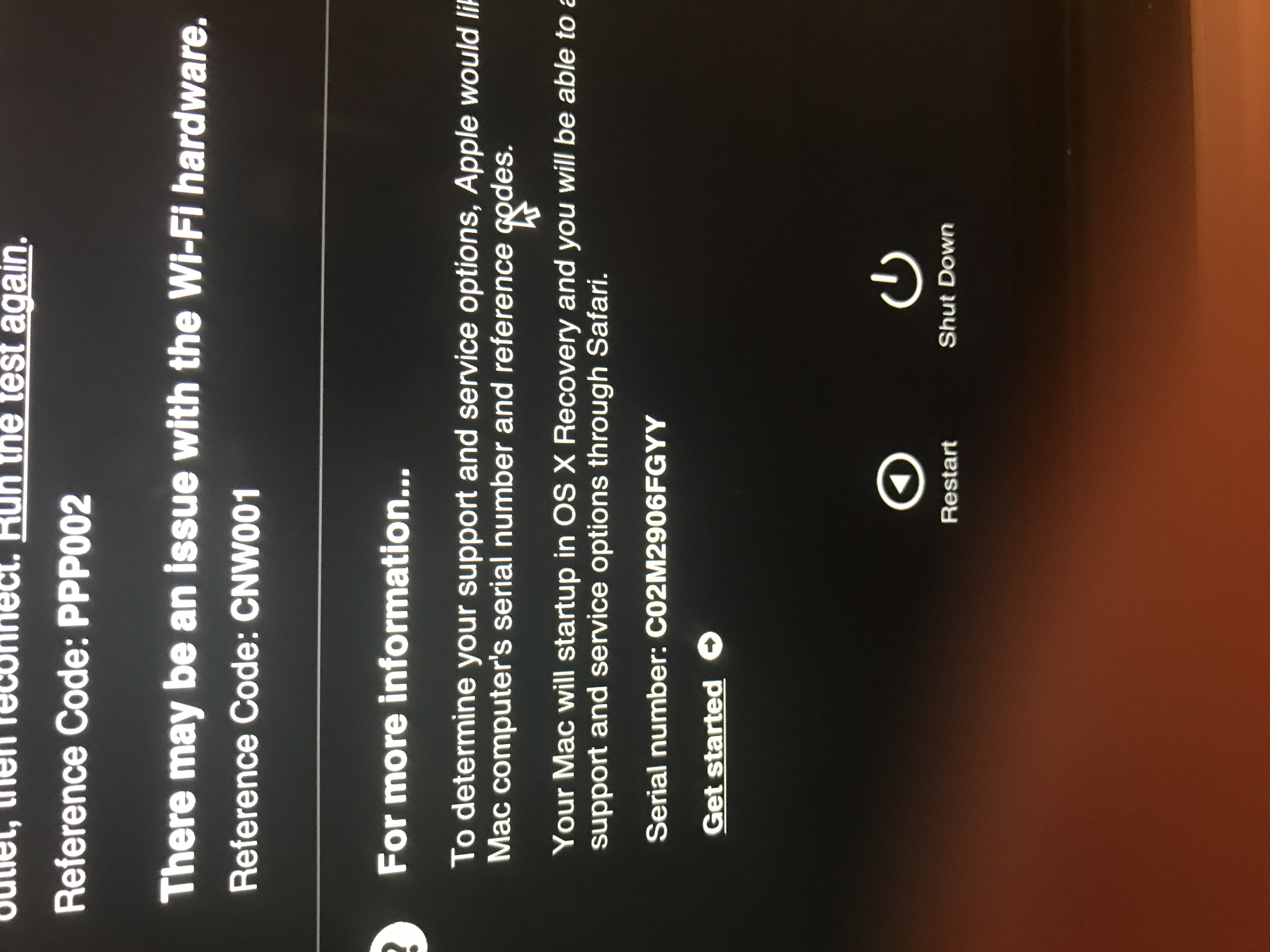

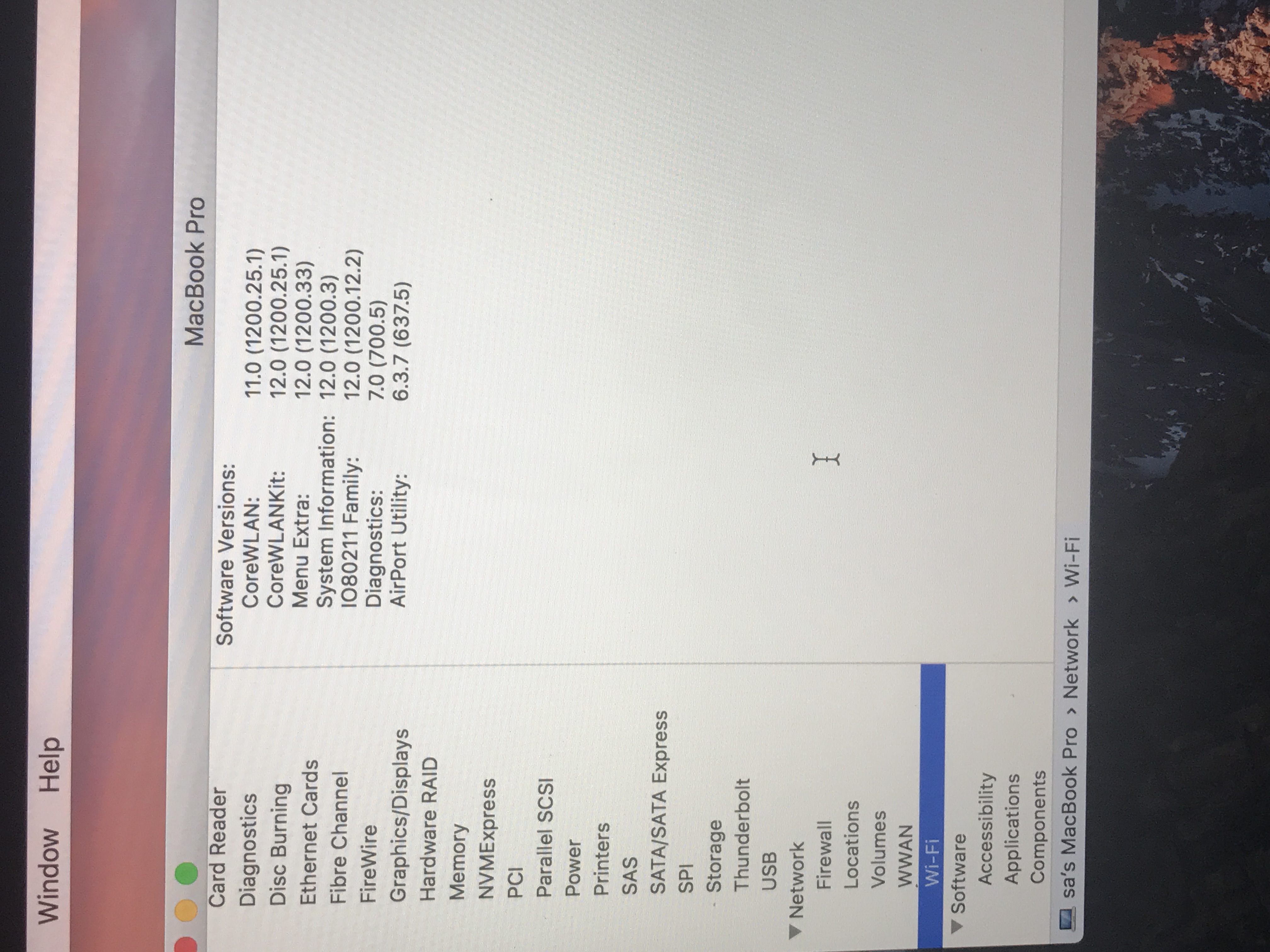

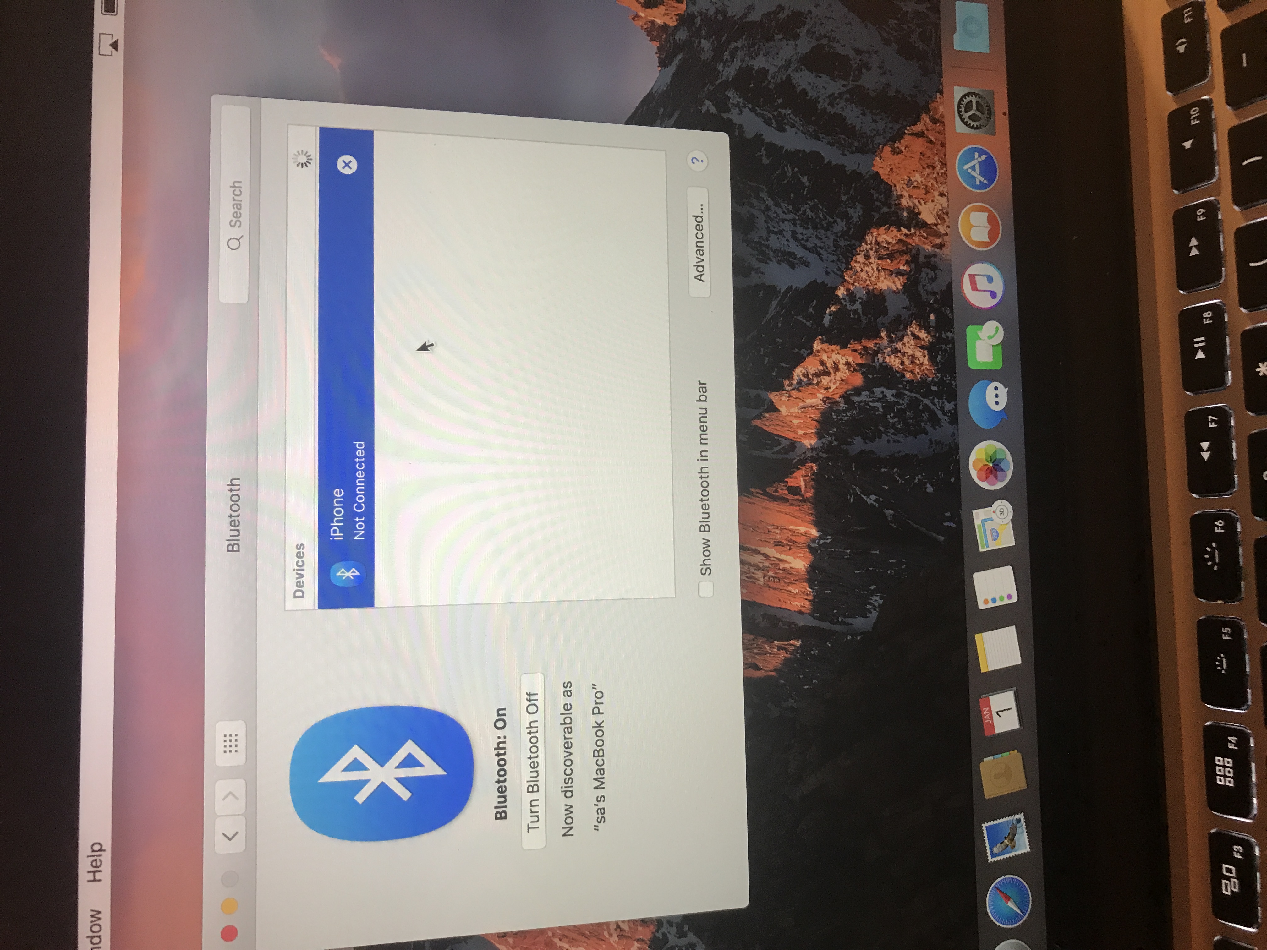

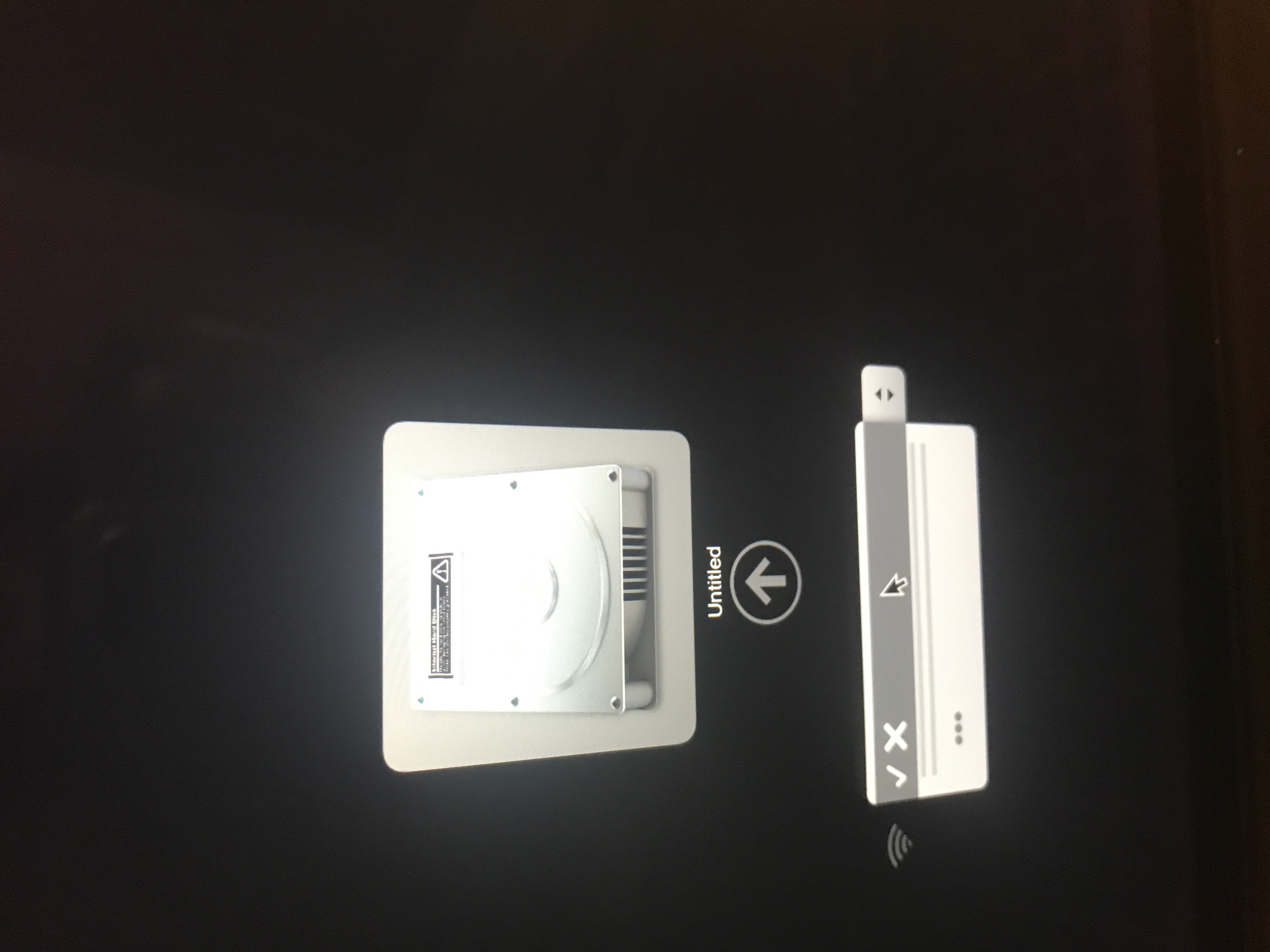

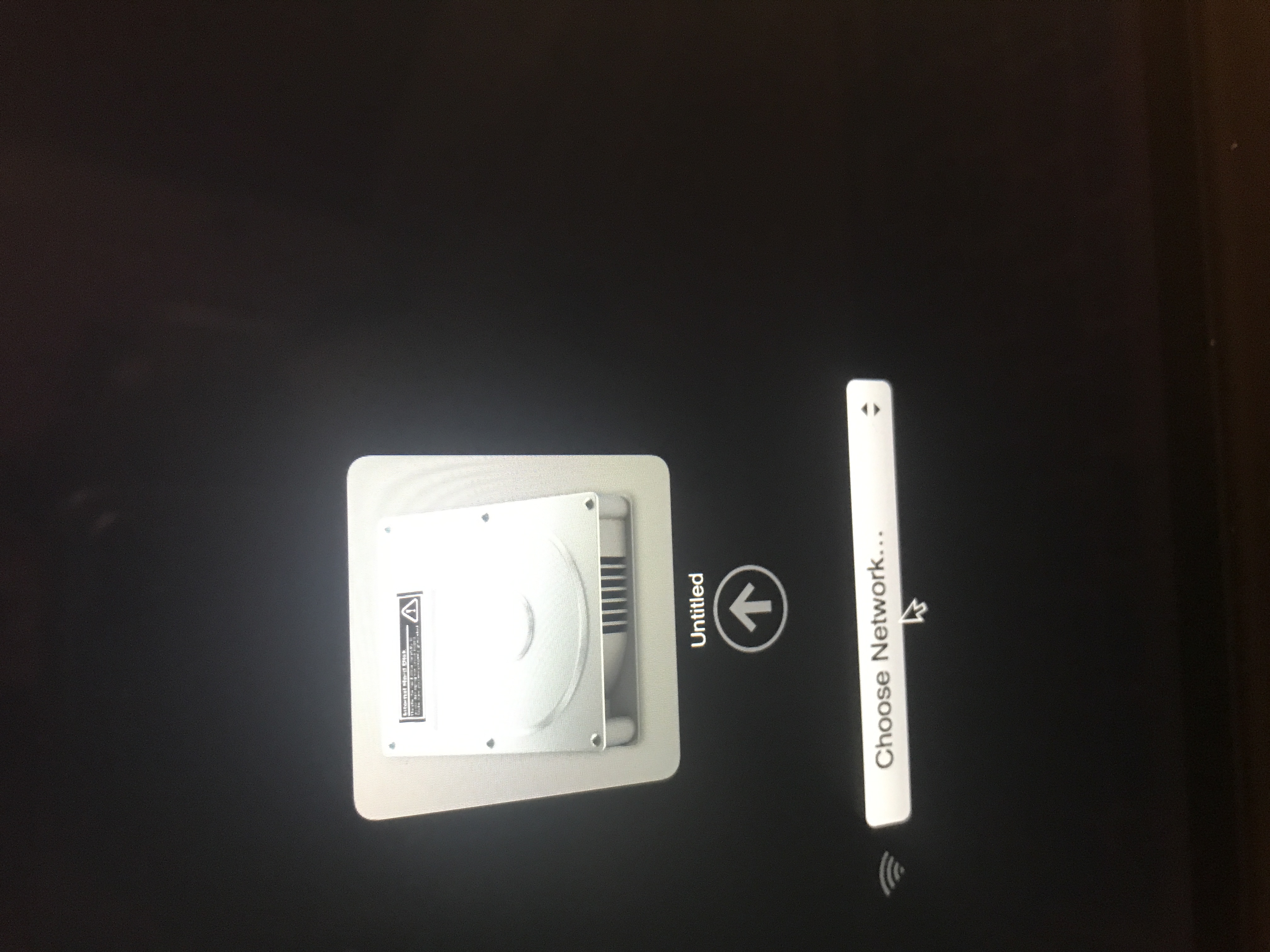

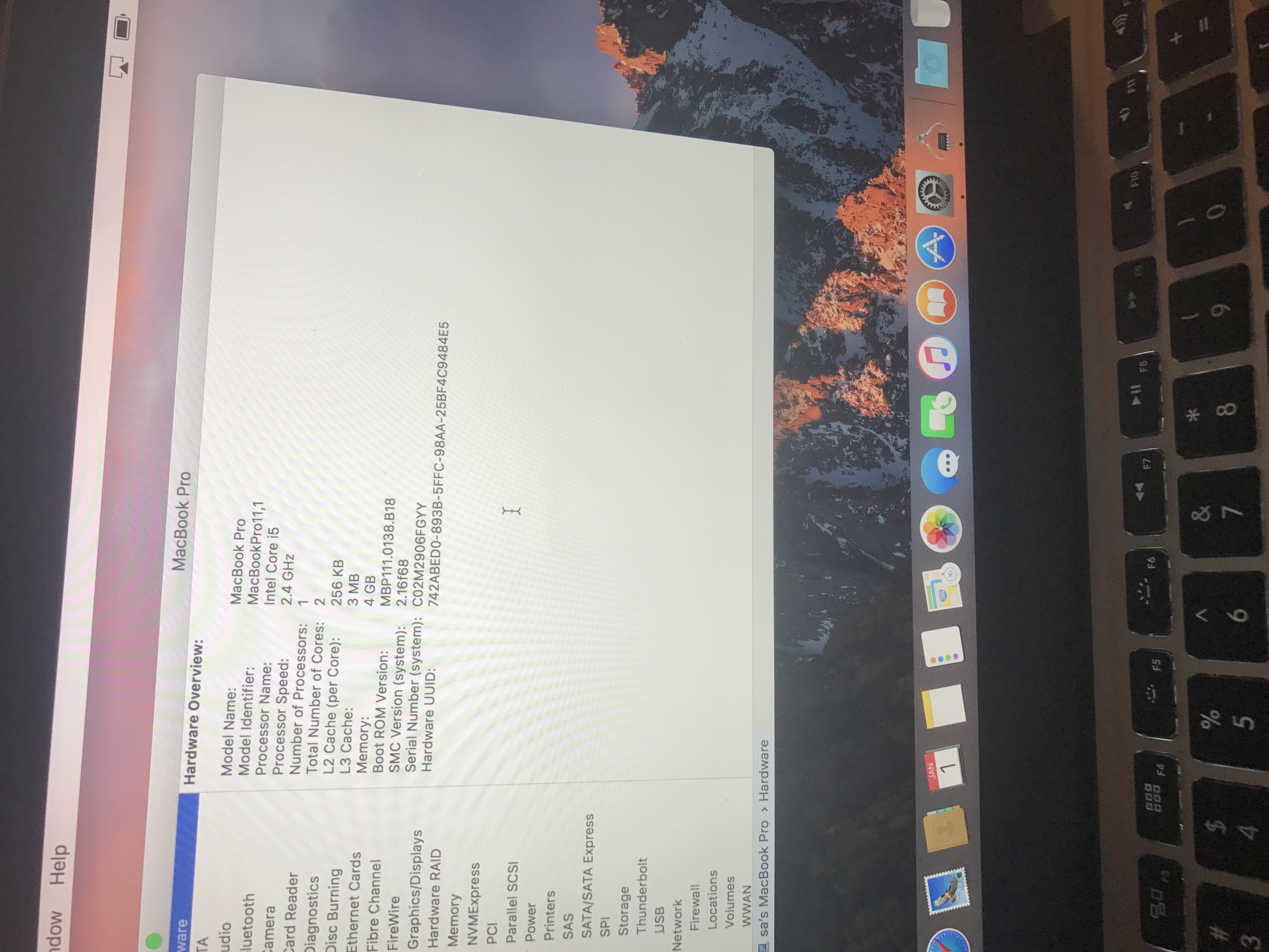

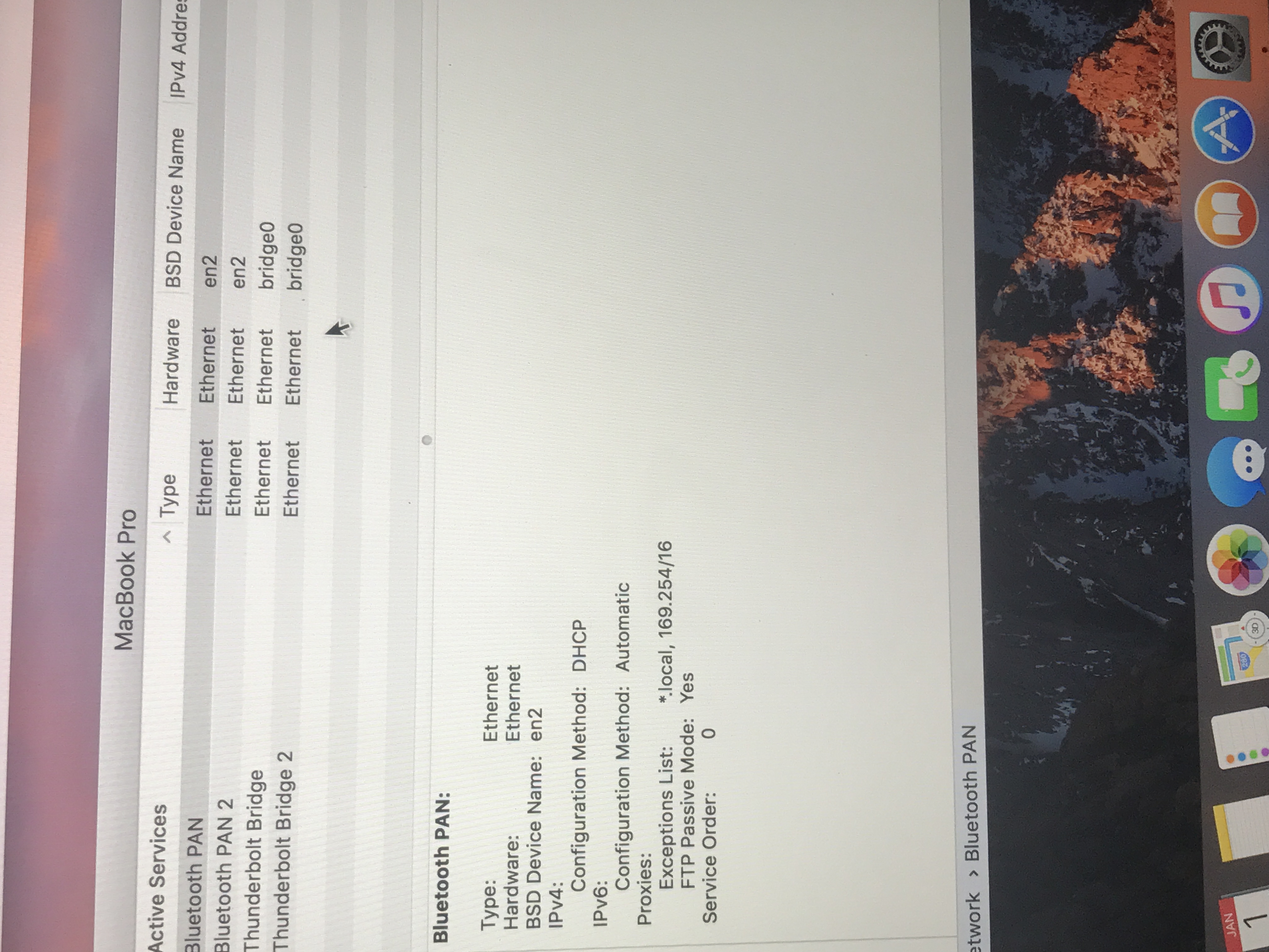

MacBook Pro a1502 retina late 2013 13"
Wifi not work.
Change 3 wifi card and rio board flex, clean OS X Install and tried pram nvram reset still same, can any body help me please, no wifi every thing work, and Bluetooth tried to paired but disconnected the phone imediatly but when search for Bluetooth device is find my iPhone. To my expert any help will be greatly appreciated. Thank you
